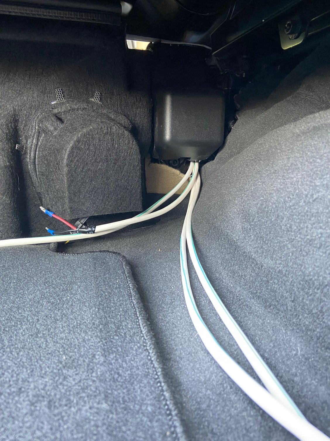

I also installed two (2) Kicker 8” bass tubes because I wanted the best sound in the smallest package. They are tight and sound excellent and I can crank up the radio without them distorting. Therefore, I ran new speaker wire for the rears and subs up the passenger side and passed through to the trunk compartment – underneath the carpet behind the seat and trunk. I screwed the bass tube mounts into the rear compartment covers so I can remove the tubes easily out the mounts to open the compartments.

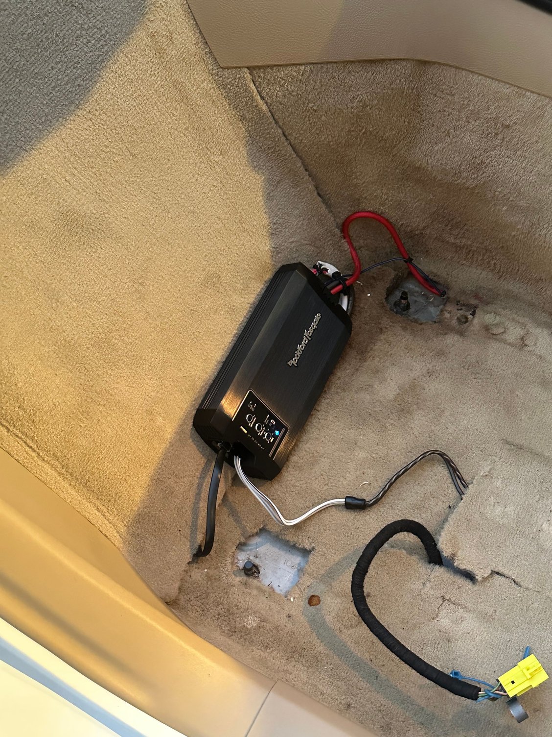

I mounted the mono-amp right behind the passenger seat. I chose this amp because it is very small, super easy to set up, has a subsonic filter, and is 600 Watts into 2 Ohms. I didn’t secure the amp to anything other than to put a small strip of 3M double-sided tape to the carpet.

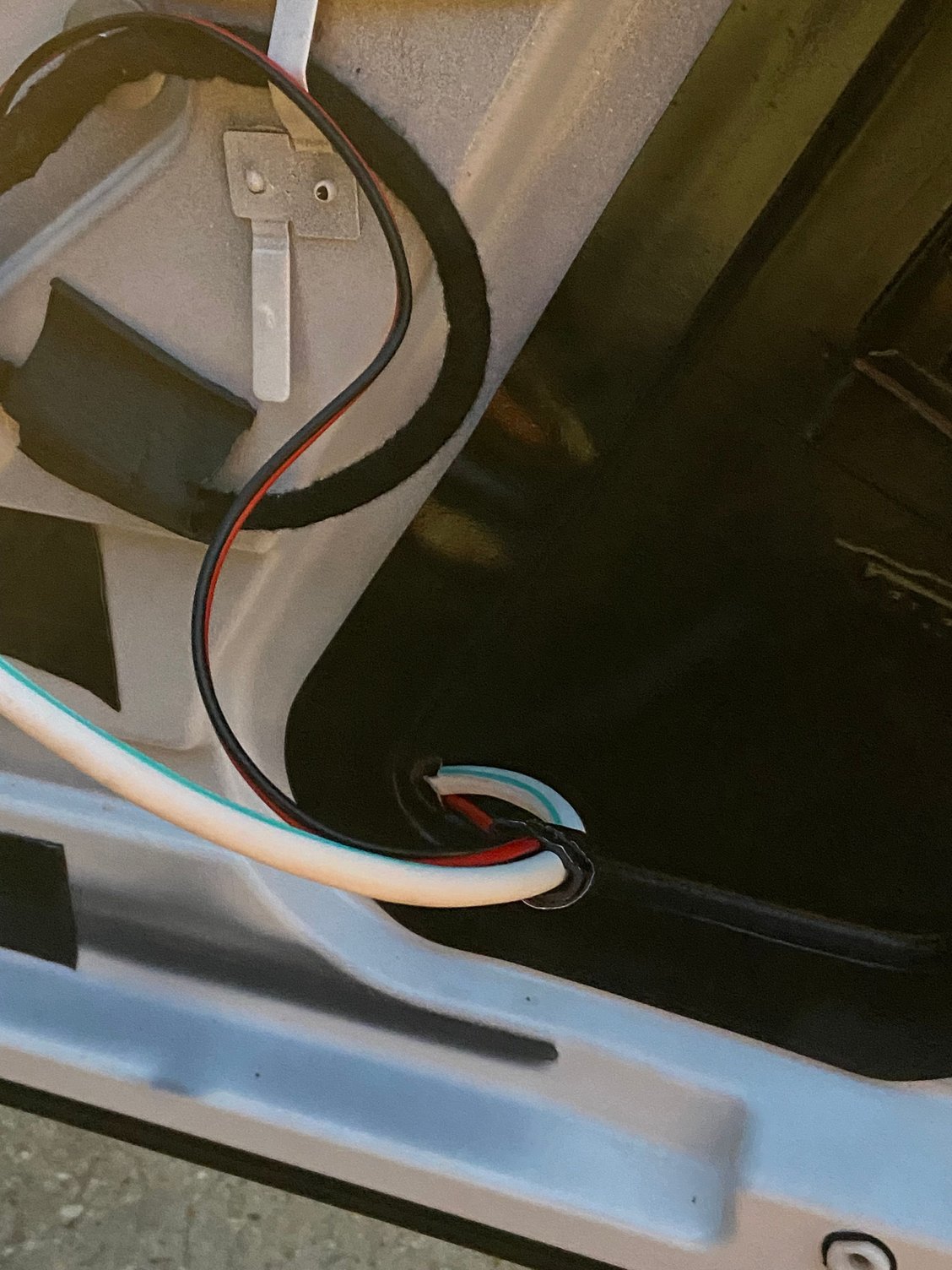

I ran the mid and tweeter speaker wires behind the door and out the large rubber cover. Make sure you have a box of door panel retainers because I had 3 that were broke. I put a few pieces of left over dynamat on the wiring to secure it to the door.
Running the new speaker cable from the door to the amp location was a pain because I could not fish it through the existing route. You need to unseat the rubber conduit between the door and frame on both ends and use your fingers to push the speaker wire through. I went from the interior to the door. I carefully drilled a hole in a plastic cover (right above the hood release latch) that was in line with the rubber door conduit.

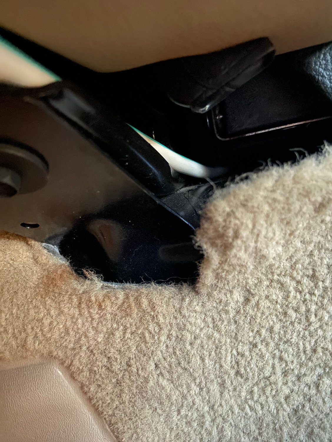

To get from the driver side to the passenger side (where I mounted the 4-ch amp), I ran the cable through a small passage as shown below (see white wire). It is very tight but you can do it when you find it.

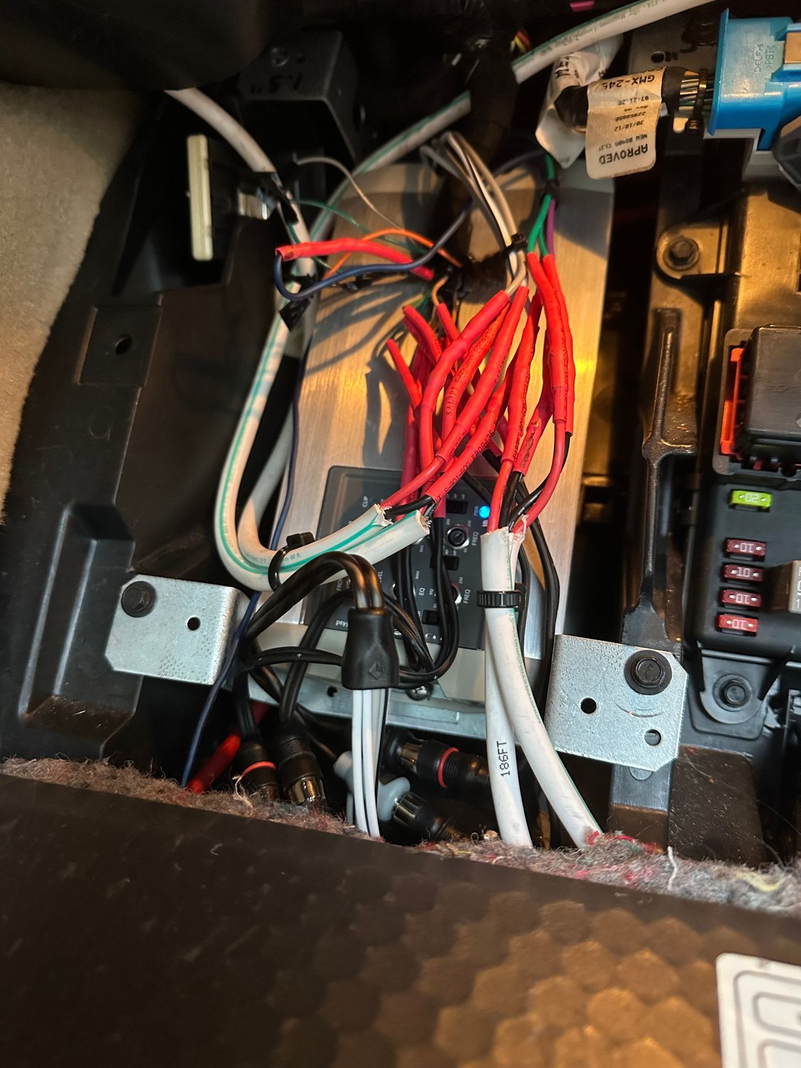

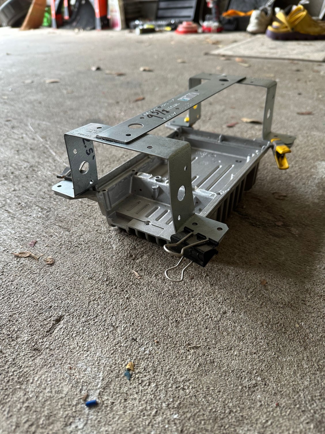

I mounted the 4-channel amp in the location where the Bose amp was. I used 12” metal straps you find at Home Depot and measured them to secure the amp and mount to the existing holes. For the top 2 brackets, the lines are for the bends; for the bottom bracket, that is where I shortened it.
Again, I chose the Rockford Fosgate amp shown because it fits perfectly in that area. However, it is a PITA working in that small area under the glove box but that allowed me to make short connections from the factory radio low level inputs to the amp inputs. I used the solder and seal connectors instead of the crimp connectors because I knew there would be a lot of cable movement to get the amp in location and solder is the most secure. I slipped on an extra heat shrink tube up the wiring and then shrunk over the connectors as extra protection. I bought a special attachment for the end of the heat gun to allow the heat to get all around the connector because twisting it would be a PITA under the glove box. It takes more time, but I never wanted a chance of having a loose connection.

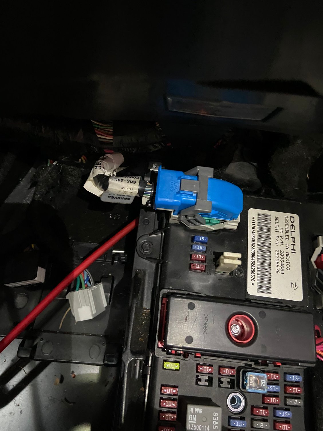

I mounted the fuse blocks on the sidewall in the engine compartment and terminated on the main (+) input in the engine compartment fuse box.
