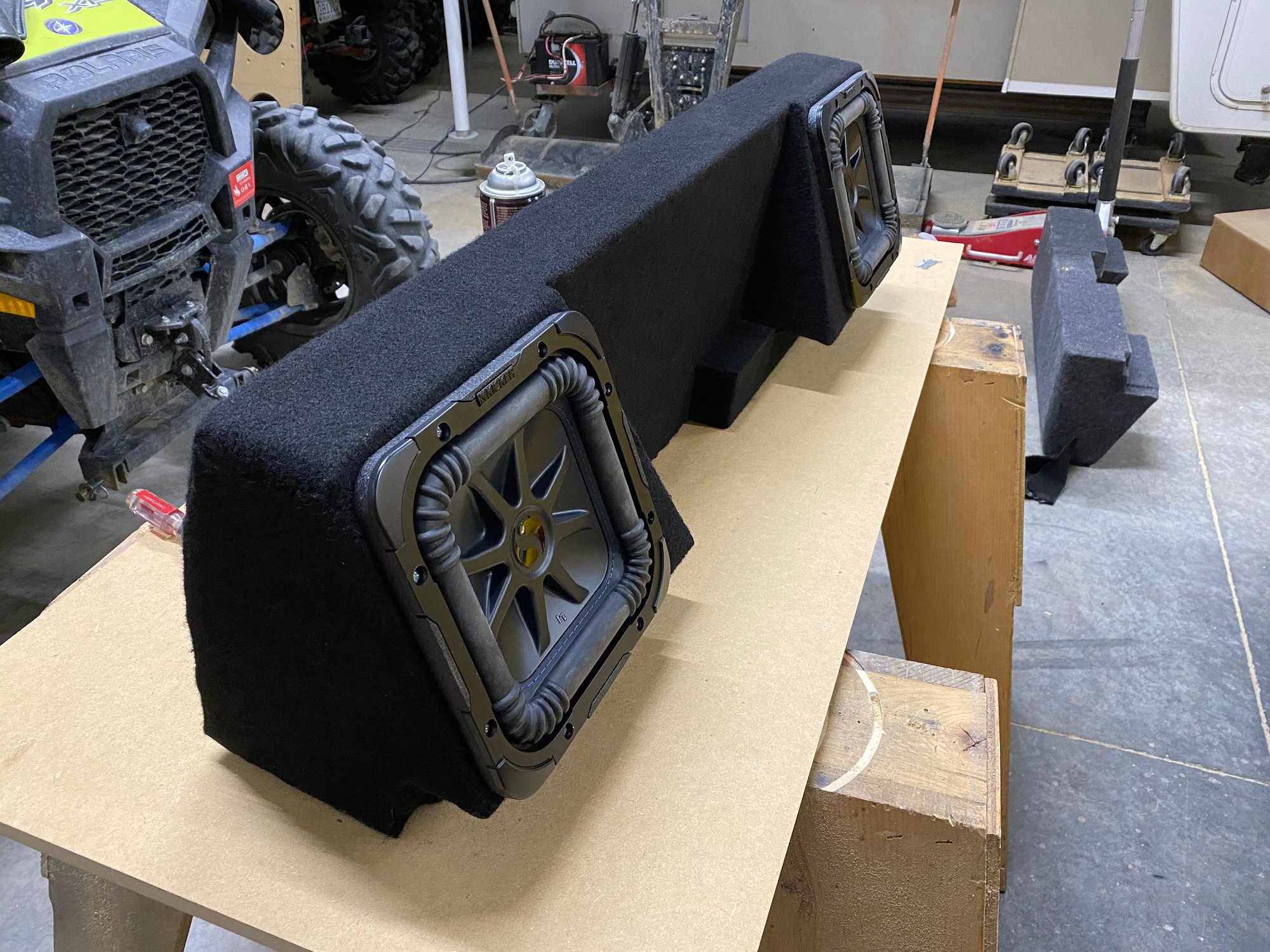

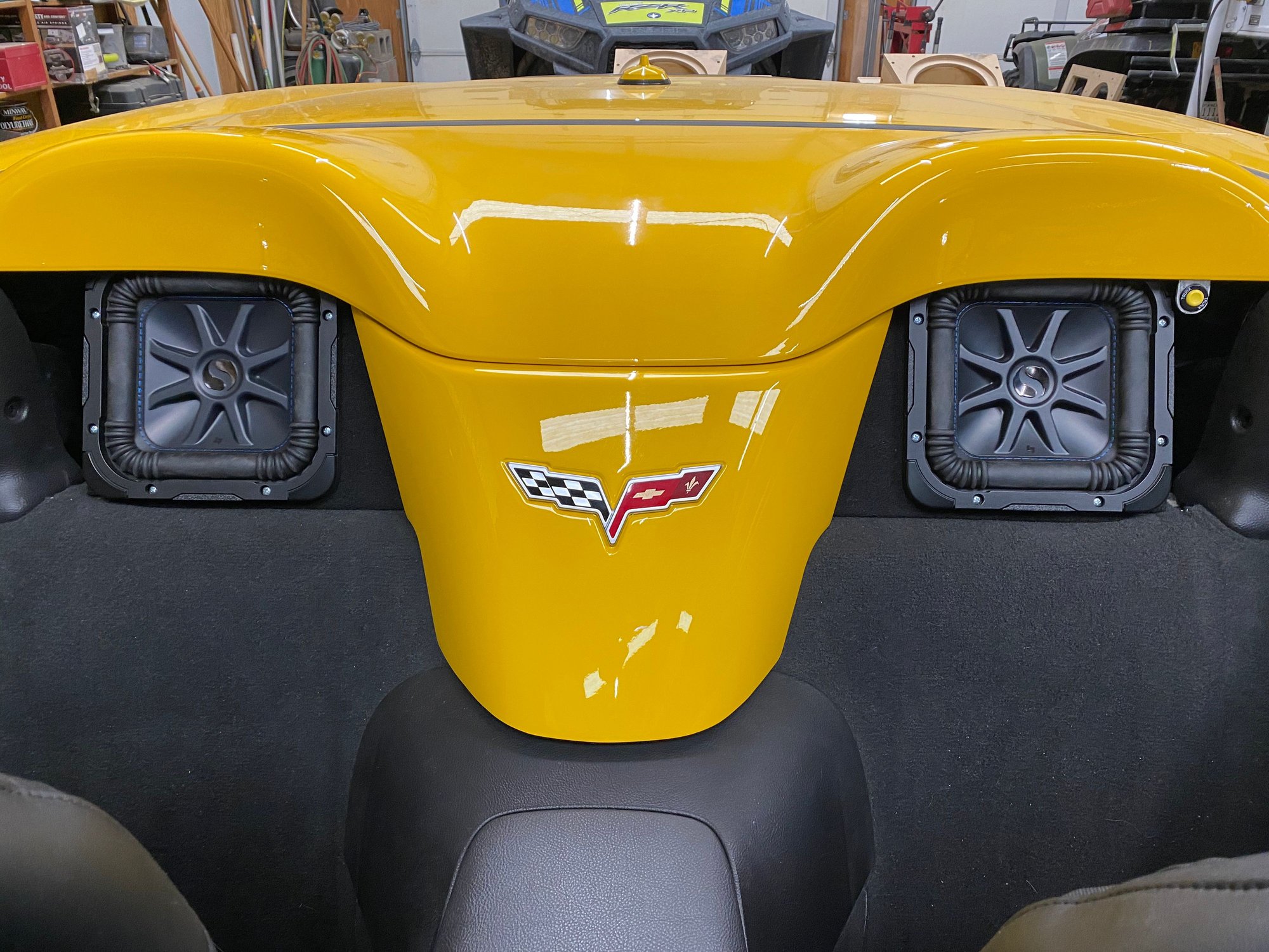

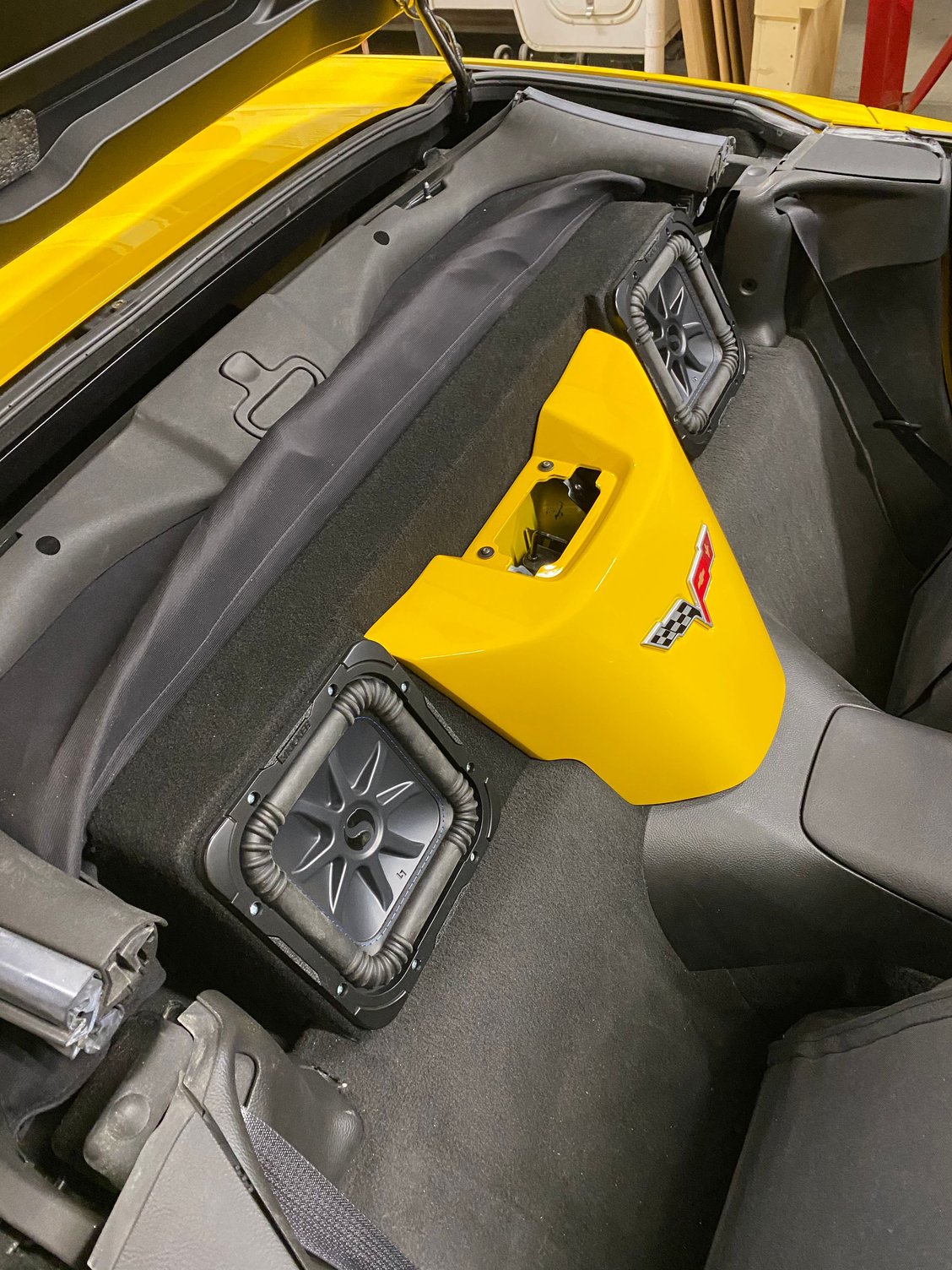

Yep adding a subwoofer can make a big difference. I have a vert and wanted a sub that wouldn’t get muffled with the top down, and take up trunk space, so I designed and built a duel 8” behind the seat sub box that fits in the place that the rear speakers were in, that I’m running Kicker Solo-barics in tied to a Kicker sub amp. They sound great either with the top up or down. Here’s a couple photo’s of my box.
