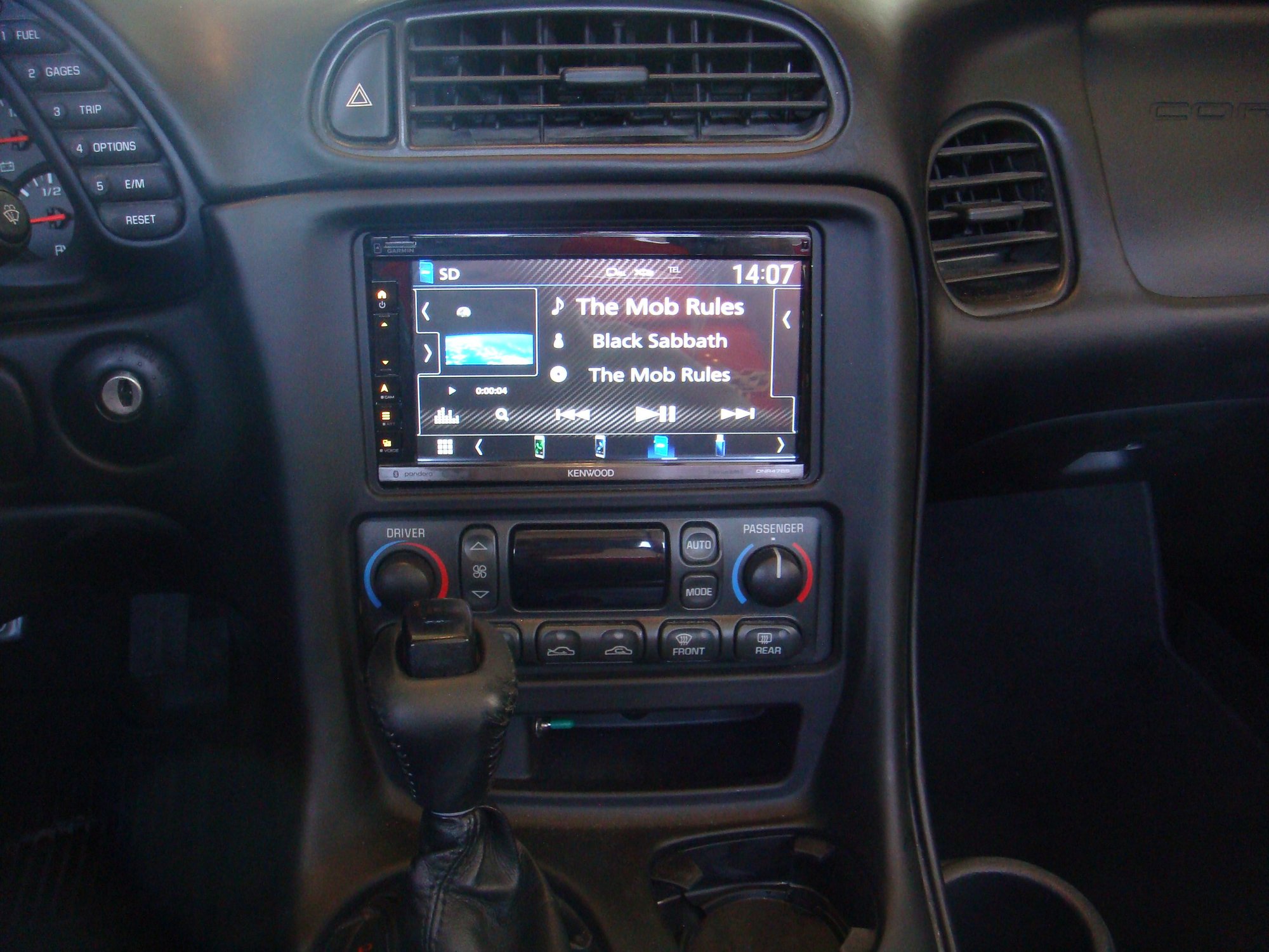

Most of the Double Din units have you want. I'm pleased with the Kenwood DNR 476. Does not play discs, but has USB and an SD card (1000+ songs on that) and wired carplay.
