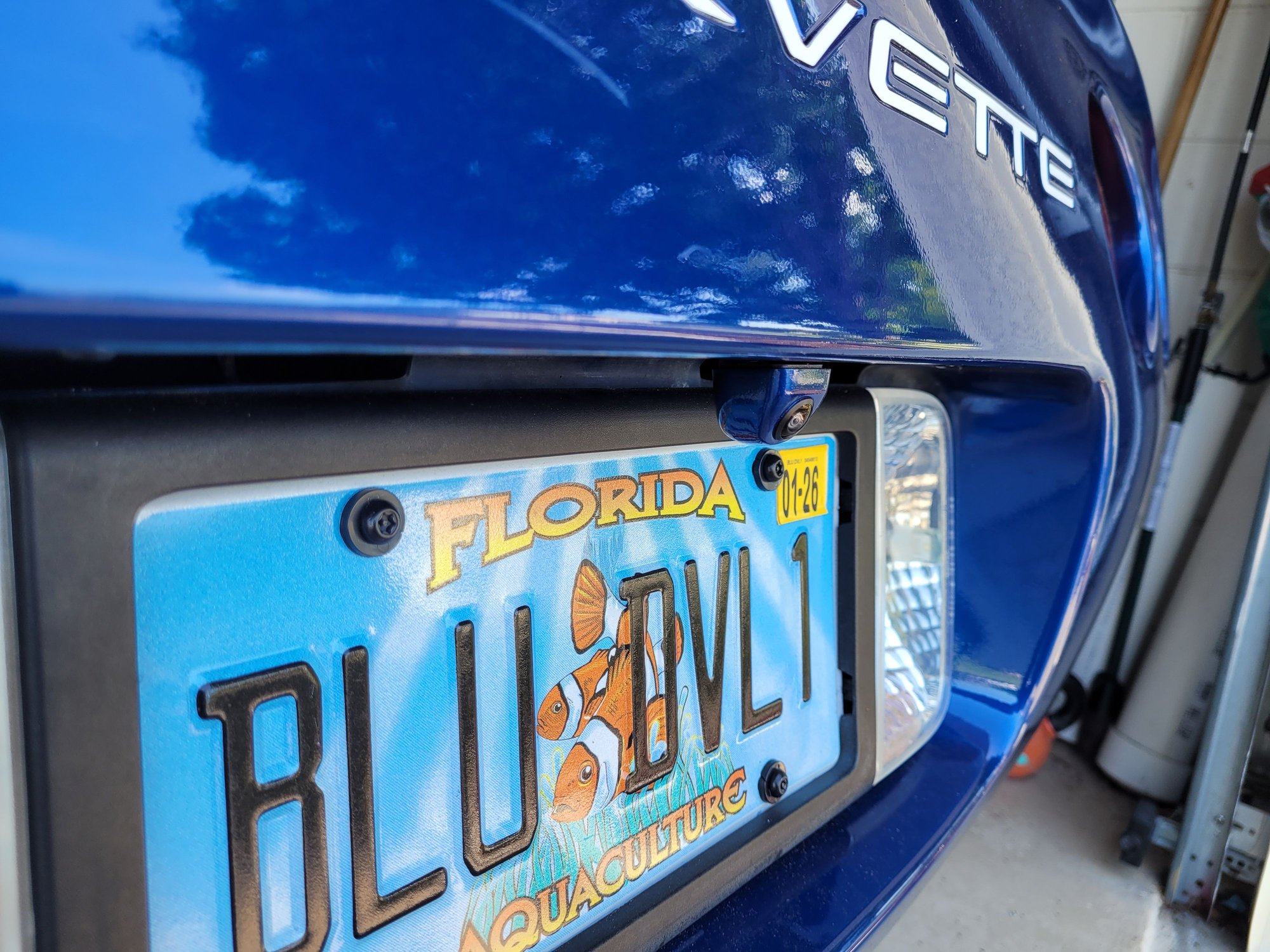

Audio/camera question. Im attempting to put in front and rear cameras on a Kenwood DDX6705s. Rear camera works as advertised. Front camera also functions connected to rear input (so i know the camera is good) but I cannot get the HU to see the front camera connection. Connected to the RCA cable and pos/ground connections and the HU wont see it (verified good ground and pos connections). Any connection of the signal wire results in the HU shorting out (kinda expected with pos/grd already connected). What am I missing here?
