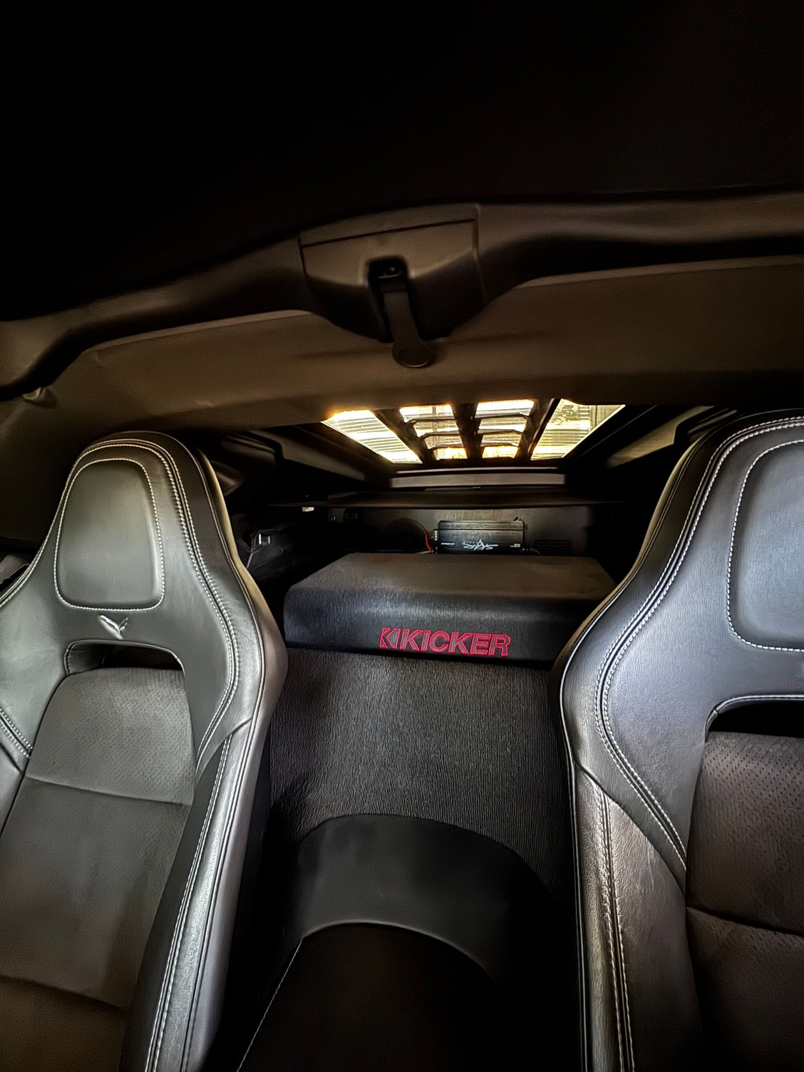

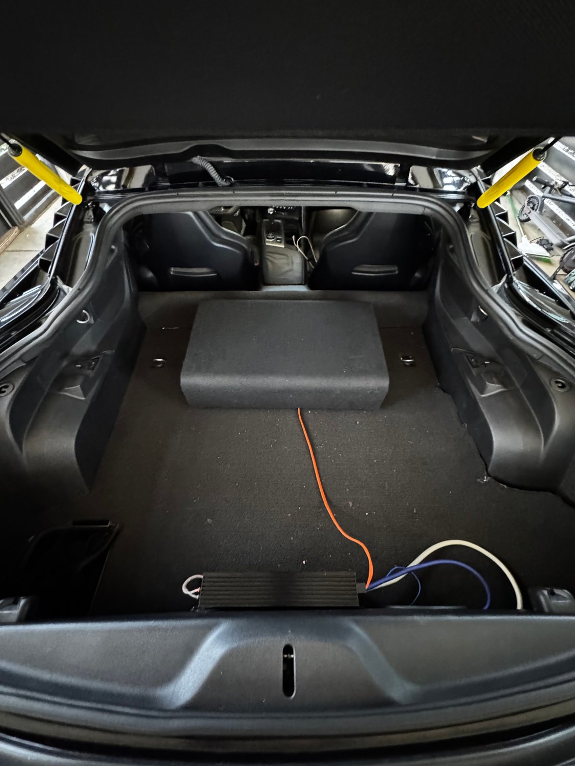

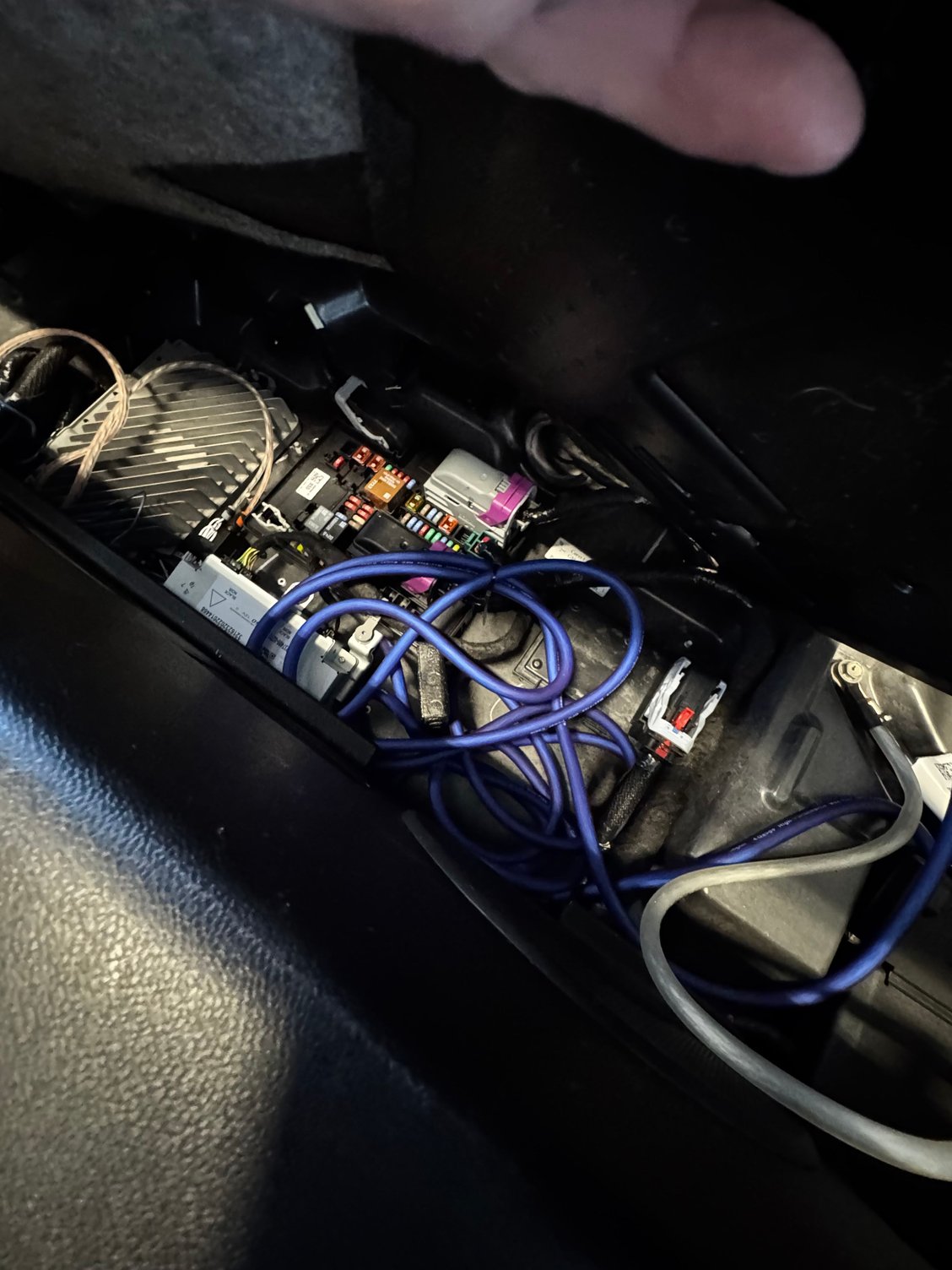

Hey guys, I installed a sub setup in my C7 following the guide from this forum. I’m using a Kicker LOC into an amp powering my sub. Everything’s wired right — power, ground, remote, and signal — but it just doesn’t hit very hard. It plays, but feels weak, more of a low rumble than punchy bass.
Gain’s around halfway, bass boost low, and the sub’s right behind the seat. Could this be a phase or LOC signal issue? Anyone else run into this with the Bose system?
  • Kicker KISLOC
  • Kicker 49L7TDF122 Down-Firing 12"
  • skar RP 1200d
Appreciate any input.

Sounds like the levels on the LOC may need adjusting. Were the microphones disabled?
Post in the audio forum here. May get better responses.

Did you ever figure this out?
Sounds out of phase.
Perhaps the + and - to the woofer inside the enclosure are reversed?
They can make wiring mistakes at the factory.

What wires did you tap into for the loc?
