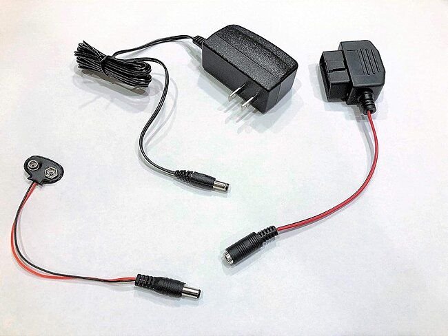

Just to reclarify, you are saying that the clock stays on and works after you put the trickle charger on but resets later on?
Do you have to disconnect the battery to trickle charge?. If not, I don't see anything that would muck it up.
If the power goes out in my house, I have to reset all of my plug-in clocks.
If you DO disconnect the battery, you might need one of these:
https://www.amazon.com/Connector-Vehicle-Battery-Replacement-Disconnect/dp/B07QV2QFTC/ref=sr_1_4?crid=26TB2AW9AM9Q&dib=eyJ2IjoiMSJ9.RcQejHGQ1wzyYvz3niWeibWWQEHyi42KQJRMr1OTRPHhkndn-SjOSJy3sCvLAnrfQUa3qOIffBjLwuN_a-Dv_EU0qSHyPR2cvQFl3ioXrkc.WbANiKFRg7Y88QuW7DhdgmC38i-nCfL6bZPd09mwD8A&dib_tag=se&keywords=9v+car+memory+keeper&qid=1771119116&sprefix=%2Caps%2C195&sr=8-4#averageCustomerReviewsAnchor https://www.amazon.com/Connector-Vehicle-Battery-Replacement-Disconnect/dp/B07QV2QFTC/ref=sr_1_4?crid=26TB2AW9AM9Q&dib=eyJ2IjoiMSJ9.RcQejHGQ1wzyYvz3niWeibWWQEHyi42KQJRMr1OTRPHhkndn-SjOSJy3sCvLAnrfQUa3qOIffBjLwuN_a-Dv_EU0qSHyPR2cvQFl3ioXrkc.WbANiKFRg7Y88QuW7DhdgmC38i-nCfL6bZPd09mwD8A&dib_tag=se&keywords=9v+car+memory+keeper&qid=1771119116&sprefix=%2Caps%2C195&sr=8-4#averageCustomerReviewsAnchor
If all of the the above is OK, then I'd call Reversion Raceworks back and TELL them to send you another unit. It very well could be a manufacturing defect in that one unit. It happens.
If the new one does the same thing, then you'll know it's something to do with your car.
BTW, looked up that head unit and it looks like a nice piece of kit!
Installation looks like a breeze. Basically plug and play. Not much for someone to mess up.
