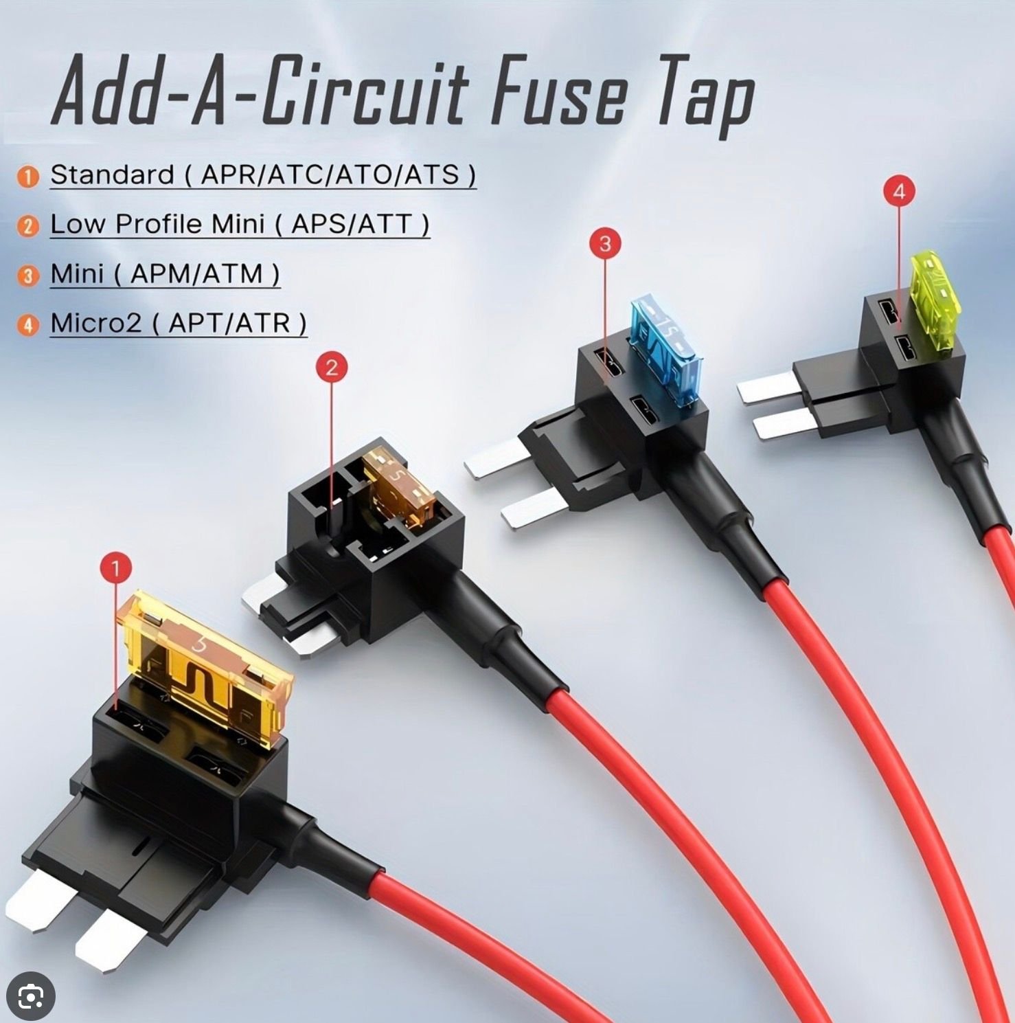

So let me get this straight, the original circuit is 10 amp, and you tapped the fuse keeping the 10 amp and adding a 15 amp draw so you're potentially pulling 25 amps on a circuit made for 10 amps is that correct? If so I suggest you disconnect the sub and run it to the battery like the instructions say. On mine I ran the + wire by drilling a hole through an area behind the battery and feeding the wire in the fire wall and its came in above the passenger side under carpet fuse panel, then ran it under the carpet back to the amp. I thought I had a picture of where I drilled the hole, if I can find it I'll post it later

I used one of the dual fuse taps original fuse goes in bottom and the extra Hotwire run has protection on top with fuse, like this
