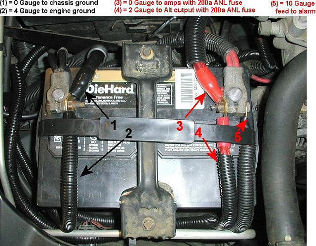

That amp is rated at 150 watts RMS x 2 at 4 ohms, 300 watts RMS x 2 at 2 ohms, or 600 watts RMS x 1 bridged output at 4 ohms. You will get nowhere near 1800W from that amp. I am guessing that this amp is using a 60A fuse. Your stock charging system should be able to handle this load. IMO. with no real amplifier power going to your mains your system is going to be all bass and the SQ will probably be bad.
The "Big 3" upgrade is a wiring upgrade to your stock electrical system. It looks something like this:

The amp will at best do 600x1, it probably does less. Look at the model number "601s" -> 600 watts, 1 channel. See here:
RF 601s Page
1800W is a total peak power marketing number that is thrown around to look nice on the shelf at Best Buy. This amp will not get anywhere near that. A real 1800W RMS would require at least a 150a fuse and zero gauge power wire because it would be pulling over 130a of current from a 14V electrical system. I am guessing that this amp uses a 60a fuse and it has an 8 gauge wiring block.
In any event, the amp should be just fine for your setup, especially since you are not amping your mains. Make sure you are giving the amp a 4-ohm load. With the DVC Solobaric you would need to be running a dual 2-ohm sub with the dual voice coils wired in series. Sending this amp an impedance lower than 4-ohms when bridged would probably overheat it and maybe burn it out.
I doubt that you would need to do a full big 3 upgrade with just this amp (60A fuse on it, correct?). Make sure that your alternator, battery, and charging system are all in proper working order. Run 2 gauge cable from the negative batt terminal to bare metal on the car's frame as a minimum to provide a good return path for your amp's ground.
