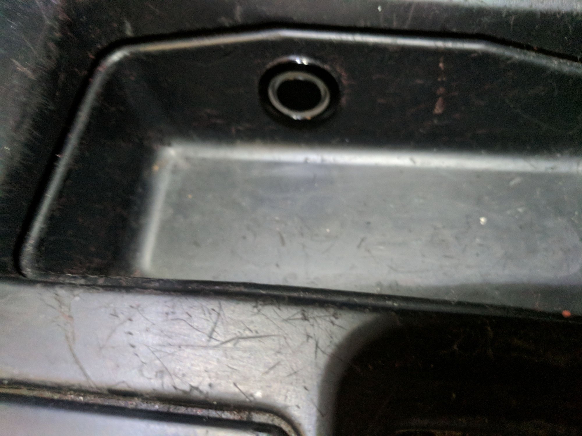

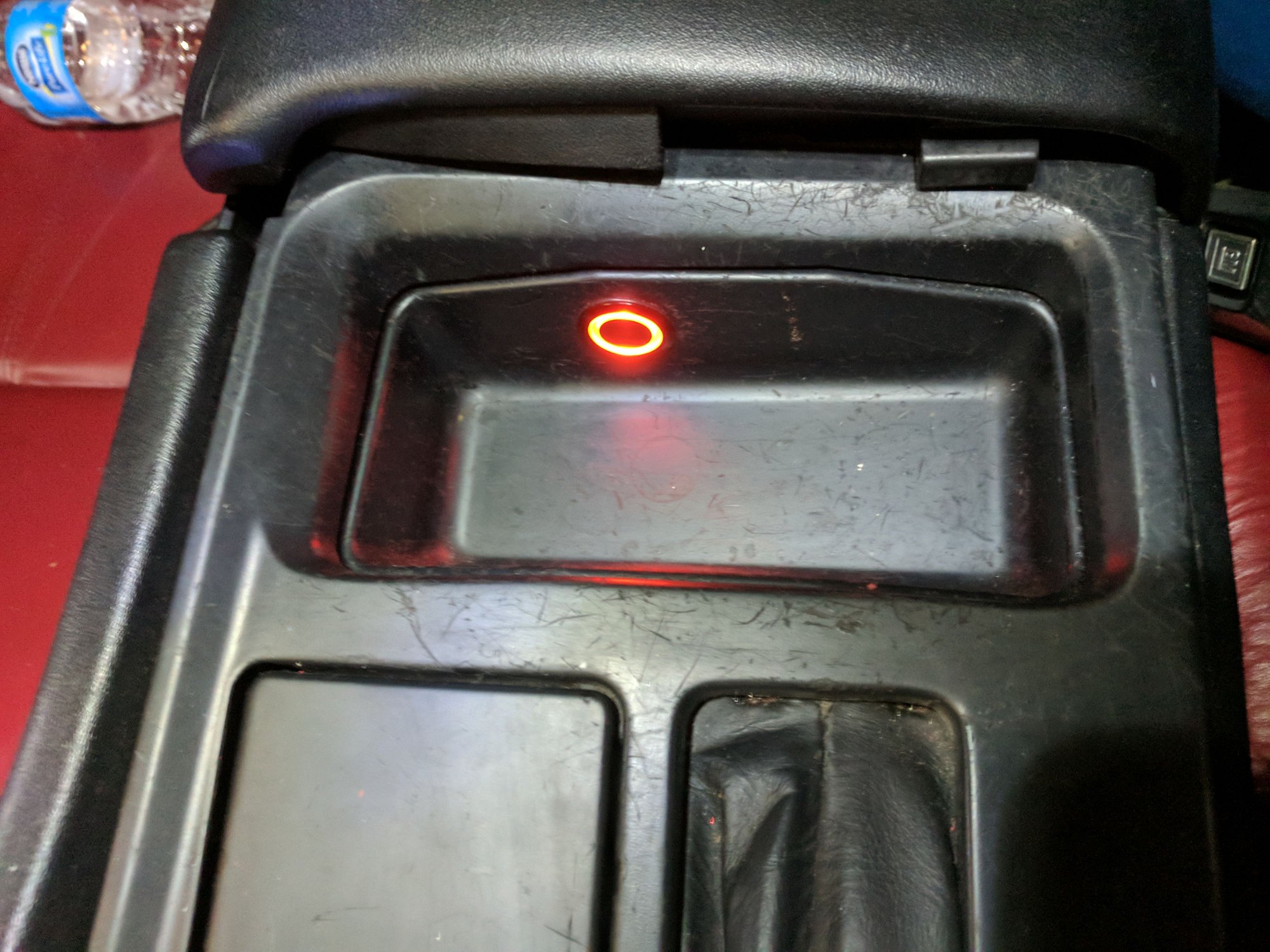

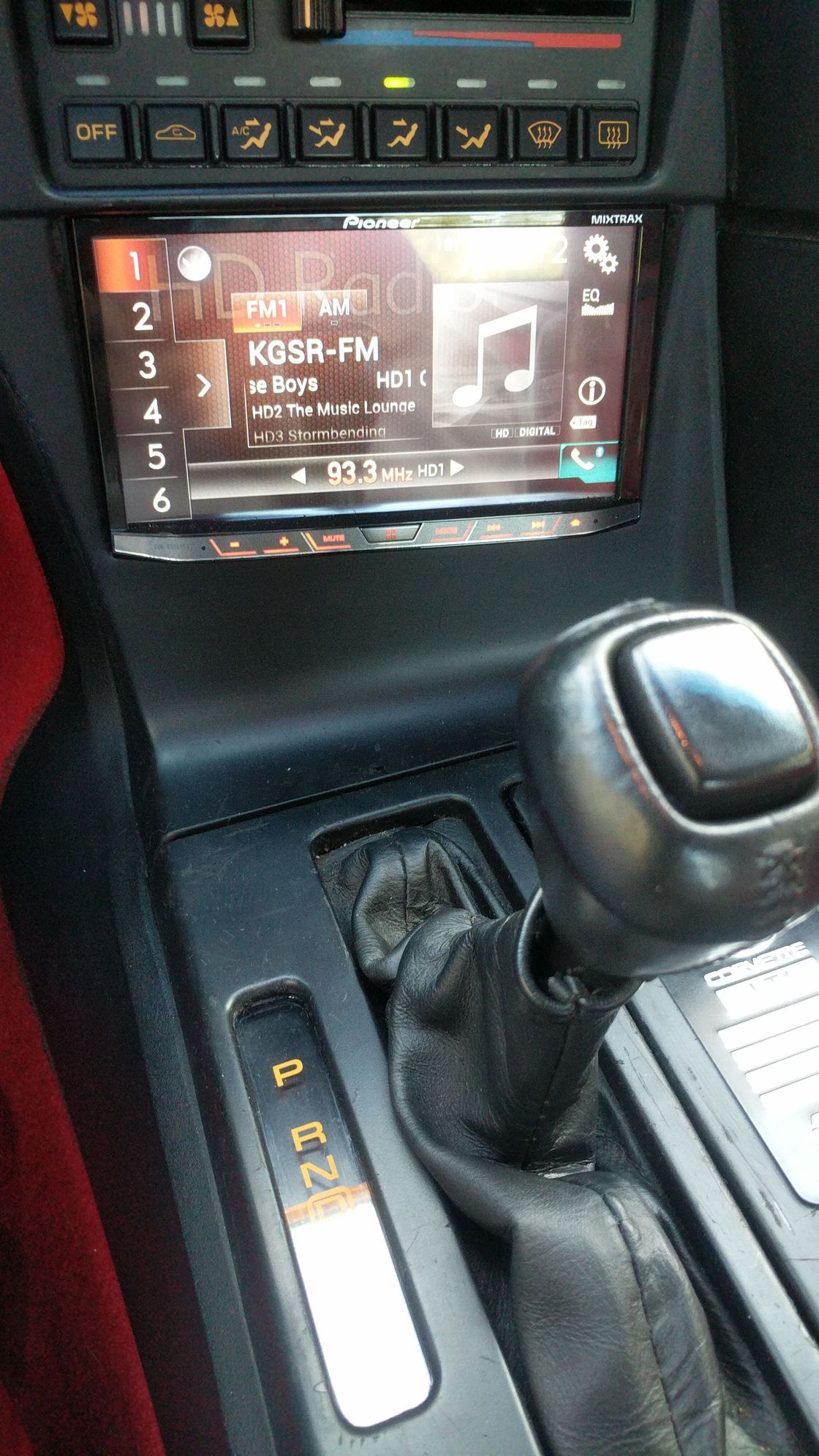

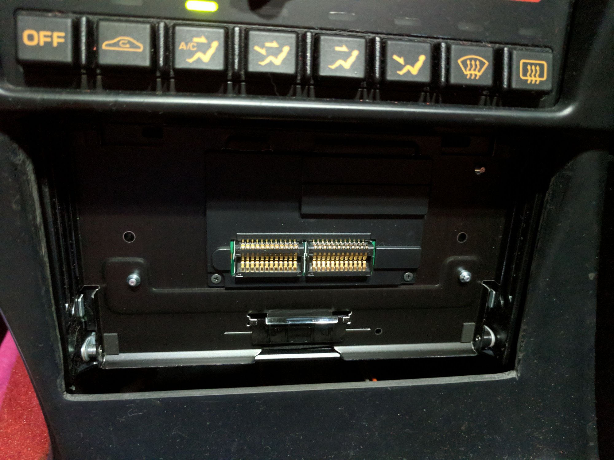

On my 1992, I had to trim out a bunch of the facia to get this one to fit, the Pioneer AVH-4200NEX. This was due to the removable face-plate that also tilts (which is nice due to the low spot in the dash). I got this unit mainly for its Android Auto abilities.

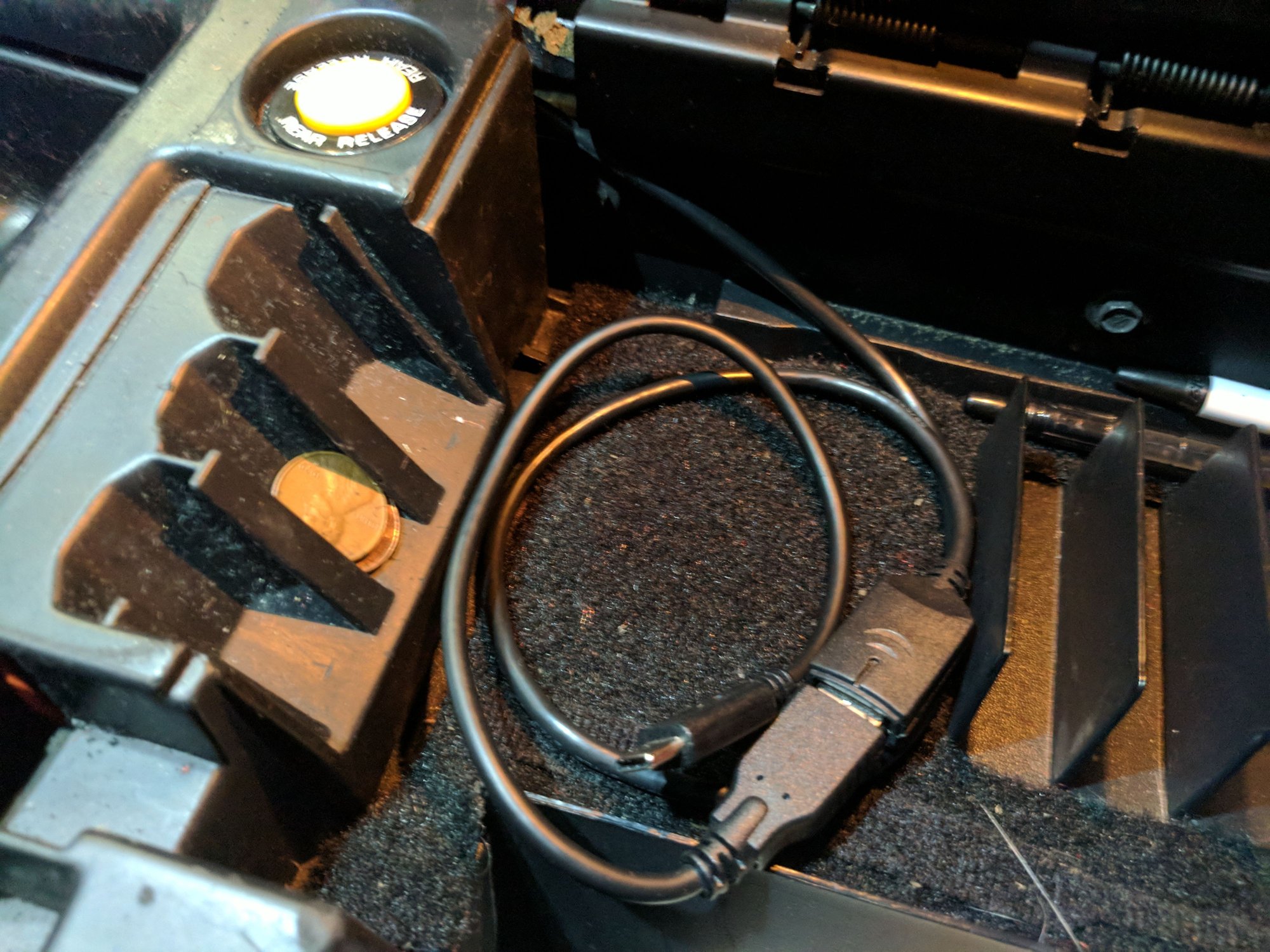

I ran the USB through to middle to an existing gap near the console door hinge. I then added an anti-vandal type switch in the open tray (where the ride control option would go) for an antenna delete. The button is facing the front, so it it is easy to just reach down and toggle it. I originally had a silver with blue LED, but then changed it to all black chrome with an orange/amber LED. It is hooked up to the dimmer circuit, so it fades with the dash, even though you don't really see it.
Some of these panels are really quite scuffed up (due to 25 years of use). The camera really shows that off.
AVH-4200NEX head unit installed.
USB Cable pass-through.
Antenna Delete Illuminated.
Antenna Delete Non-lit.
AVH-4200NEX with custom background.
Face plate fully tilted to allow media inserts.
Face plate removed.
