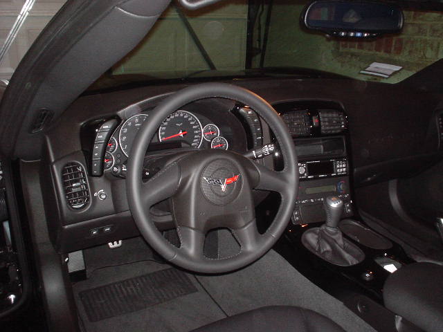

These are terrible photos taken in the garage with someone else's camera. (Yes, the garage walls are mint green.) The amp cover comes back from paint Friday, and is the real star of the show, so consider this a preview :-)

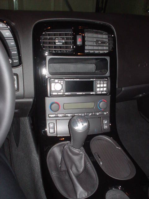

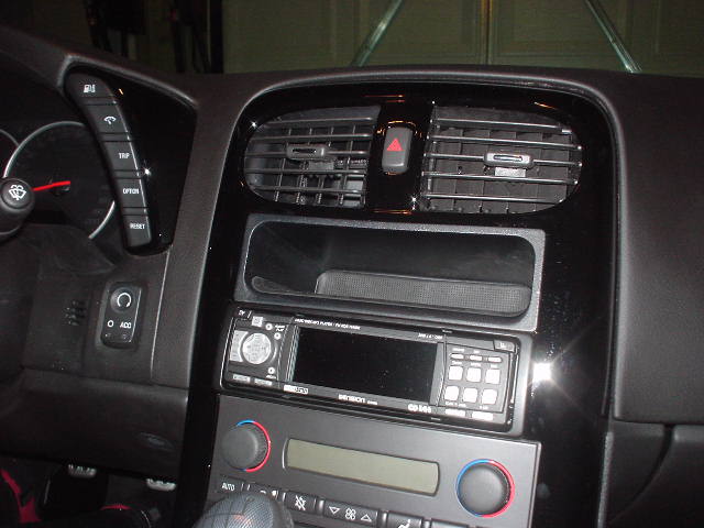

Here's the Dension DH-100ix deck and a full-DIN pocket (from a Porsche). The deck might have looked better centered, but this puts it right at hand, and the ashtray is so small that, dammit, I wanted a pocket. This also leaves me with a full DIN for future expansion.
Note the console is filled in around the deck and pocket and painted black. It fingerprints like crazy, but it's worth it. The "spots" you see near the flash (sorry) are not apparent sitting in the car. The deck protrudes slightly from the console to compensate for the curvature of the climate control.

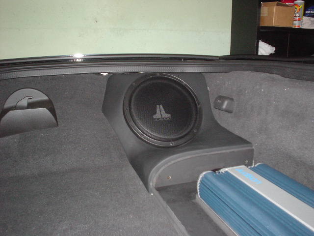

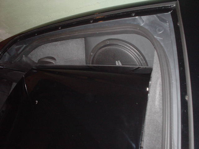

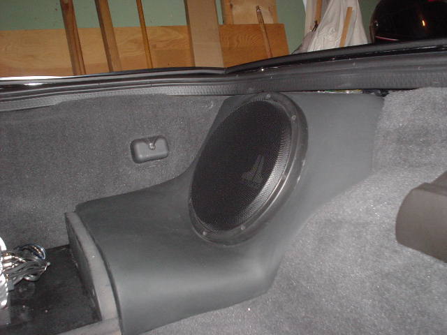

The sub enclosures are a marvel. Each is two pieces: a fiberglass tub topped with a ring of MDF, filling the rear cargo pocket and flush with the floor, open to a fiberglass-and-MDF "box" enclosing the JL Audio subwoofer, covered with satin-finish vinyl. I almost didn't post these pics because the amp cover isn't there yet and these don't look like much, but the sub enclosures have more curves than Rita Hayworth and have to be seen on their own.
Yes, those are ten inches, and yes, the top still locks in place above them:
The amp is an Audison LRx 5.600. The Dension head unit (probably the weakest component in the system) lacks separate sub output so there's a small dial tucked in the corner of the center console to adjust the subwoofer output.
