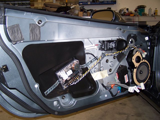

Hope this pic can help you. MB Quart Platinum Series Components.
