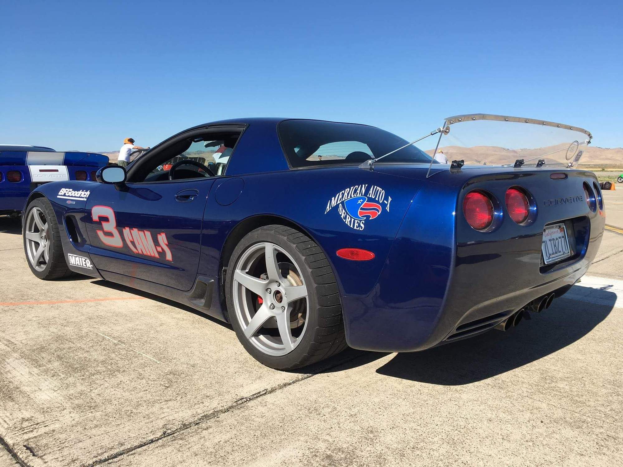

315 Falkens on a 10.5 rim is a nice fit with no bulge. 315 Rival S on a 10.5 has a bulge to it. Those sale tires on an 11in rim have a slight stretch for the Falken and a straight up sidewall for the Rival S. Reference my car which has 18x11 +62 f/r with 315 Rival's

This is the Falken 315 (left) vs. the BFG 315 (right). The Falkens are on C5z rears and the BFG on a 18x11. Each tire fits each wheel perfectly, with the BFGs running a slight bit wider.
