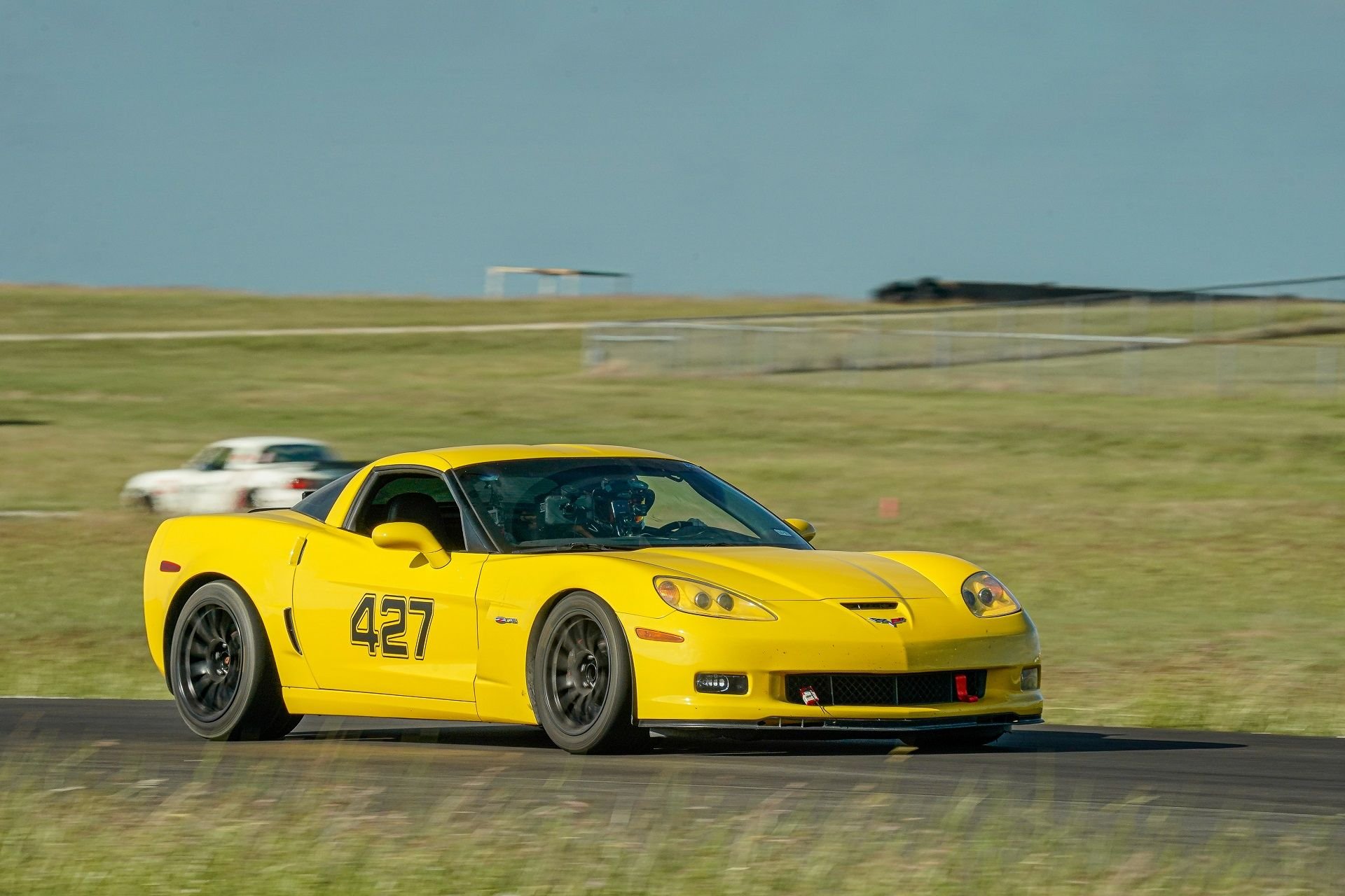

I'm building this car to compete in entry level time trial/time attack events as well as a HPDE car. Currently building it to the Gridlife Street GT class rules. I hope to get out to a couple Gridlife events next year. Let me know what you think of the build and what you would do.
Current mod list:
GSpeed Penske 8300 single adjustable shock package
Gspeed spherical control arm bushings
Gspeed solid engine/trans mounts
JOC front and rear sway bars
AMT Camber kit
Apex SM-10 wheels - 18x11 front 18x12.5 rear
OMP HTE-R seat
OMP Steering wheel
AMT seat brackets
AP racing CP9660 BBK
Future planned mods:
Rebuild heads
ARH Headers
Vararam CAI
Some pics of the car:

I'd look into a vented hood and possibly a larger oil cooler and radiator in addition to your current and planned mods. As you get faster the temps will get higher, especially when it is hotter outside.

315 are pretty much the widest the fast 200TW tires come in (the wide Conti’s are pretty new so not much data yet). The 315 A052’s work just fine on the 12.5” SM10 Name:  lI8MkGml.jpg
I’ve tried both 315 and 295 A052 on the front with the 11” SM10’s. I’d go with the 295 since they’re cheaper, lighter, and feels faster responding in transition while not giving up any noticeable cornering grip to the 315. The 315’s are pinched on the 11” wheel and the A052 have a soft sidewall in my opinion, so there’s nothing to really gain. Here’s the 295 A052 on the 11” SM10.
