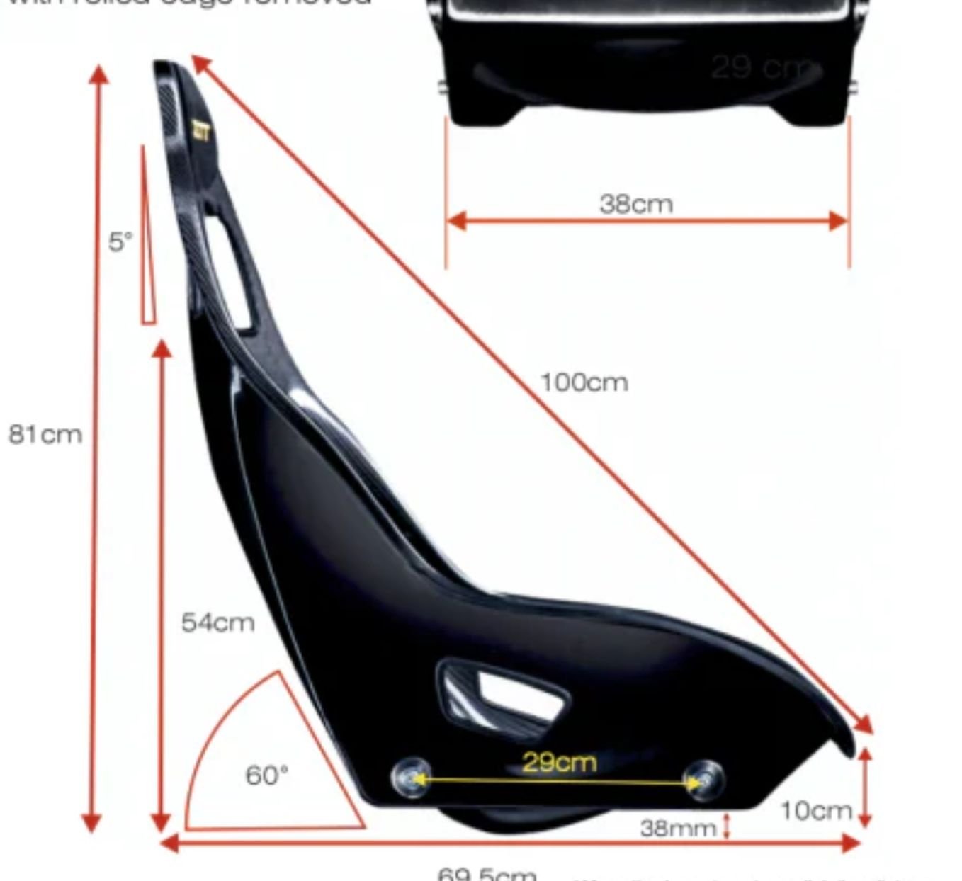

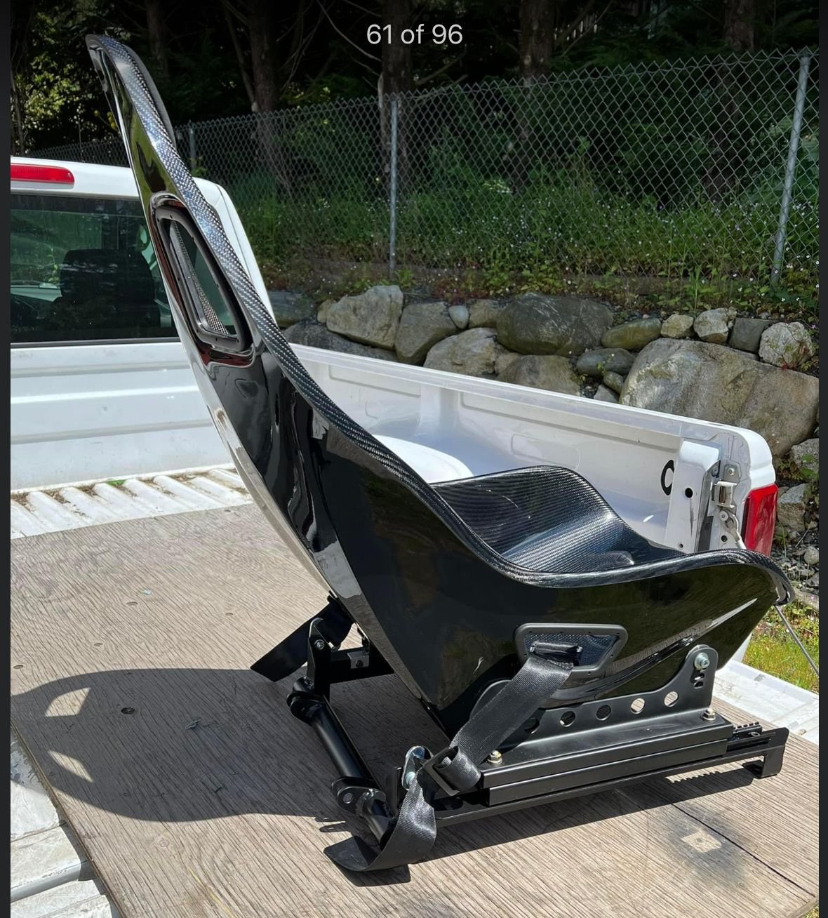

In the same boat as you. low back fused, 5 vertebra with rods. I wasn't going to let back discomfort get the best of me. Tried Sparco, Racetech, Recaro and Momo.
Ended up with this seat. Tillett B6 Scearmer. Amazing
If you need an easier seat to get in and out of , Tillett B2

Thats very surprising, I would have never thought a bare carbon seat was comfortable.
Don’t you slide around?

No.

Looking at the Tillet seats they do look like the have more recline built in then any other fixed back seat I’ve seen, at least from pictures because I’ve never seen one in real life

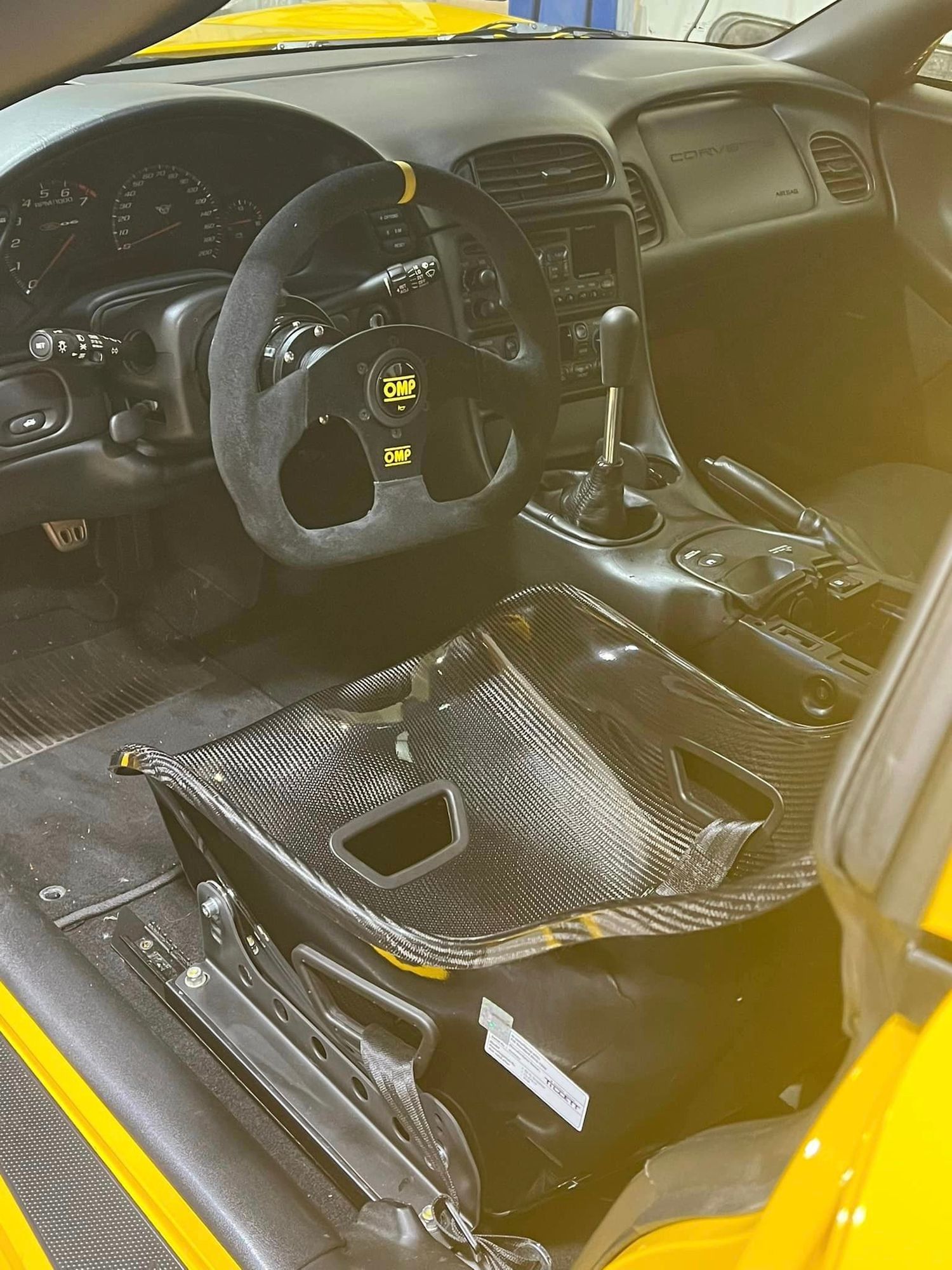

Note how much tilt back into the seat, then able to get more in the bracket adjustment.

yes that’s definitely a lot more recline then the average race seat!
where did you purchase the seat and what mounts/rails did you use?

Built my side and floor mounts. Bought the Tillett side mounts, they are not bent 90 degrees and did not work for me. .
Videos of what I did:

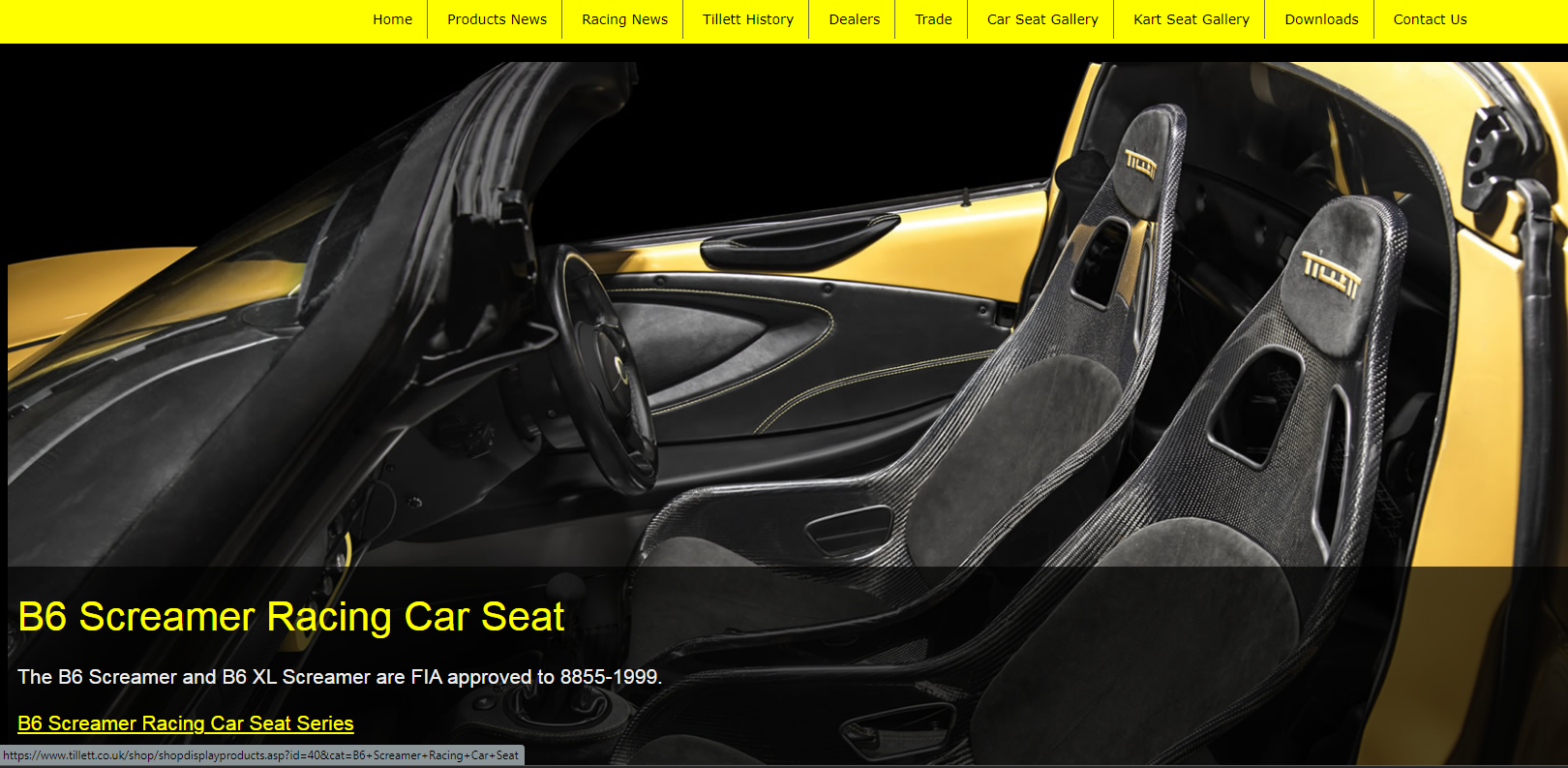

The Tillett seats don't have any crash test ratings from what I remember. Something to keep in mind.

Look at the the above photo, you can see the FIA sticker.

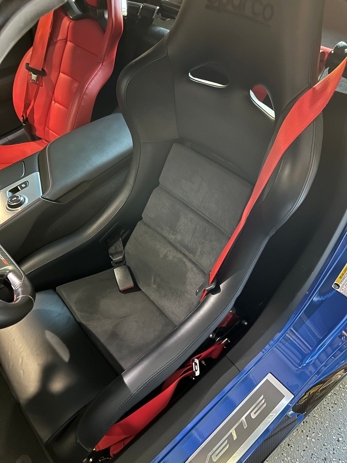

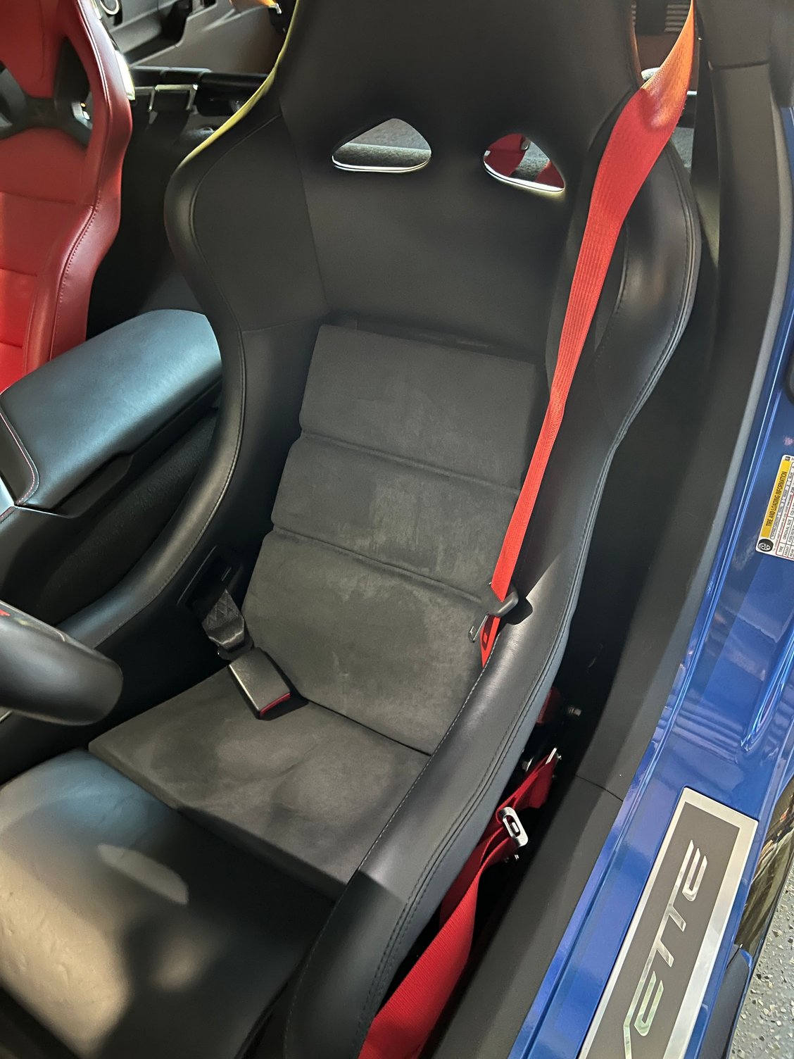

Another update.
I ended up buying a pair of Sparco QRT-R from a local buddy for low enough price that I figured that I’d might as well give them a try.
I installed the drivers side only (I MAY use the other one in my other car if this works out) with AMT mounts and no sliders.
I had a really hard time getting enough tilt on the seat with the AMT mount and even reached out to Mark to see if anything else could be done (much appreciated Mark!) but ultimately it’s the seat problem and not the mount itself.
Sparco changed the mounting locations on the new QRT seats and moved them up in comparison to older Sparco seats, or at least this is what I could gather.
Anyway, after much fiddling and adjusting I got it to a pretty good position but again missing a bit of recline for my taste.
After driving around for a bit with the seat as it came from Sparco I was very uncomfortable, felt like I was sitting like a hunchback and my back got stiff fast.

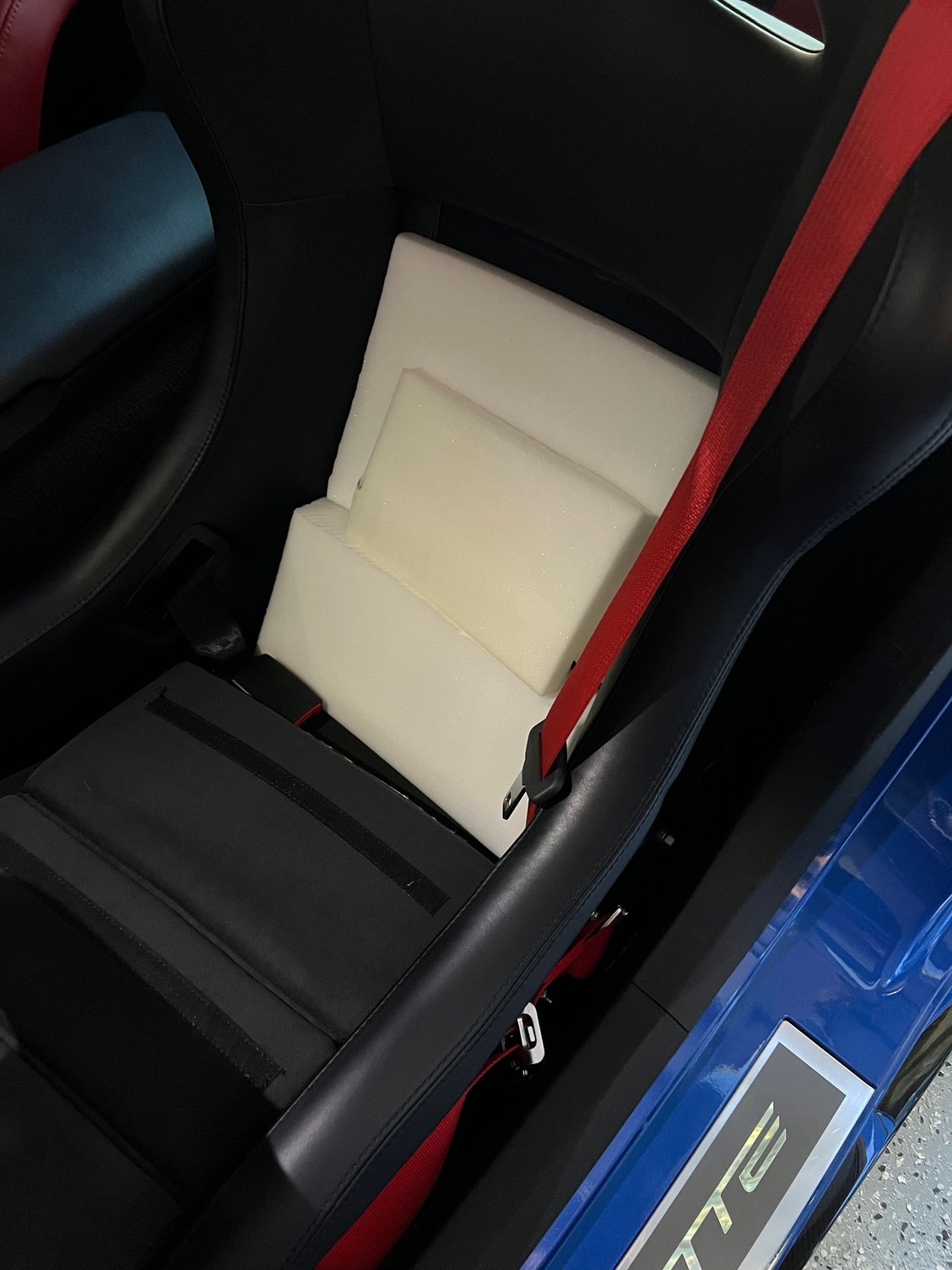

So not wanting to give up I took some of the advice in the thread and purchased cushion memory foam in several thicknesses from Amazon and got to work on adding pieces of foam behind the seat back cushion to add way more lumbar curve and taper it as it goes up as it should. Ended up using a combination of 2” and 1” foam to make the added lumbar support.
Im happy to say that I now find the Sparco seat more comfortable then the stock seat for my back. On longer drives the shoulder pads can get annoying and in my seating position is not as comfortable to shift as the shoulder pads keep my arm from moving back. But honestly even with those complaints I’d rather the Sparco seat over the oem Comp seat.
I also changed my harness setup for a true 6 point with 2” belts and that plus the seat made a big difference on track driving. Also kept the stock seat belt and used 10” a seatbelt buckle I found on EBay (came with a whole belt system kit) for street driving.
So all in all happy with the switch but I would like to add sliders to make it easier to get in and out of the car (specially in my garage I can’t fully open the door without hitting something)and hopefully a way to add a bit more recline

Some models are FIA certified (B6), some models are not (B5).
