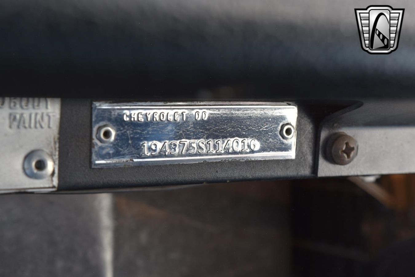

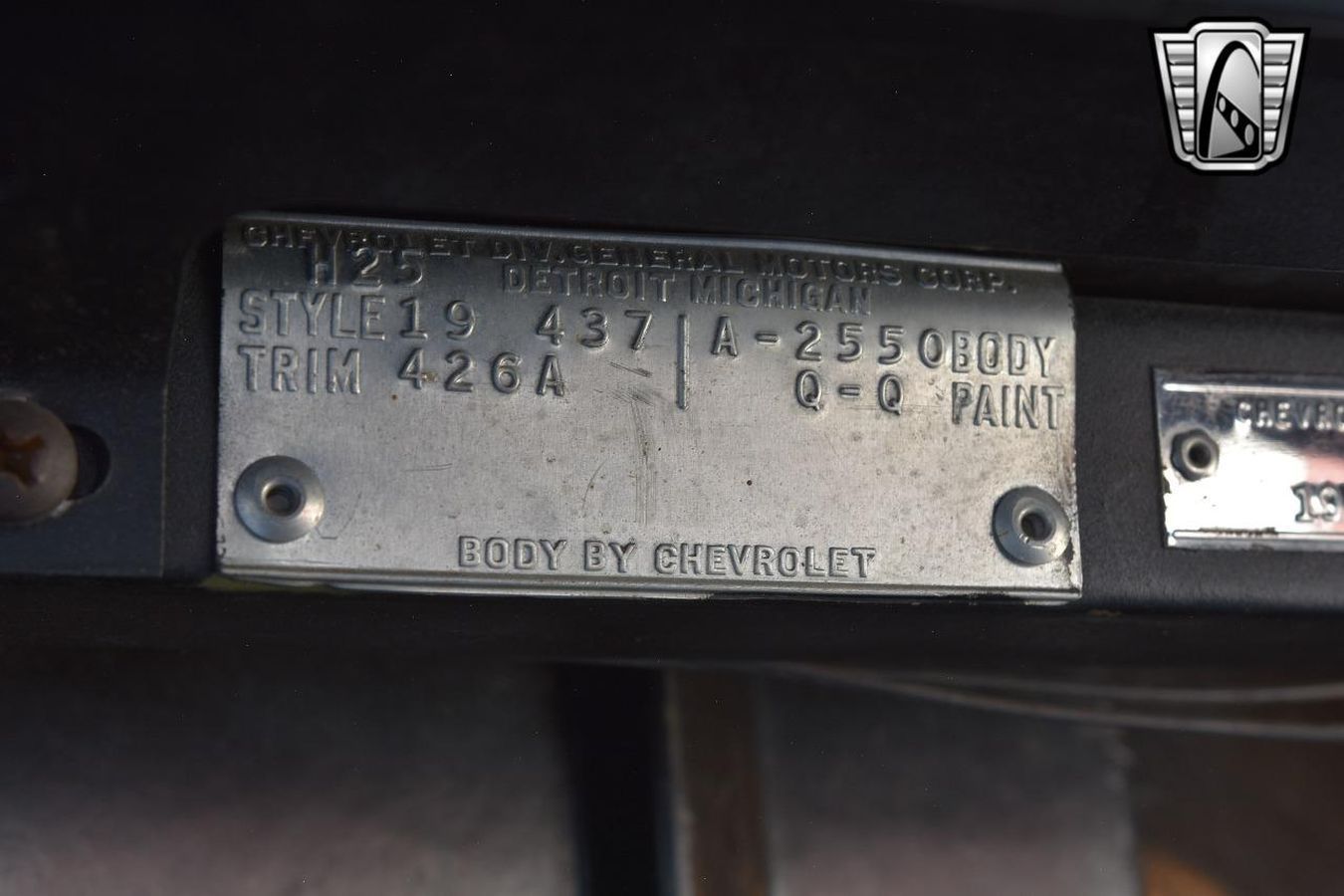

There is a 1965 coupe currently listed on Hemmings Classified that, by the cowl tag was a Silver / Silver A.O. Smith car. It is currently a White / Black car.
1965 Trim Tag A.O. Smith Body Silver Pearl with Silver Vinyl
1965 VIN
