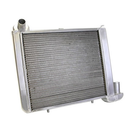

Originally Posted by tebok
There are bulges on each end that may be the tanks you're describing.
It's a painted versio of this:
Any chance the last owner painted it himself and clogged all of the fins?
Although not as good as a DeWitts repro, that Griffin radiator, in good condition, has plenty of capacity for your car's engine. My bride's track car runs this radiator which cools a 377 in full song lap after lap. On-track coolant temps have never gotten above 180.
That said, you might want to run your hand all around the front of the core to ensure that the whole radiator is participating in cooling the engine.
Jim
