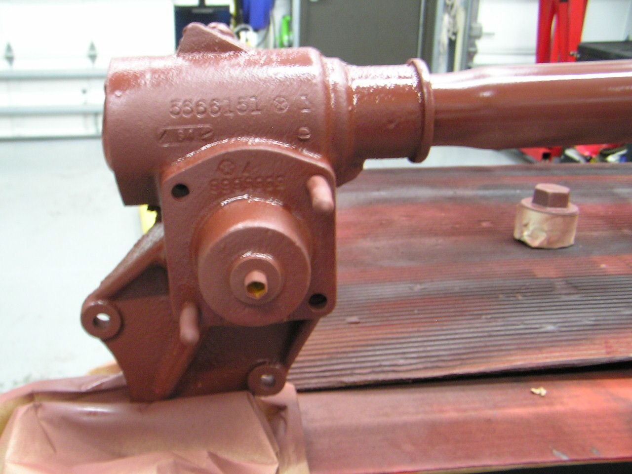

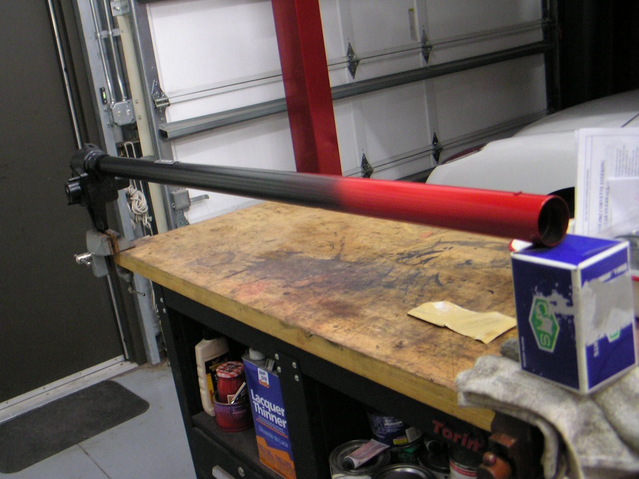

However, I have had good luck in some cases with lacquer over enamel. When I restore C1 steering columns, I prep/prime then paint with Acrylic Enamel(I use Dupli-Color semi-gloss black). Then after a week or more of enamel cure time, I use my TCP Global acrylic lacquer for the top column color to match the interior fiberglass pieces.(kick panels, pkg tray, etc) I don't lay it on too heavy, and use minimal thinner to keep the bleeding into the enamel to a minimum. Never a wrinkle to date.
