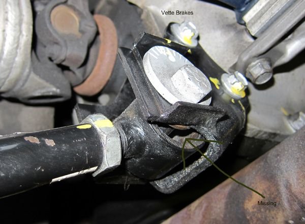

I call my local supplier to order a new strut and told him the rod was bent. He said it was common for alignment shops to do that to bring them into adjustment when it was necessary to gain more adjustment than the cams allowed.
It was even more common for gas station jockeys to raise them on a typical 2-column lift with a cradle for a solid rear axle, and the axle cradle bent BOTH strut rods; the midyear Corvette was the only American car (besides the Corvair) with independent rear suspension, and most gas jockeys had never seen one.
The only time I ever saw a strut rod camber bolt come loose is when it didn't have the two little hardened cap washers installed on the ends of the inner sleeve.
AND the Pontiac Tempest
