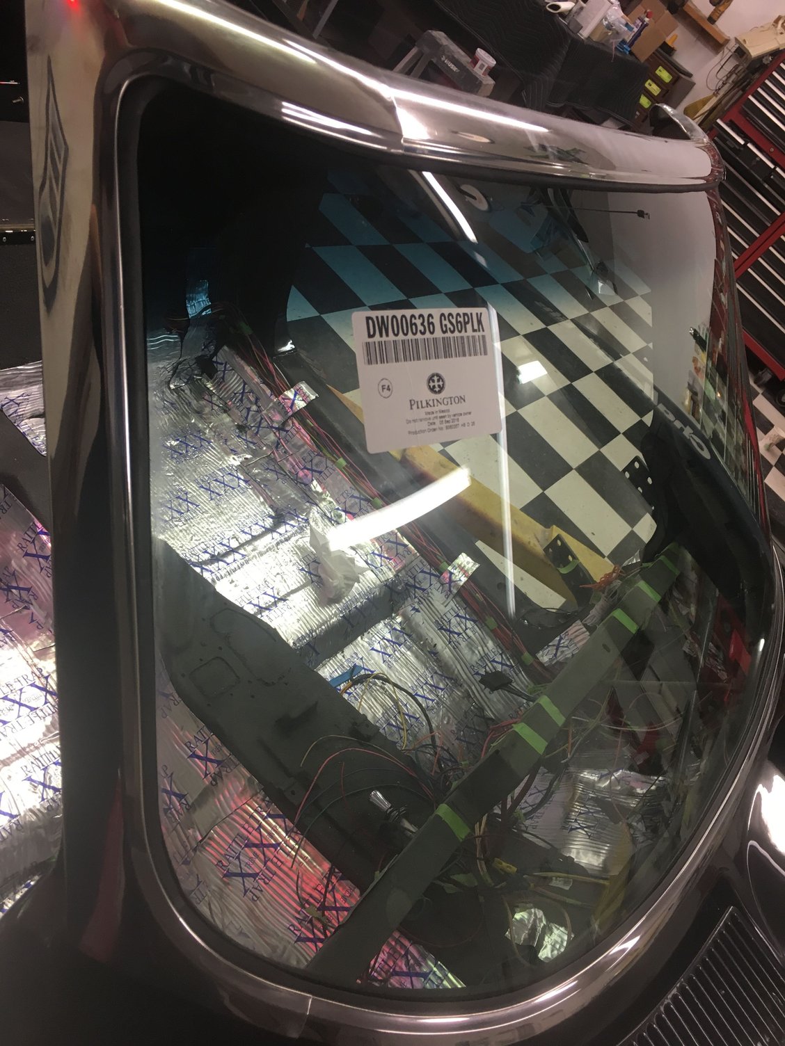

fter cleaning up the windshield channel, resealing and painting it, cleaning and painting the clips, installing the clips with sealer on the
screws, I installed the the windshield. I basically followed the advise from above posts. I put the gasket on the windshield using masking
tape to keep the gasket attached on the top side. 9/64 inch nylon rope was placed in the rubber gasket slot that fit over the pinch weld.
I placed the windshield in the opening and slipped the gasket "inside the clips" - centering it right and left. I pulled the making tape pieces off the top
portion and then went inside and started pulling on the rope. Note: this was all done dry - I did not use any lubrication. The Rope trick
worked well, I did a foot or so on each side at a time and after each foot of "lip flip" I would go outside and push or manipulate as necessary
to make sure the gasket was in place. It got harder as I went up each side and around the top corner. Here the windshield was most of the way
in so the pressure between the gasket and the pinch weld increased. I used a plastic molding pry bar to coax the rubber gasket lip out and
around the pinch weld - going about an inch at a time on the top to assist the rope pulling. I suppose if I had used a lubricant, this might have been easier.
After the lip was full around the pinch weld, I used the handle end of a hammer to push the gasket onto the pinch weld from the inside. This
seated it and was a necessary step. Then I went around the windshield from the outside with a plastic pry bar to make sure the gasket was still seated
on the glass.
I was pleased with the installation - it took about 60 minutes. In retrospect, applying lubricant on the bottom portion of the rubber gasket, for the top portion of the windshield might make it easier.
So when it was done, I took the car out with the defroster on full heat, figured the heat plus a few bumpy roads would help to seat what was not already right. Next step would be to is squirt the bedding (Black stuff) between the rubber gasket and the window frame - hopefully keeping it under that gasket lip.
I had given a lot of thought to installing the gasket on the pinch weld first and then installing the glass - not sure why this would not work, it would
certainly allow for better bedding (that black stuff). BUT - nobody seemed to do it that way and I figured there must be a reason.

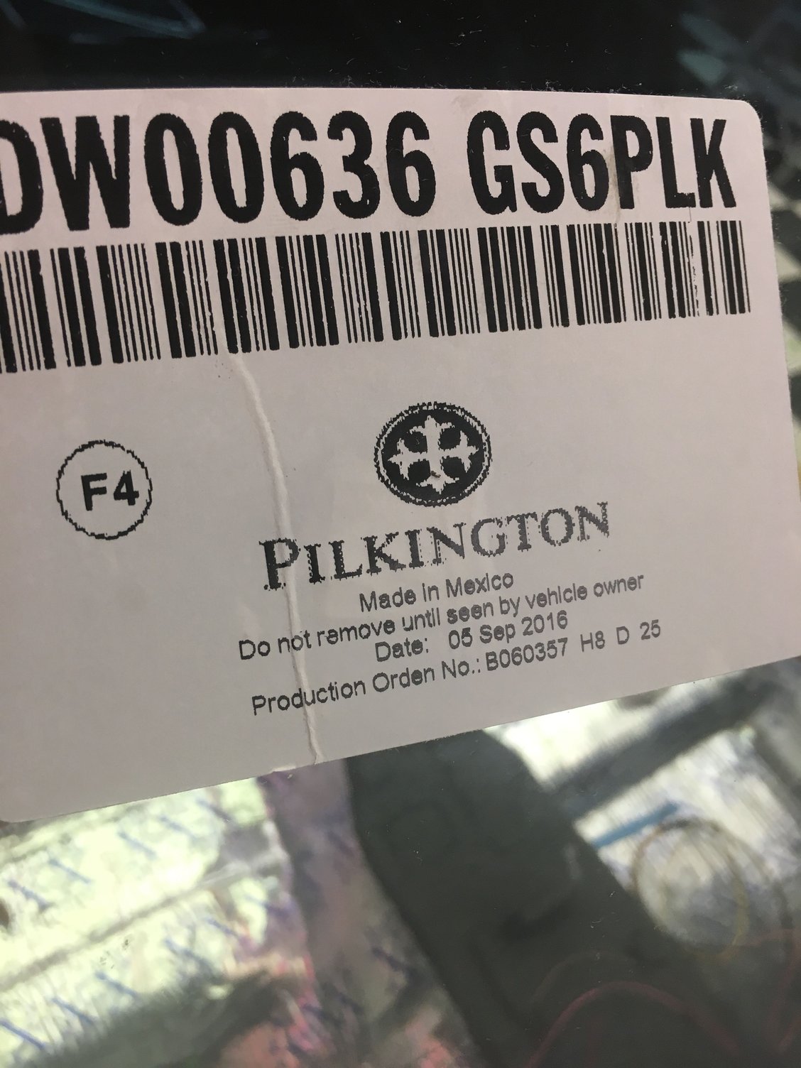

So the problem now is with the glass itself - the glass I got is distorted at the right bend, did not notice until it was installed. - This has me a bit bothered, very noticeable and I'm not going to use the existing glass - Ordering new now - will let you know who that goes.
Which brings me to a question - I probably know the answer - Do I need a new windshield rubber gasket?

I spoke to the vendor about the glass - sent pictures of a grid I had drawn on a piece of cardboard to show the distortion and where it was in the glass. Although I still do not like the delay, the vendor was great - new glass is on its way. It is really nice when people back up their products.
