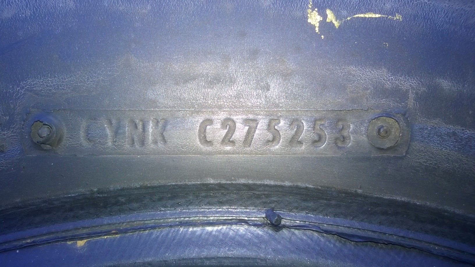

I am trying to figure out how old these tire are, but do not know how to decode.
They are DOT stamped
code / CYNK C275253

Okay, I'll bite... they were made the 25th week of 1983...
Re: https://www.corvetteforum.com/forums...tire-code.html
See post #7...
Good luck... GUSTO

Gusto - great answer and the back up information. 1983 because it does not have the triangle added in the 1990's.
Dan
