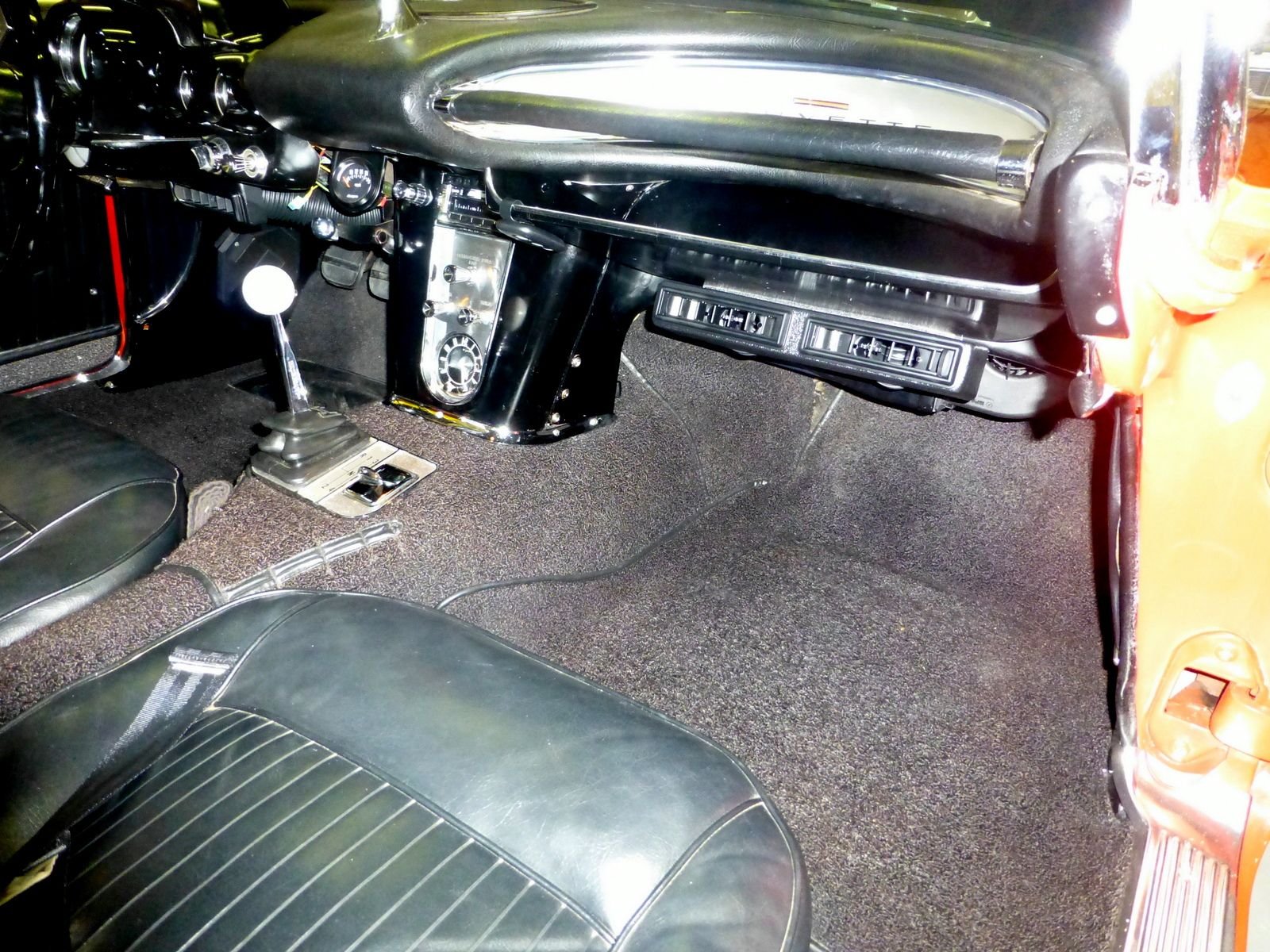

I used Clasic auto air this time. I have installed Vintage air many times. What I wanted was a clean look under the hood and interior. You can see from the pictures it came out very clean. I did not like alot of hoses showing.My is on my 62.

Wow -- without question the nicest underhood A/C install I've seen on a C1. The 'ugliness' is one reason I haven't put it in my '61. I will say I prefer the Vintage Air A/C dash blower look better though. Strictly personal opinion and not a slam on your setup.
Wonder if there is a way to make a hybrid...
