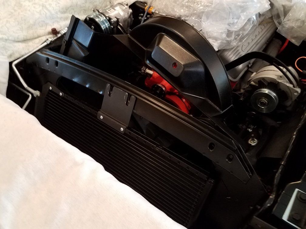

Per Donny Brass's tip "it is not obvious and I suggest you practice putting the shroud in without the radiator", I was practicing doing just that when I realized I could position the shroud to have enough room to side the radiator in without taking the water pump off. I did remove the fan and the fan studs, the belts and horn relay. Hood was already off but I don't think that would be necessary.
As Donny also said "the driver side goes in first, the notch in the shroud clears the A arm, then the pass side rotates into position." I didn't completely rotate the pass side into position. I left it in a high position so I could pull it back to get more clearance. Then I put the pass side of radiator in first and rotated it down into the 2 radiator support cups and it all came together.
The pic above shows the position of shroud just before starting to put pass side of radiator in.
Now it's in ... thanks everyone. John
