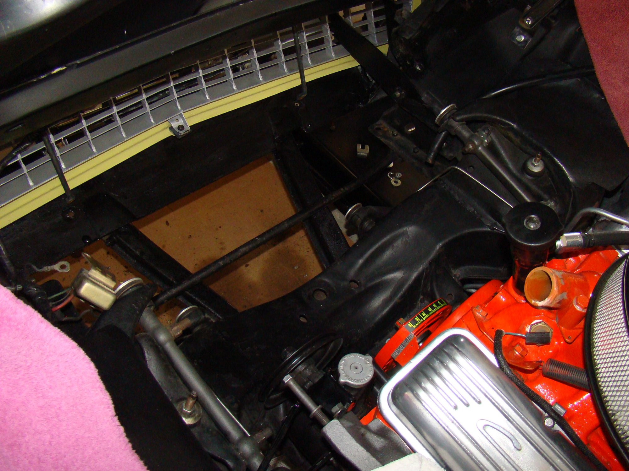

Thanks for the info and recommendations. When I first bought the car in 2000, I pulled the engine and radiator to clean/paint the engine bay and engine. The engine ran great, but pretty much every gasket leaked, so I had the engine on a stand, cleaned and decreased it, painted the block and accessory brackets and put in all new gaskets. The radiator seemed ok at that time so I just flushed it and reinstalled it, but 15 yrs later it needs replacement. I marked the hood bracket location on the hood and they are still visible today, but I think I will leave the hood on at least for now. I can always remove it if I feel I need more room.
