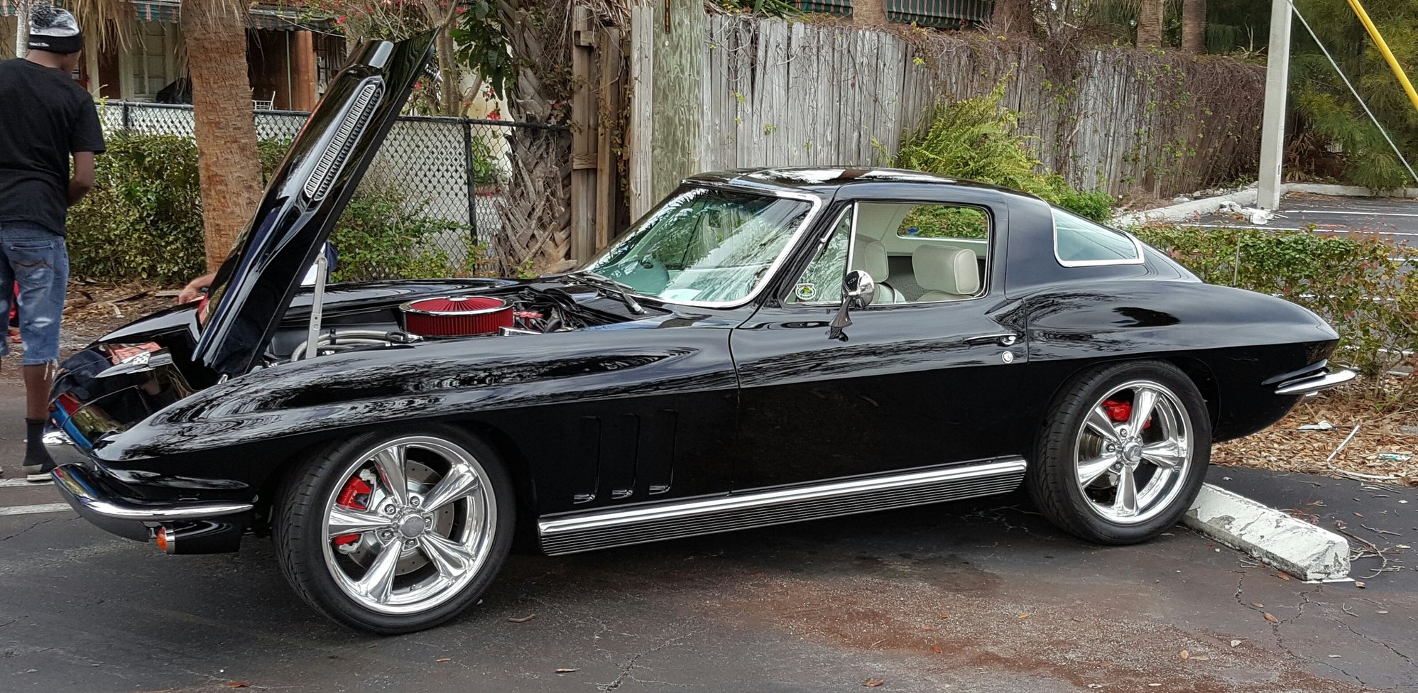

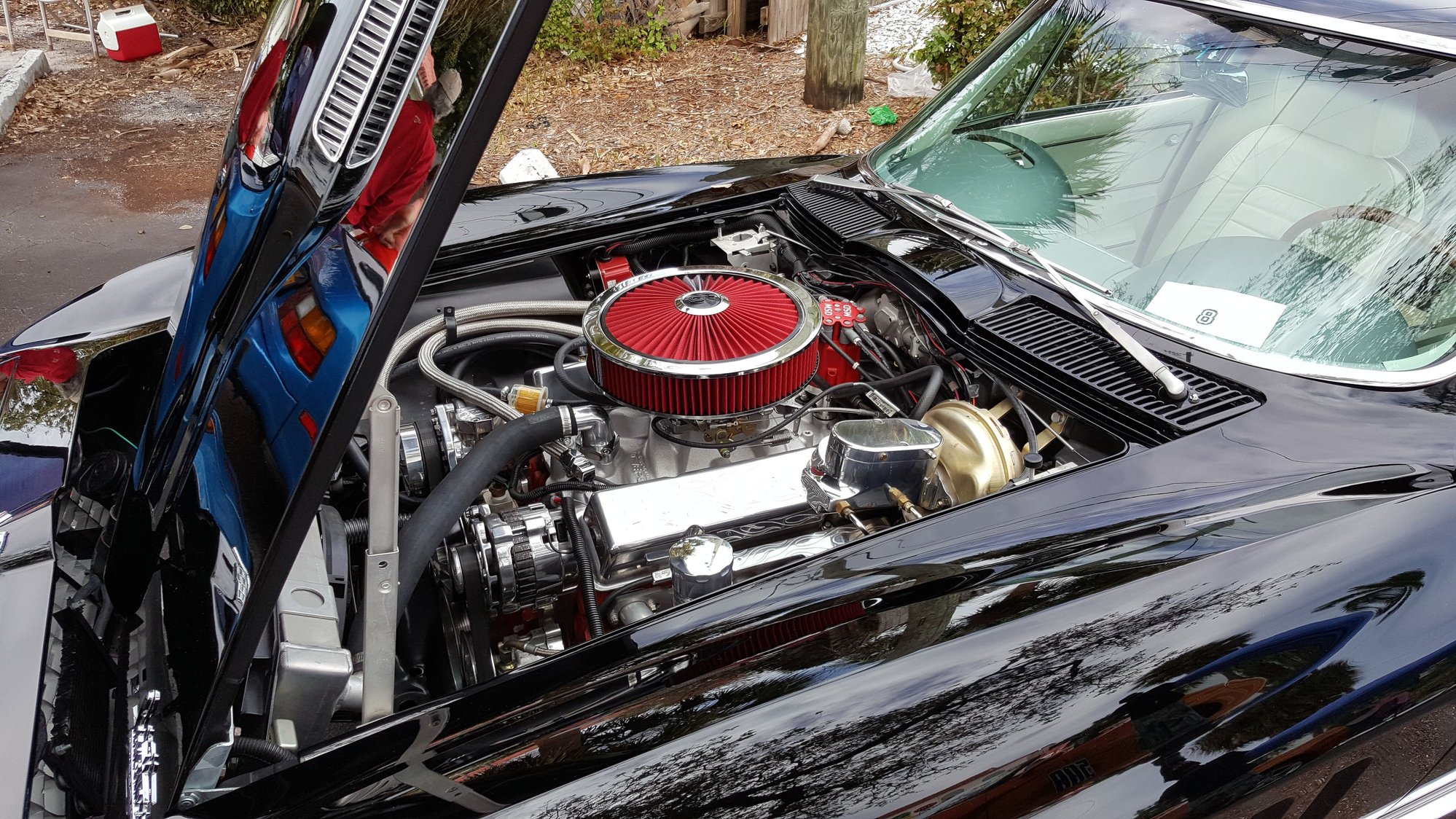

Sorry guys, not sure how to add the year of my car to my Profile picture but my car is a 66 Coupe, Factory AC, PS, PB and PW car with all number matching 327/300 HP and Powerglide, for now! The car had a Holley Stealth Fuel Injection setup on it and because I am going to do an LS swap, I removed the FI and installed an Edlebrook manifold and carb so that I can drive it while I gather all of the parts needed for the LS/TKO600 swap. The car also already had a Billet Specialties Serpentine System with a modern AC unit, C5 front brakes (which are coming off and going to be sold in favor of Wilwood 14" 6 piston brakes) with 18" Billet Specialty wheels etc. So while it is a number matching engine and tranny, the car is not all original.
