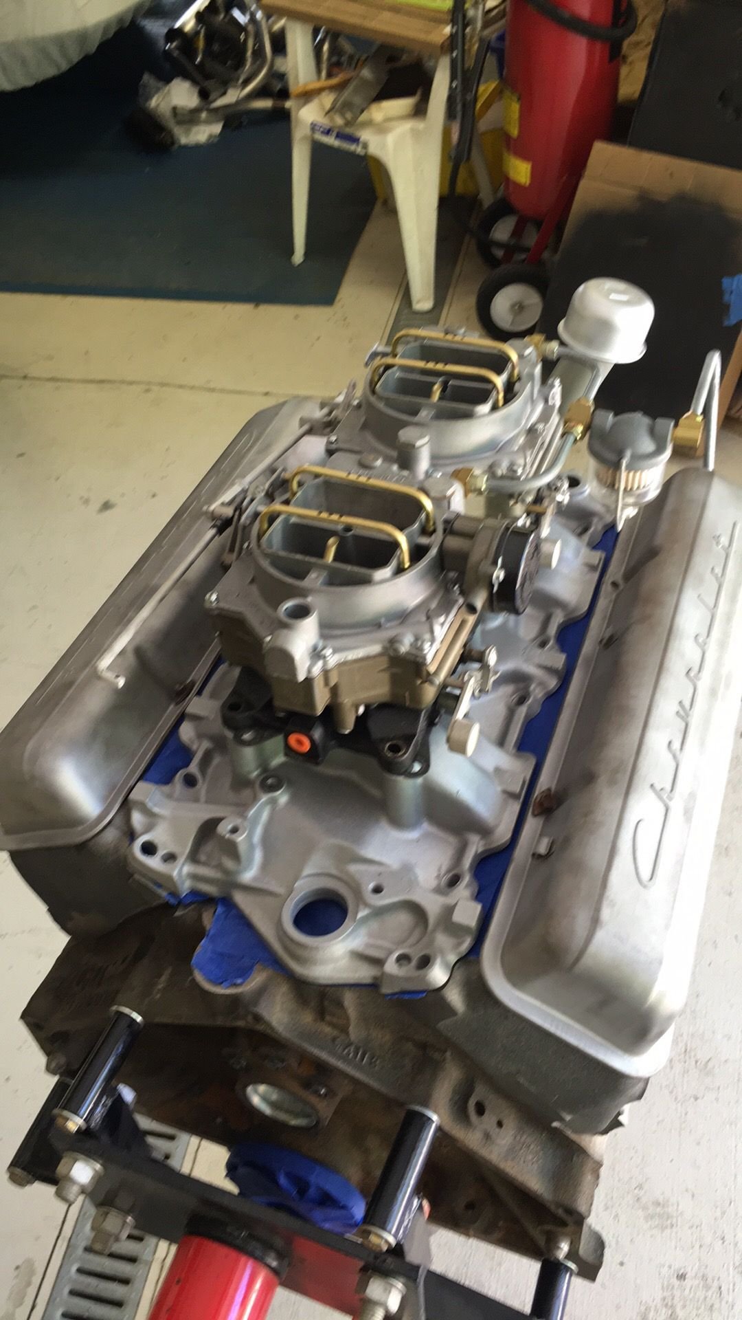

Getting ready to put a coat of paint on it, but just couldn't resist a pic....

Is that a 270 set-up?
They aren't real but they are built to work like a 270 set up.

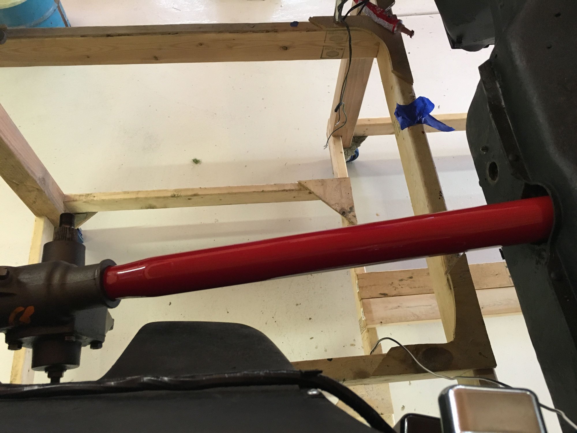

Make sure that you follow the sequence of steps before you do the body drop.
Firewall insulation
Steering column -- As you slide the column through the firewall, slide on the soft and hard seals before putting it through the dash hole.
Install the speedo cable before the body drop
Firewall insulation
Radiator installs AFTER the body drop.
Looking good!
Thanks, the steering column could be a problem. When I pulled it out I heard the shims, rings and other assorted items hit the floor boards. I'm kinda lost but confident...... I've got it ready.

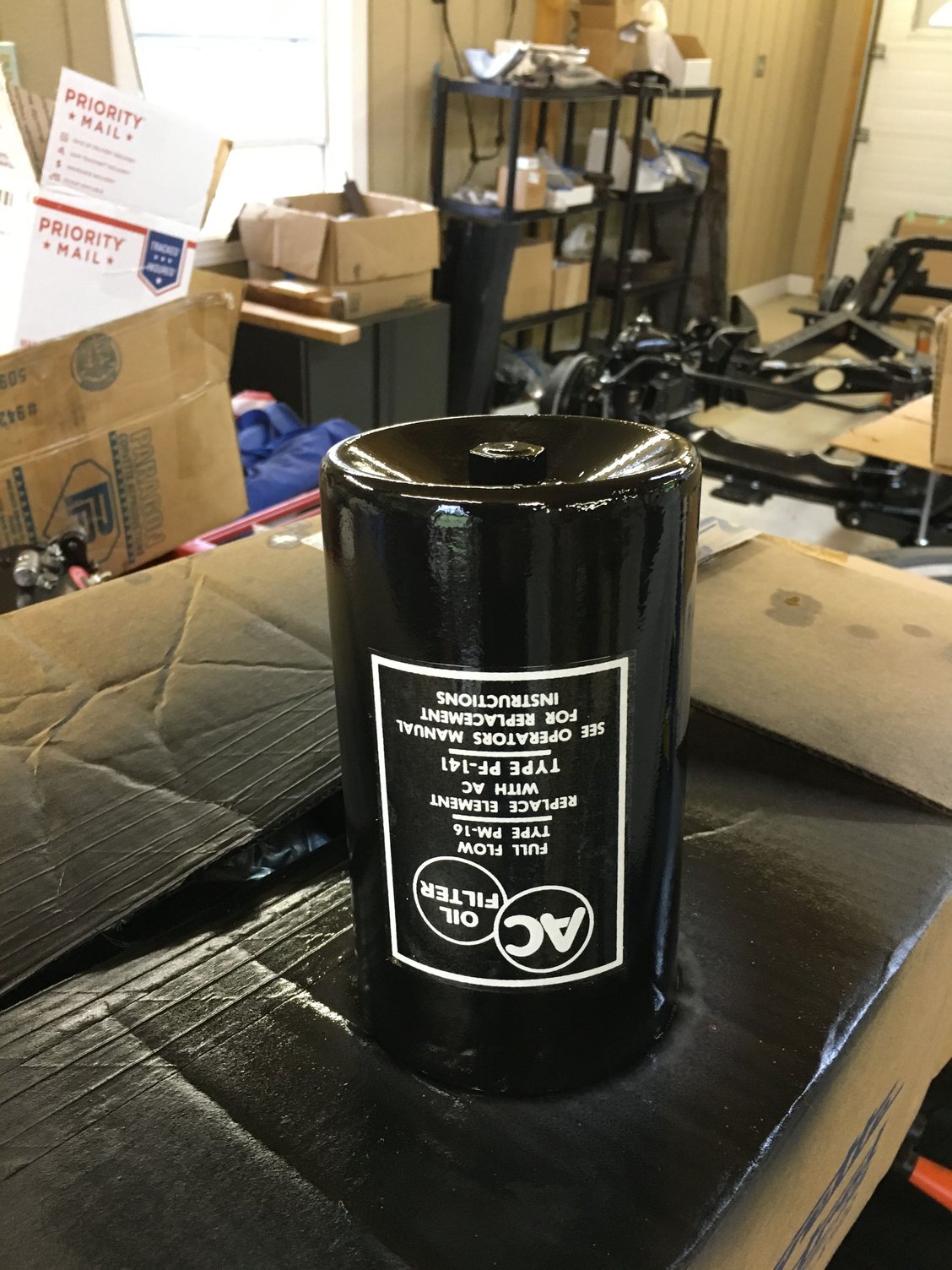

I've been on a roll these last couple days...

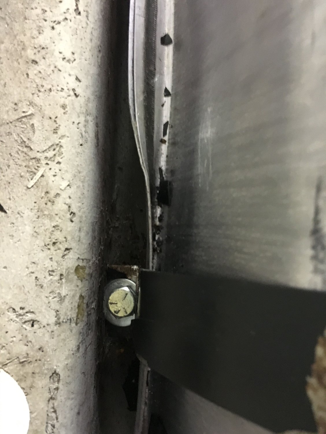

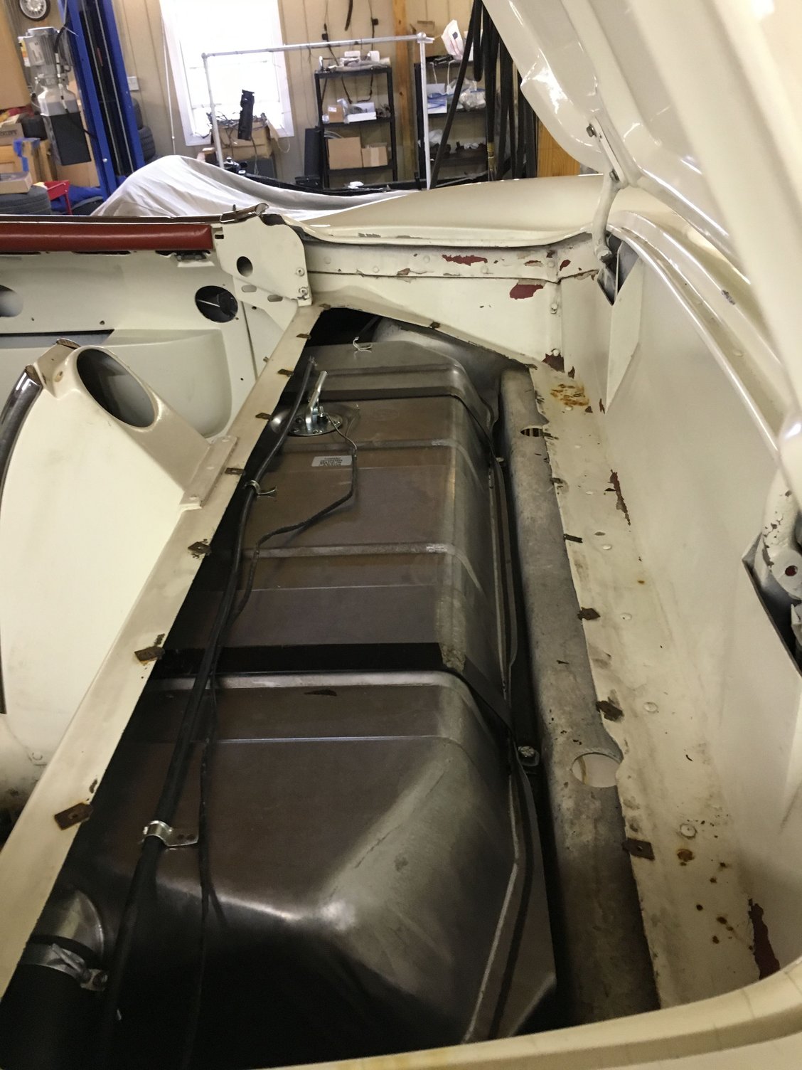

Some pics of current progress. Fuel tank...
It's secure....
Small modification to get it to fit.

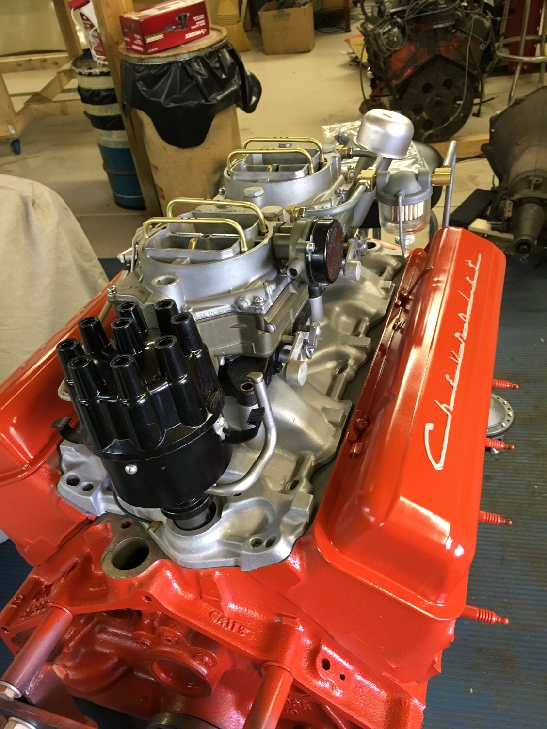

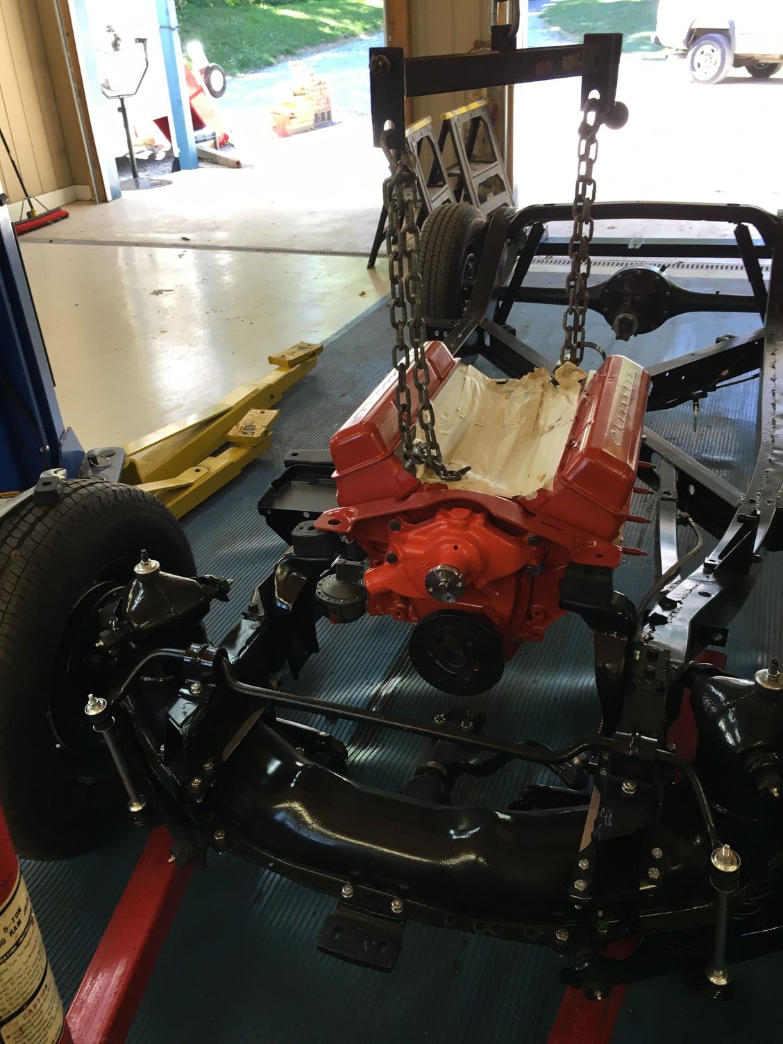

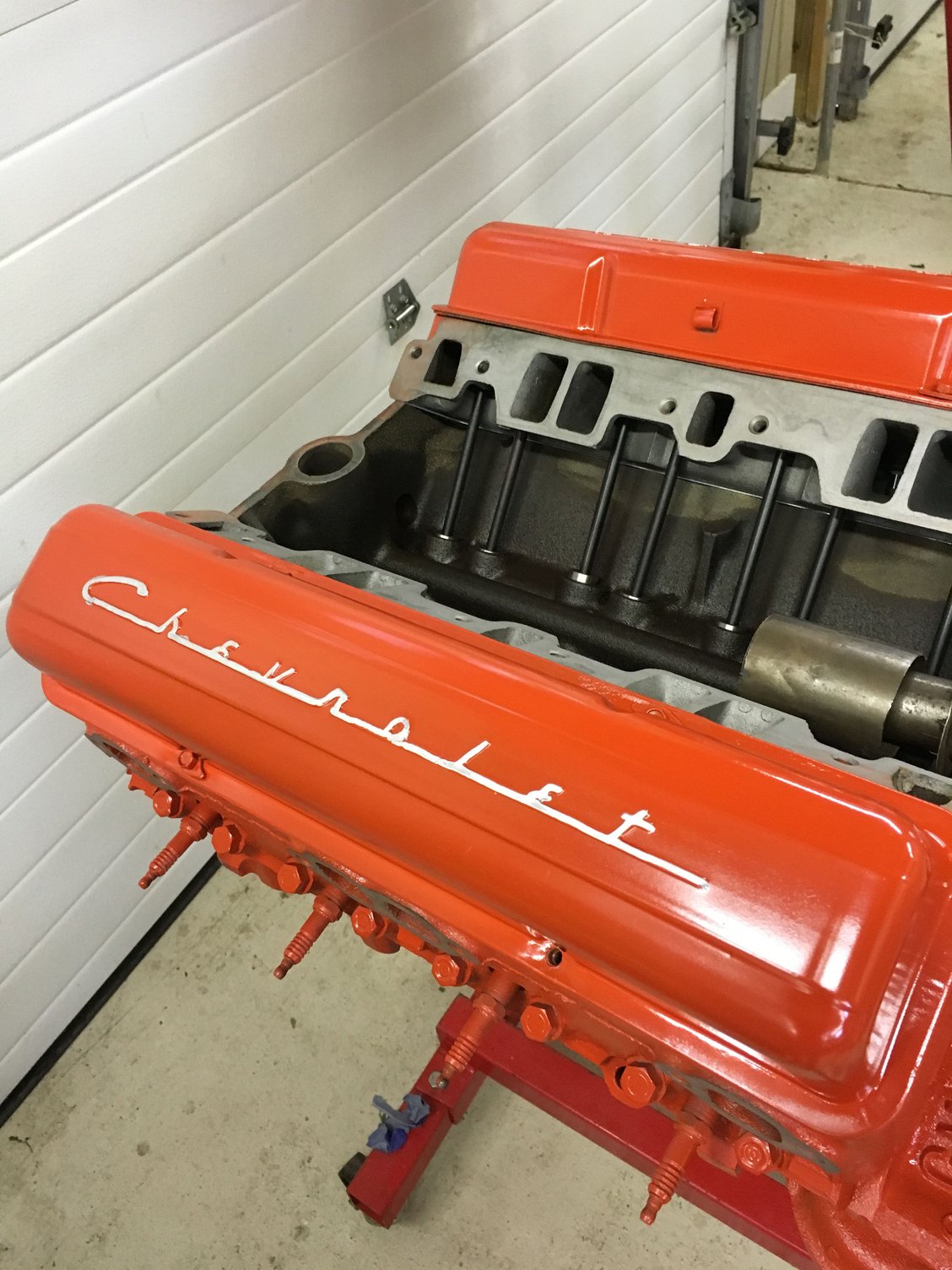

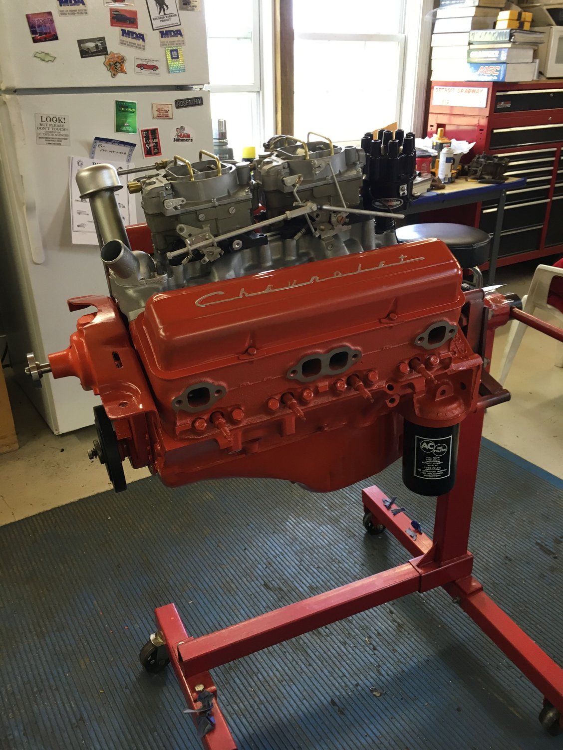

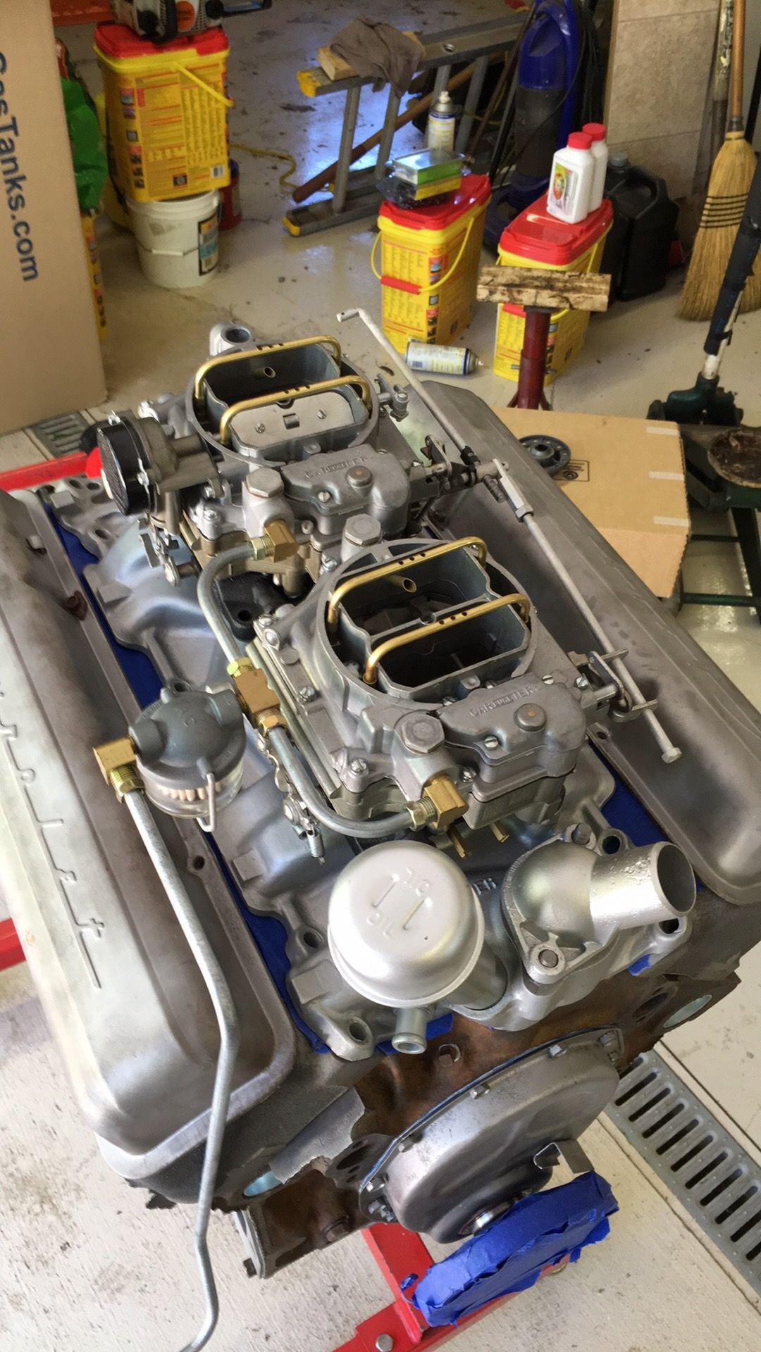

My little 283 is looking good. Getting ready to put in place on the frame, then drop the body .....

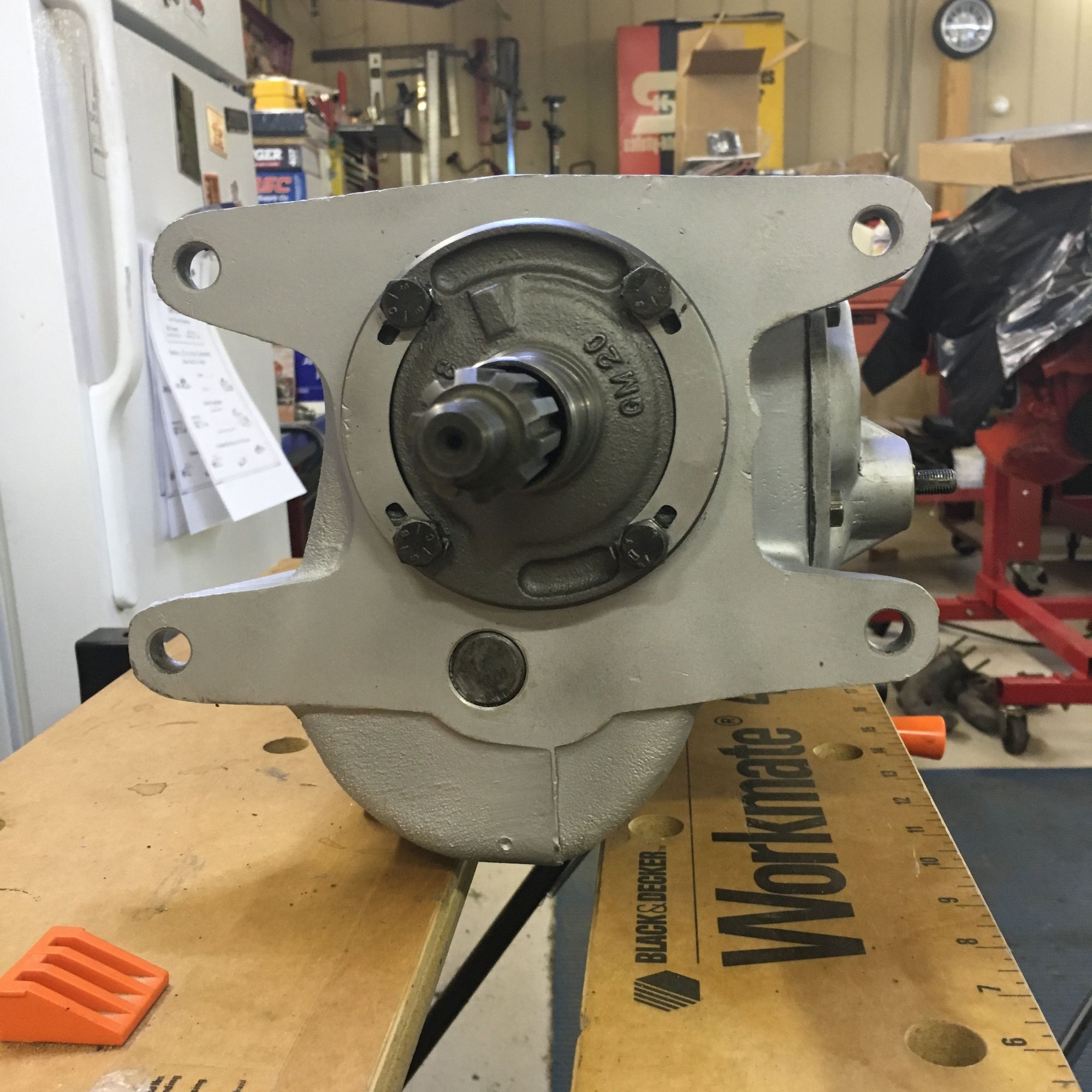

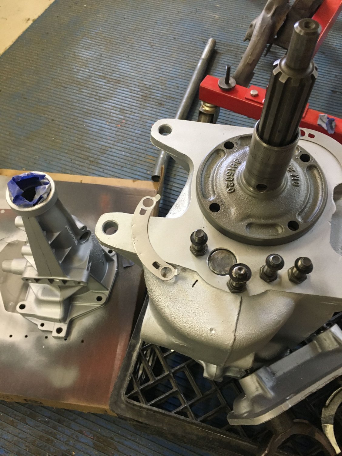

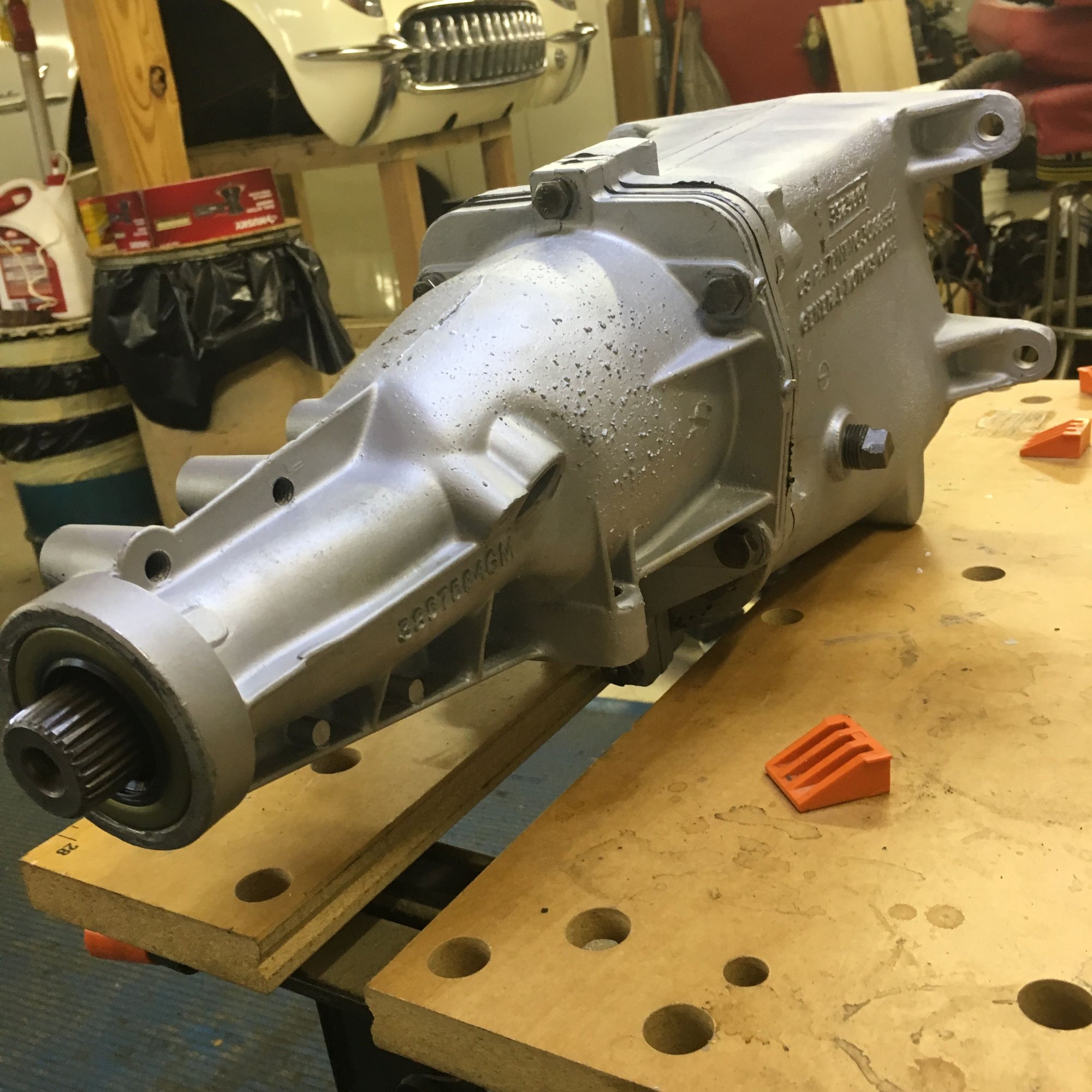

More progress today. Freshining up the Muncie. Gaskets and seals....

Finished the Muncie

Are you planning on using a mechanical fuel pump on the 283? If so, does your frame have the V-8 fuel pump clearance indentation?

Originally Posted by jv04
Very nice build so far. Keep the pictures coming.

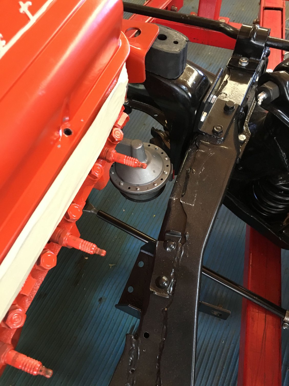

No, I haven't notched the frame.... The car was V-8 powered when I bought it, probably been that way most of its life. The frame was not notched, I'm beginning to rethink my decision not to notch the frame....

  #58
emccomas's Avatar
emccomas
Joined: May 2005
Posts: 31,497
Likes: 1,313
From: Huntsville AL
It may be OK as is. I would suggest installing the engine without the fuel pump, and then see what clearance you have.
I don't know if anyone makes fuel pumps that are physically smaller, but I know that some pumps have bigger dimensions than others.
Great rebuild effort, keep us posted.

Today's progress, steering column....

Yep, I'm going to have to notch the frame. I know, you told me so.......
