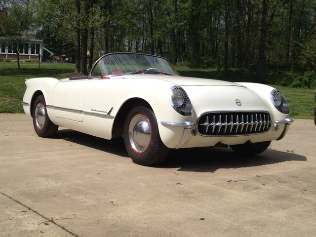

Im consolidating a couple threads. A short recap, where I started up to this point in time.....
