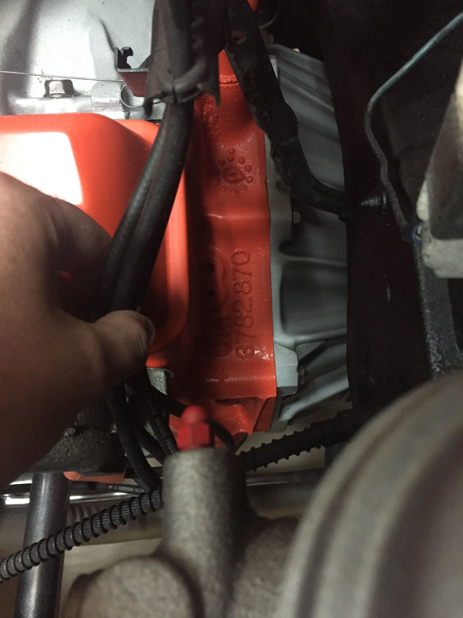

I have a 63 Corvette Split Window and I'm trying to figure out what these numbers mean. The 3782870 number I can find info on but I can't find anything on the other numbers. Any info would be greatly appreciated.
This number near transmission on the driver side

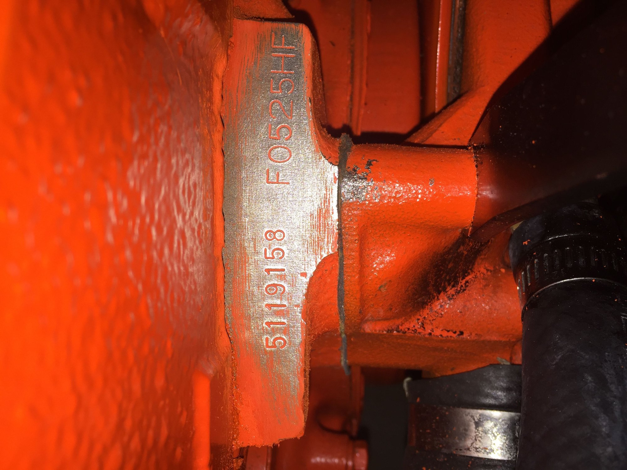

These numbers are in front on the passenger side cylinder head.

The engine came out of a 1965 Corvette with a partial VIN of 19,158. The engine was born a 327/300 HP with manual trans and was assembled on May 25, 1965.

The HF suffix was used in 1965 on the 327 300 hp engine. Also a 3782870 block.
The number to the left would normally indicate the vin derivative in this case the 19,158 th Corvette built that year, 1965 I believe.
Good luck... GUSTO
Looks like Larry beat me to it...

You could list this engine with VIN and photos in the "ORPHAN VIN stamped parts" thread, found in the Sticky section at the top of the main page.
If the owner of that VIN 1965 ran across it, you could make a new friend.
