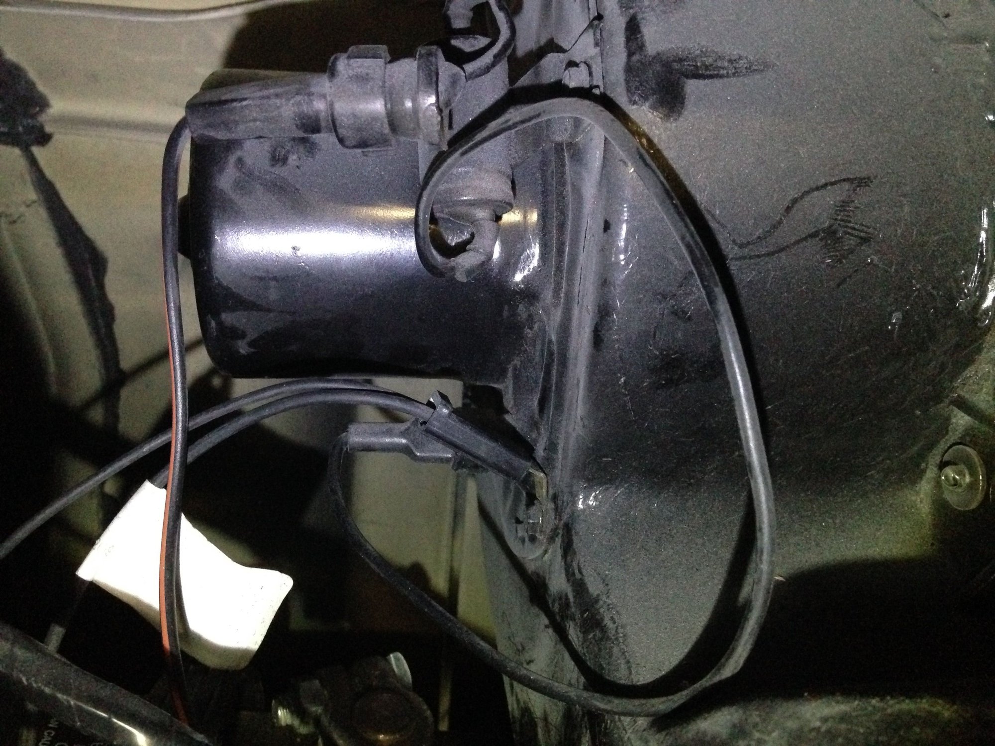

What year? Coupe or Convert? If it is a 64/64 Coupe the exhaust blower in the left wheel area off/on switch maybe in the on position which will remover power to the heater power switch. It prevents the exhaust blower and heater blower being on at the same time.
1965 coupe

The attached PDF has info regarding the rear compartment blower assembly of the 64 and 65 coupes.

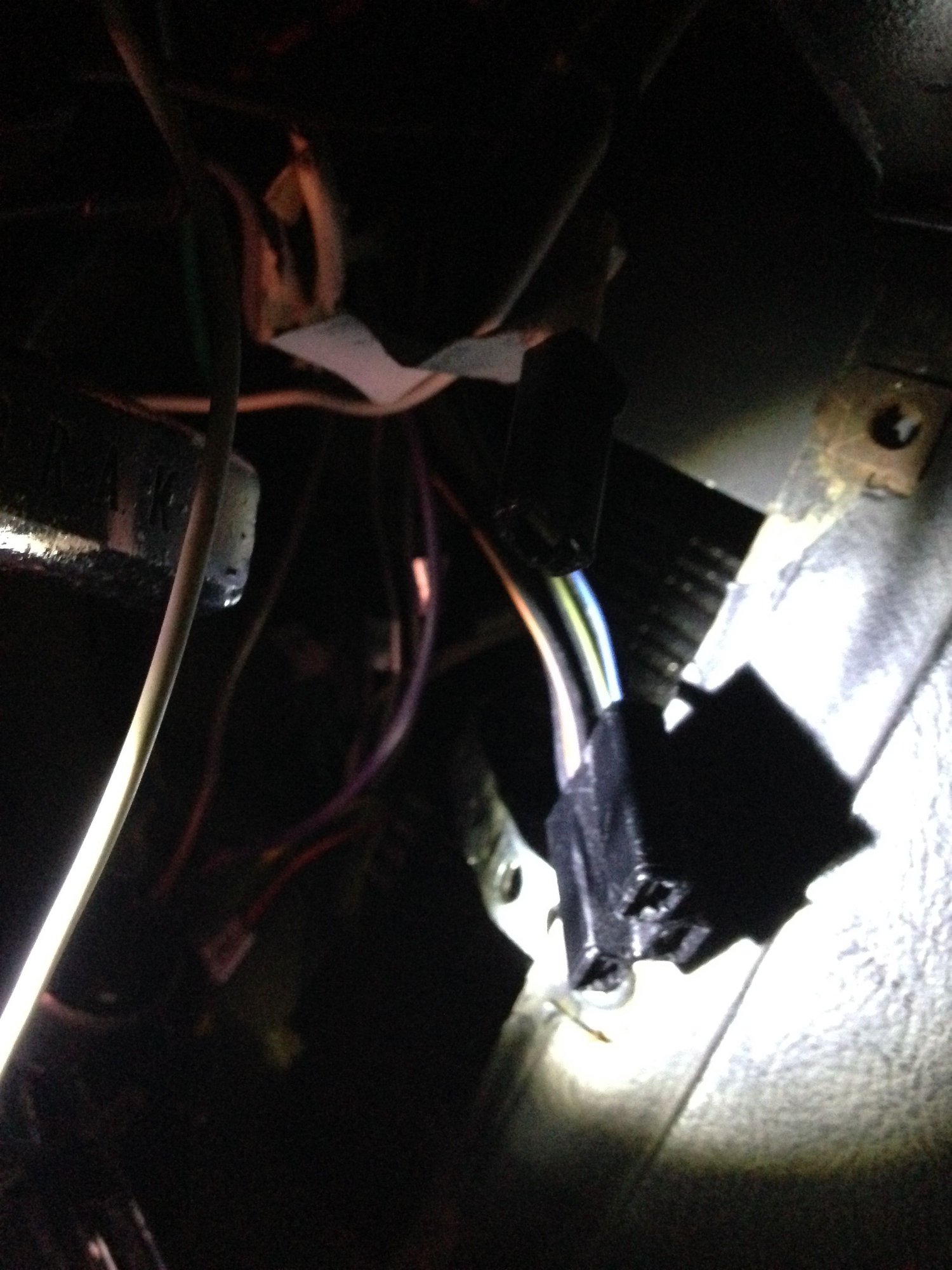

Besides the three terminal connector at the switch, you should have 2 single brown wires. One is power from the fuse box, the other goes to the rear blower.
No 12volt to any wires on blower in rear compartment or at heater motor switch or at heater motor!
So 2 browns, where does the power from the fuse box attach?
I think that you got the answer, the brown wire from the fuse goes to the switch. I had lost that connection. I will check it out.
