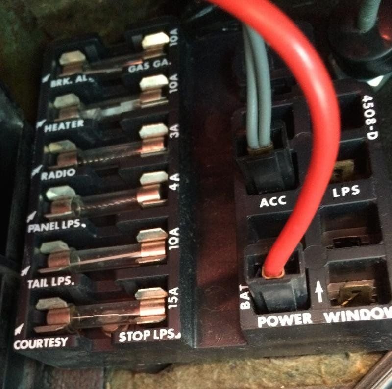

Here's a clearer picture of a 65 fuse panel, shows 15amp, but mine was marked on the panel 20a.
