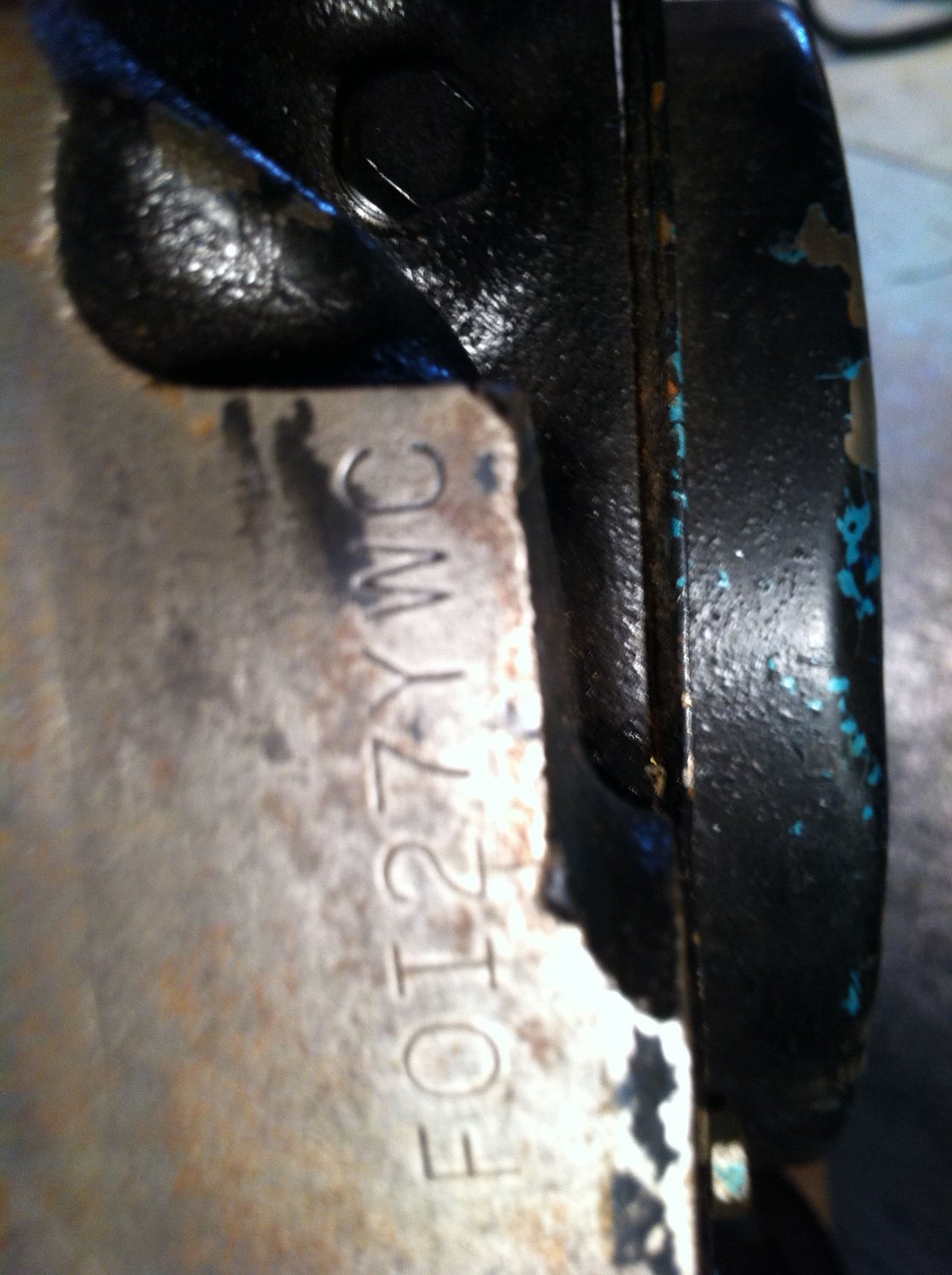

Good morning all
I have just purchased a 1964 coupe still getting safetied . It has a 350 in it at the moment with a Hurst shifter. Otherwise it seems to be original. It came with an extra 327 as well
I am confused with the stamping #s They are definitely (checked 10 times) F0127YWC
the casting #s are 14 GM 3858174 these are no problem. Its the stamping that I cannot figure out.
Could anyone shed some light Please
Thx
Ken

can you post a clear picture. YWC is not a valid suffix code. WC was used from 66-68 in trucks but C could stand for a carter carb as well. so can you also get the date code from the block its on the opposite side of the casting number

Here is my first try at a pic hope it works thx

pictures worked. but the casting date is going to be close to where you got that last picture of the casting clock

I am having trouble with the F0127YWC
its the YWC that seems weird I appreciate your thoughts

That was cast on January 24, 1966 for a 66 model year car But the suffix code is throwing me for a loop. As YWC is not in my book of codes. But YW is as a 67 427 truck block. But this block is not that. If the W is upside down and should be a M that could was used in 67-68 as a 327 used in trucks. But the casting date says that's not it. If the W was a mistake a YC is the code that would make sense as that was used from 66-69 as a 327 truck block. So I'm not sure the original use.

I see an inquiry on an automotive site asking about stamping Fo316YWC from 2010 in a #174. Baffled by suffix.Was told it was a 307 but others said no. He never got an answer...

If I was to guess I would say it's a factory error. And since its most likely a truck block it has not been given much thought or research unlike a error made for a Corvette block.

This is what i found..."NO YWC" ...
WC 1967
283
tur hydro 175 2 C-20 to 35
WC 1968
307
m/t, 3 spd - 200 2 C-10 to 35
AND
YC 1966
327
m/t, A.I.R. - 220 4 C-10 to 25
YC 1968
327
m/t, A.I.R. - 240 4 C-10 to 25
BIG BLOCK...
YC 1969 Truck 366 235 L-41 60

Yeah, like everyone else, I could not find YWC. I did see a listing for YC, which showed a 1966 327, I think for a truck, with 220 hp. Interesting that the date lines up.
