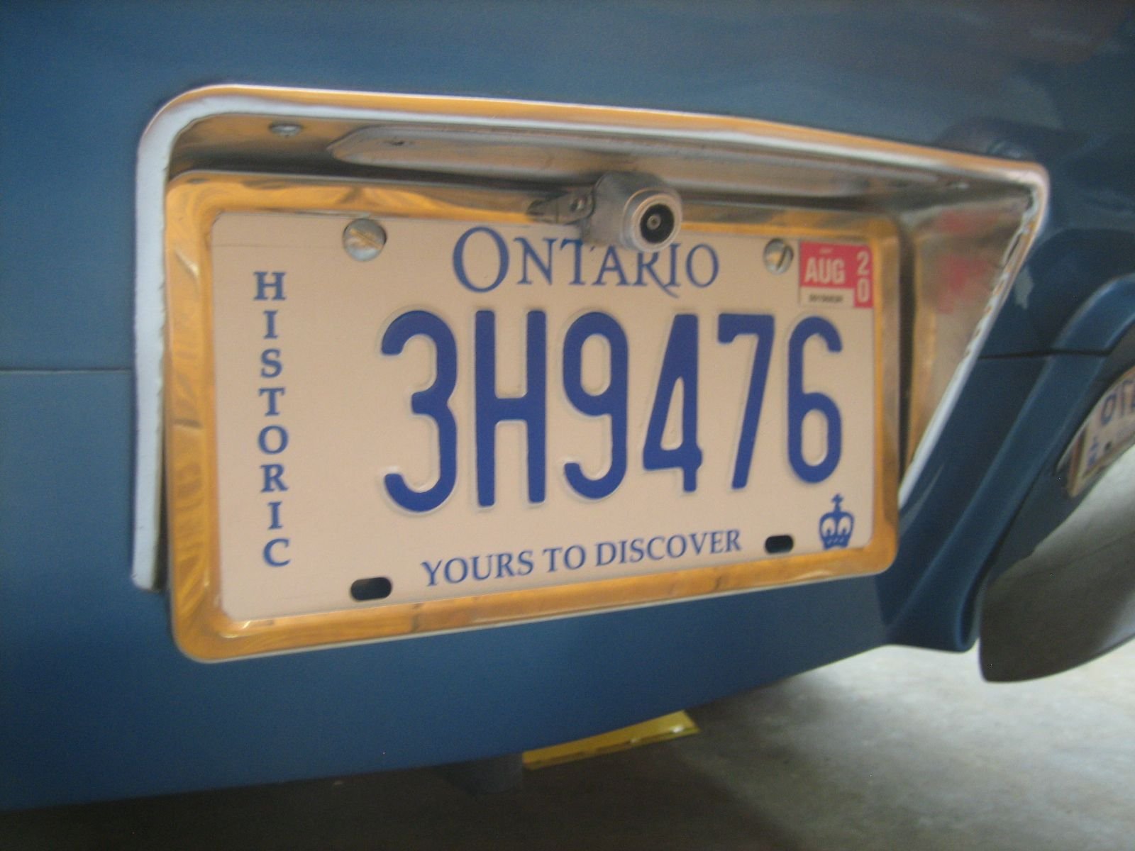

I'm gonna revive this 5 yr old thread cause its the only one I could find on back-up cameras and I've had a couple people ask me to share my back-up camera on my 66 roadster. The thread shows Frankie's solution the he added to his 63 SWC. So I'll try to be brief with a few pics.
Equipment I used was an old 4.5" Garmin Nuvi GPS. I think the model is 2407 which has long been discontinued probably 10 yrs ago. I like this model because it came with lifetime map updates and its easy to use and pair with your phone and a backup camera via blue tooth. I wanted to make the GPS screen "blend in" a bit so I painted it with bright blue interior dye paint to match my interior. For the camera part, I bought a wireless Garmin BC30 which easily paired to my Nuvi GPS.
The GPS unit is suction-cupped to the windshield so it rests on the front of the speaker grill. It powers up automatically with the key on. I tapped into a switched 12v wire behind the dash and ran the plug up beside the defroster vent and out the speaker grill, so the wire is nearly impossible to see even when looking thru the windshield from outside. Yet if you want to take it to your computer to update the maps, just release the suction cup and you can reach behind and unplug the power wire.
The camera came black which I painted with chrome spray paint to make it blend in better mounted above my license plate. The wiring for it is behind with all the tail light wiring. To power the camera at the right time, I wired it to one of my reverse lights, so when I shift into reverse, the backup lights come on and so does the camera. When the camera is on, it wirelessly shoots the signal via bluetooth to the GPS screen on the dash and takes priority over the map view on the screen. As soon as you shift out of reverse, the camera shuts off, the bluetooth signal drops and the GPS screen returns to the map view. You can adjust the grid lines in the camera view as part of your setup. If I recall it also buzzes an alarm signal if the distance between the camera and the closest object is too close.
If you don't have a GPS you want to leave in your car (nobody steals these things anymore), you could get any bluetooth camera that will communicate with your cell phone like Frankie did on his 63 SWC. All you need really is a clamshell holder or something similar. This would make the job quite easy as you only need to mount and wire up your camera. Hopefully this is easy to understand. Cheers, Bill
