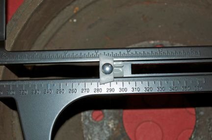

You should also have a drum brake gauge. It the drum becomes too large you could actually lose your brakes. It's not common but it could happen.
A lot of these drums are really old. Measure them.
