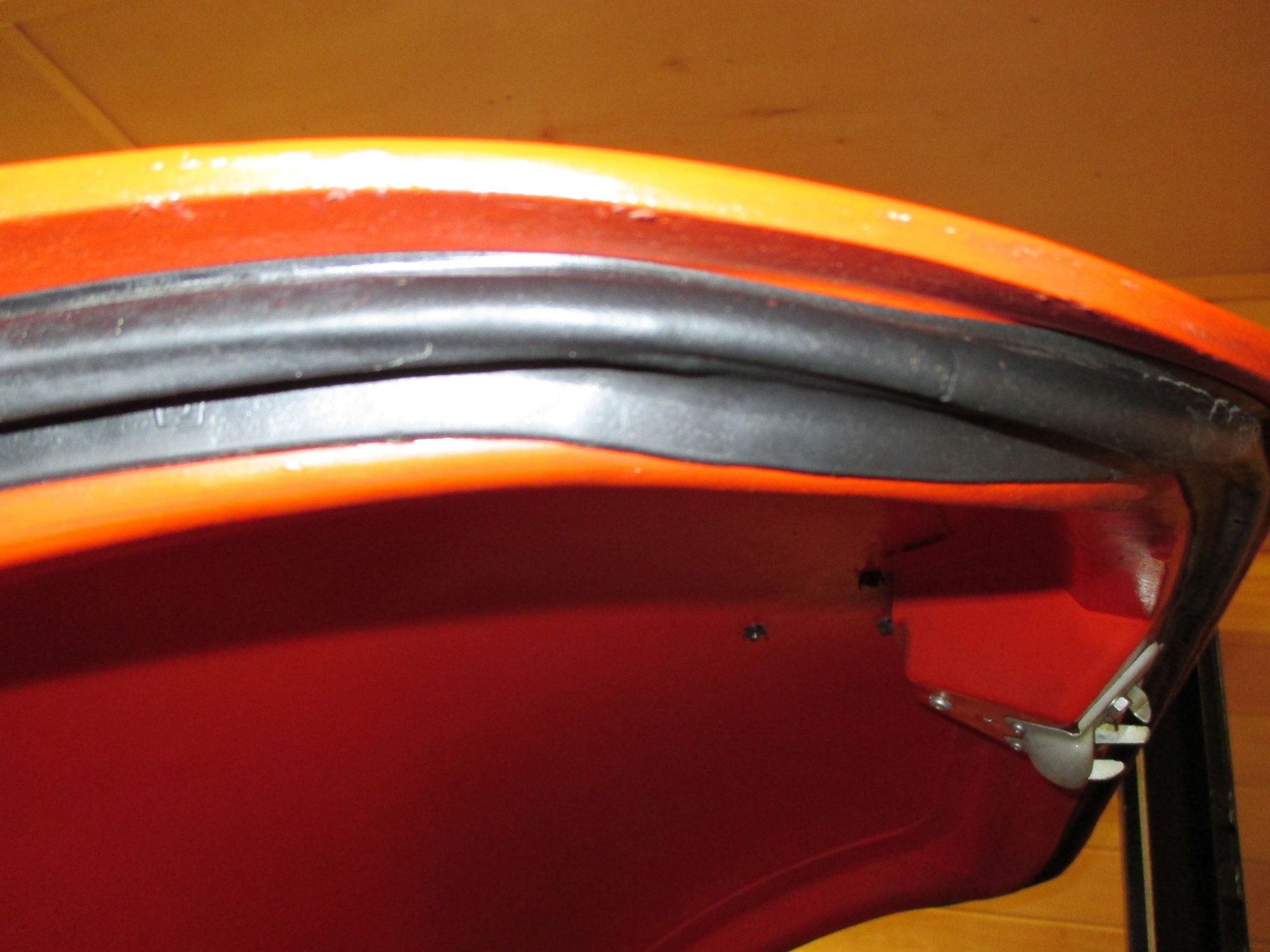

These photos are from an original 27K mile car with the original w/s in tact. Study them closely because they aren't the best angles for you, but hopefully they will help you.

Yes , Thank you . It does look like the wide part gets glued down to the trunk lid side . If we are looking at something original . Maybe someone will have some more pictures . I will wait a while before install . Thanks again.

Look at the first picture, lay your weatherstrip into the gutter in the same configuration and you will clearly see the correct positioning.
OK Panama Thanks . I will install it tomorrow morning . The deck lid weatherstrip looks like the same deal .
