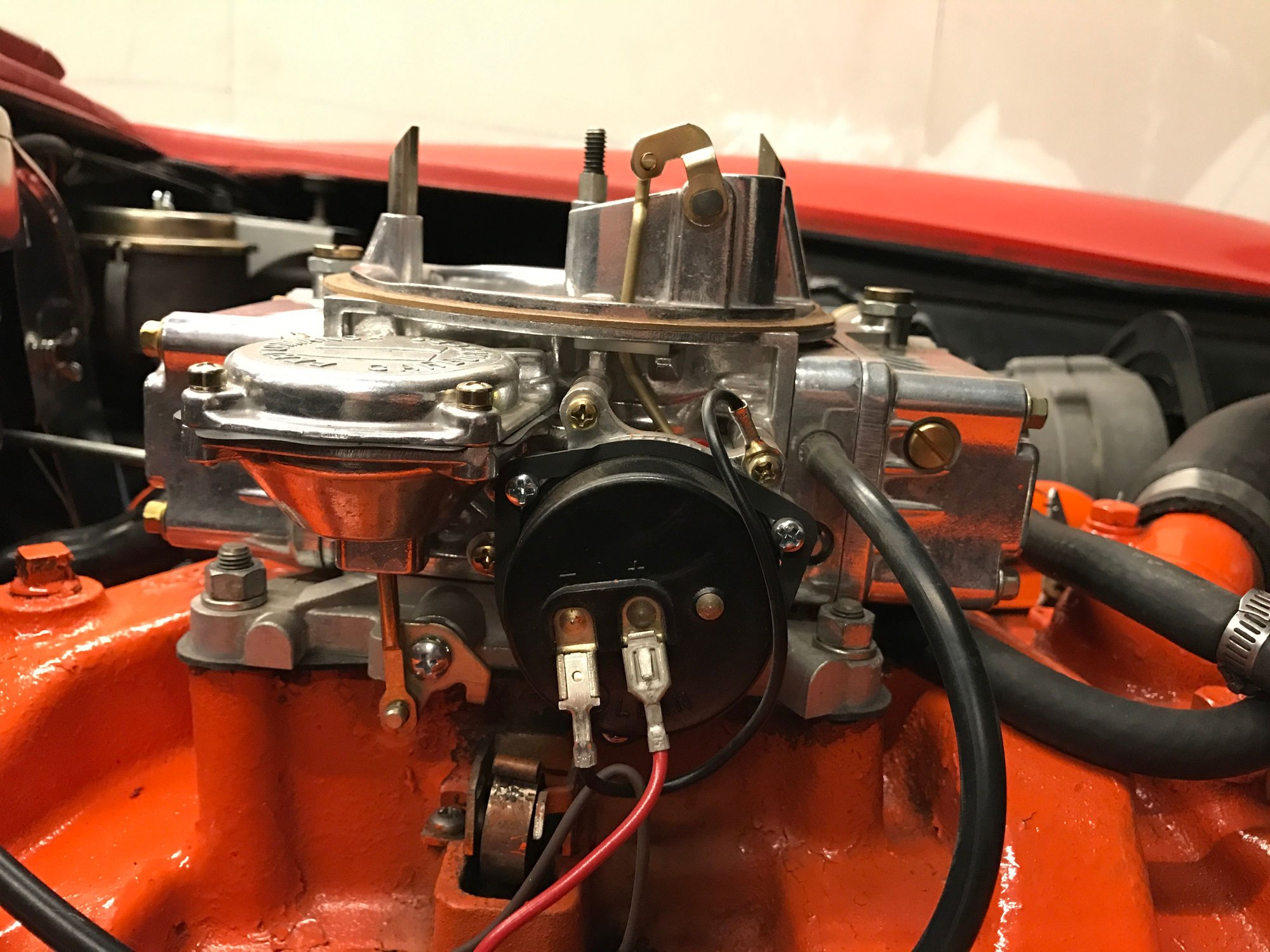

Wonder what they mean by this is a wrong good place.
I read that one as well and also made me thinking that must be a special kind of port it can be good and wrong at the same time

You need to hook your hose to the "wrong good place" to operate your vacuum advance. If your hose is hooked to the port shown, it very likely could be part of your problem.
If you ever get around to checking your timing with a timing light, make sure the hose is disconnected and the port blocked. Also be aware that many people seem to mix timing covers with balancers so you need to make sure your TDC mark is really TDC on the piston.

You have connected to ported vacuum as MikeM indicated. That is above the throttle plates and you are losing all of the advantages of full manifold vacuum at idle such as smoother idling and cooler temps. Here is a Quick Fuel carb (sorta of a Holley clone) on my '67 Chevelle SS-396 and you can see where I drew the vacuum from (red arrow). You can "T" a vacuum fitting off this port to read full manifold vacuum...
That labeled drawing with the "good" and "bad" text labels you shared is bad itself...
Or who wrote that had no clue about carbs
okay tomorrow the hose is going there and I will "T" it and give a new vacuum reading

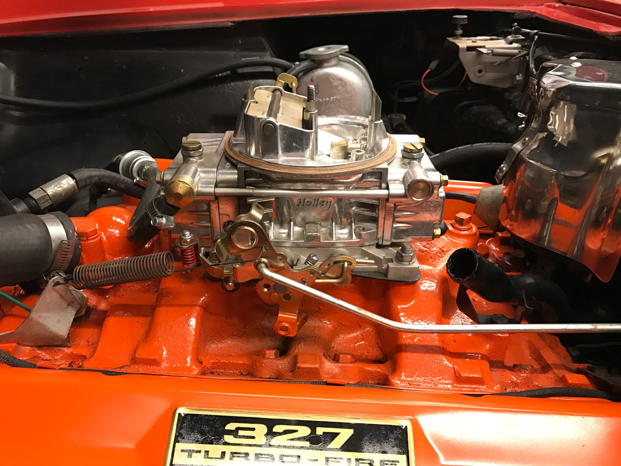

Here are pics of the carb
And I used the port with the metal plug in the manifold to measure vac
As I questioned on back on post 21 - you do have it hooked up to ported vacuum and if you are getting 9 inches vacuum at idle you have a carb adjustment or function issue as it should be close to or 0 vacuum.
Are you familiar with the transfer slots in the primary throat of the carb that are down by the throttle butterflies? At idle setting - choke off - where does the throttle plate set on those transfer slots? There should be somewhere around 1/3 of the slot visibly exposed. A picture down the throat showing them would help.
Actually - going back to your original question
"Some of you have read my previous thread about the fact my car idles to low and hesitates at gentle acceleration, so I bought a vacuum gauge and hooked it up to the intake manifold today. At rpm 800 I got a reading of 9 hg"
Regardless of why you have 9" vacuum at idle on a ported outlet, changing it over to the lower base plate - full vacuum port - will probably solve the issue of slow idle and hesitation by bringing in additional timing by the vacuum advance. You need to either tee off of the hose on the lower port or put a nipple in on the manifold port block off bolt. That should bring your vacuum advance in and increase your idle speed. It may increase idle speed enough that it's too high and you have to back off the curb idle setting to lower idle speed - which in turn could solve the 9 inches ported vacuum reading at idle.

If he was 'chasing' a good idle and got the throttle plates cracked open a bit then the vacuum starts kicking in. Personally, I'd write the 9" off and concentrate on setting up the correct full manifold vacuum tweaks...
In post #23, OP states:
"And I used the port with the metal plug in the manifold to measure vac"

As 65tripleblack stated I did use full manifold vacuum so not ported, ans as frankie mentioned I am going to focus on getting vacuum advance to manifold connected and tuning it, after that see how it runs and what vacuum I have.
For now I am desperately waiting for a little dry weather.
