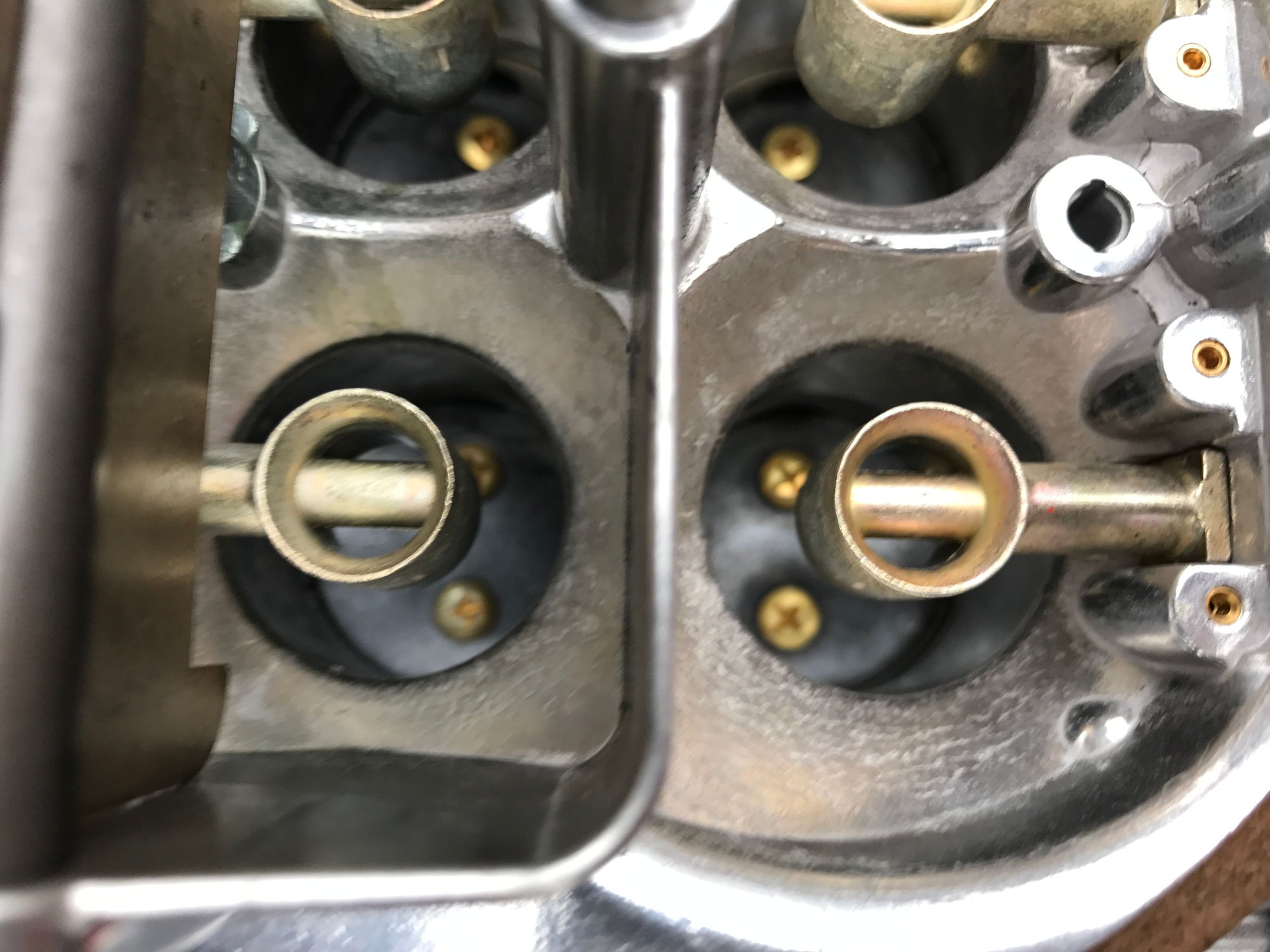

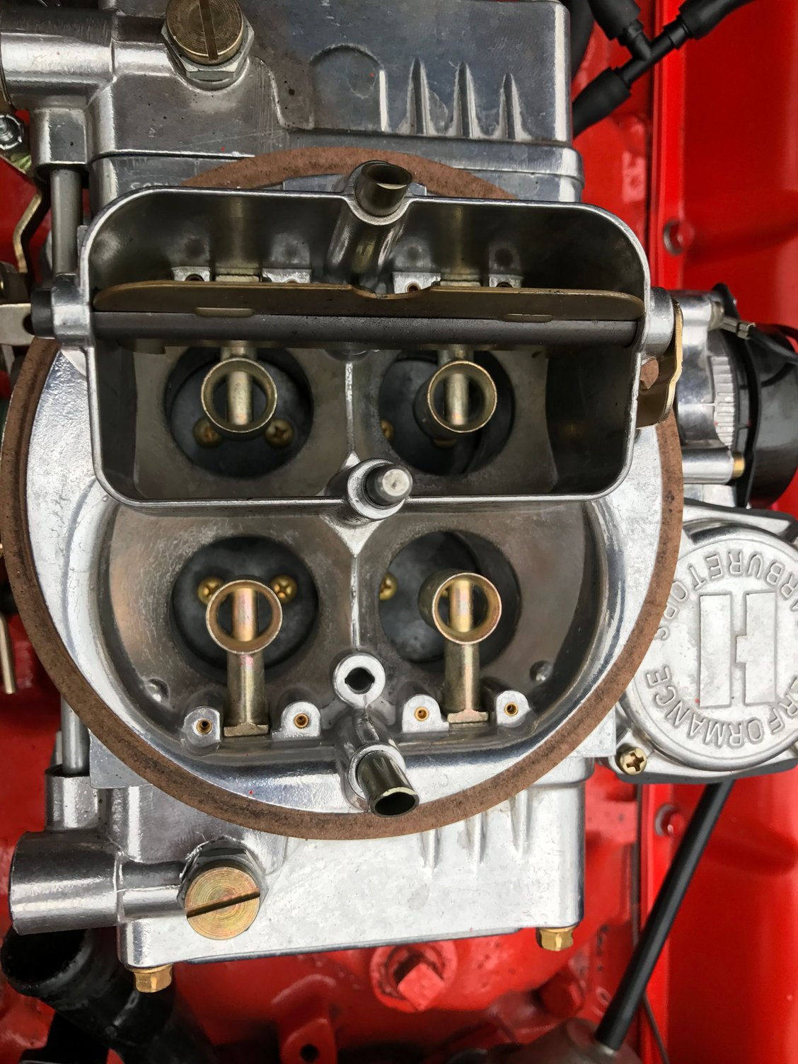

  #80
Twan Sloot's Avatar
Twan Sloot
Joined: Jul 2016
Posts: 769
Likes: 123
From: Heerde Gelderland
Oh btw someone asked if I could post a pic from looking into the carb, I don't know if it is still needed but here is a pic from the carb while running 800 rpm at idle
