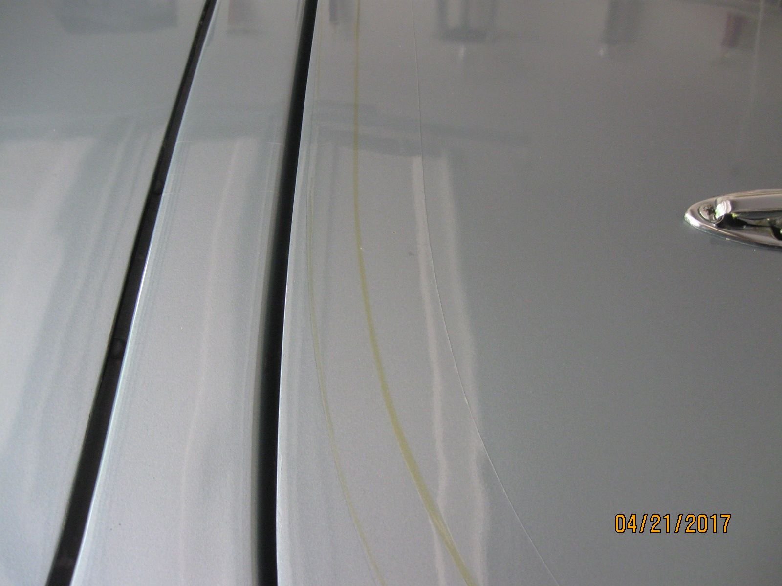

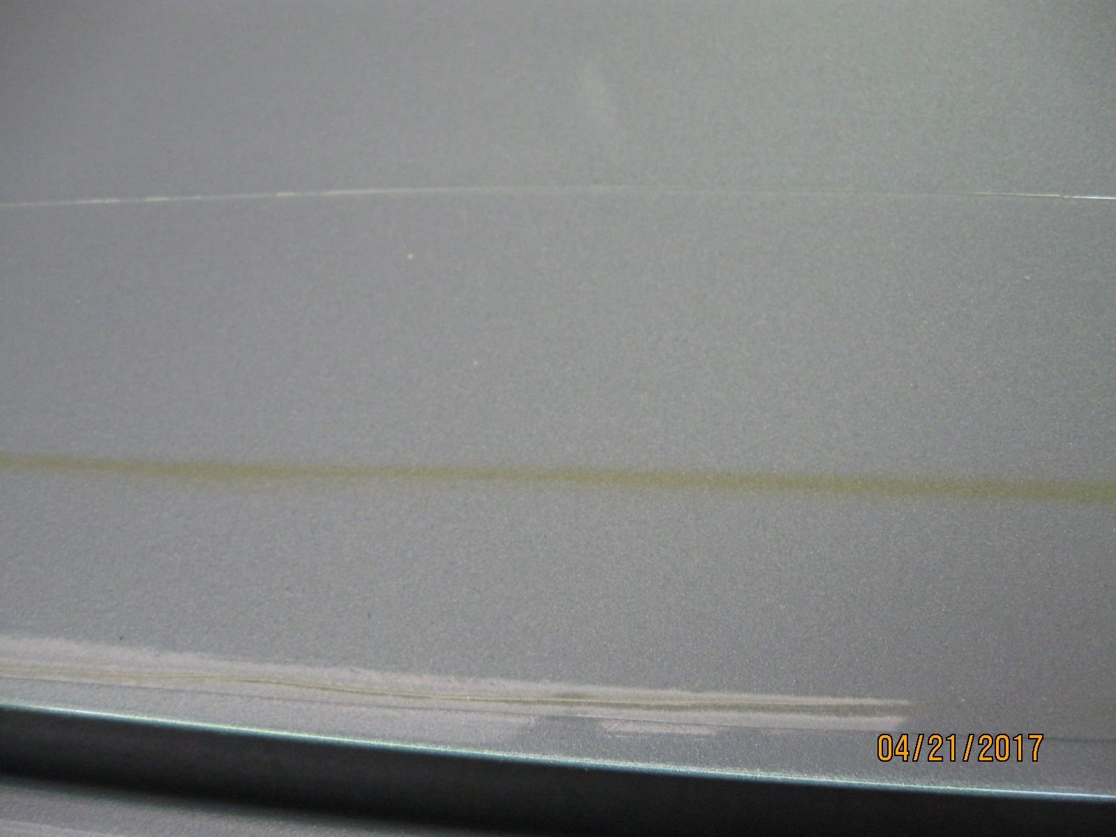

I don't know if anyone of you have used this product before or not but thought it worth mentioning. It's called Rapid Tac and the first time I used it was applying decals to garden tractors I restored so when my clear vinyl protector for the hardtop came up at 60 mph, I decided to give it a try.
I called the manufacturer first to make sure it wouldn't harm the paint and he said it was very safe to use, it's not an adhesive. You clean the surface first using this product and paper towels. Then spray the deck lid and the vinyl where you're going to apply it. The nice thing about this is it slides around so you can position it wherever you want it. Then squeege out all the liquid and air bubbles. Dry using paper towels. When it's completely dry, it sticks very well and since there are no air bubbles, it won't come back up. At least it didn't after an hour drive at 65 mph. According to Rapid Tac, If you do want to remove it, just get your fingernail under on end and pull up.
