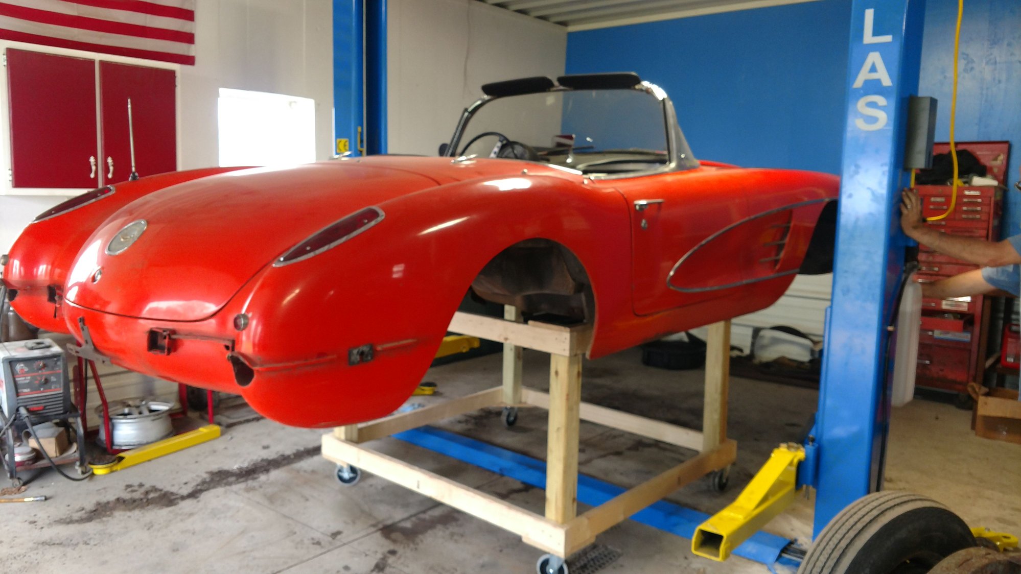

Got the body off the 59 and am ready to clean. What is a good product to use that is safe to clean 50 years of road grime and grease. Thanks.

Wish I could pressure wash, but there is no way to roll it outside. No concrete drive and a large drop off. So I guess I'll start scraping and try some of these suggestions. I do appreciate all this forum has to offer!
