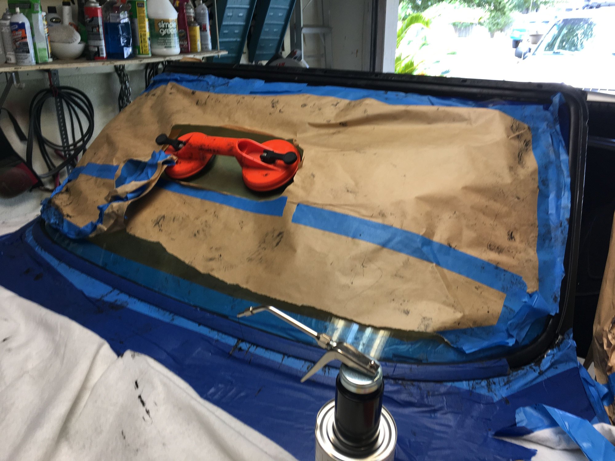

Lots of tape

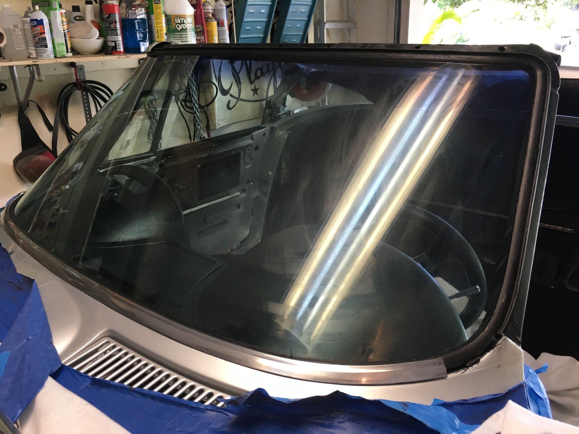

Installed and sealed.
I straight up conquered this thing!
Not too bad of a job. Masking is a very good idea.
I put the lower molding on before shooting sealant between glass and windshield. If I were to do it again, I'd seal it first THEN install lower trim.

NICE JOB!!!
YEAH...I know all about the CLR stuff GETTING EVERYWHERE...but if it seals it up so I do not get water leaks...it is well worth it.
NICE JOB once again and I am glad to read that you conquered it and not give up on it.
DUB

3M 8984 will dissolve the sealant.
DUB
I'm using Toulene - seems to work pretty well and is much cheaper.

What kind of sealer did you use? I saw Dub mentioned CLR before, but I'm not familiar with that one. Is it similar to 3M's Bedding & Glazing compound?
It is similar but stays goopy.
There are two different kinds
7708
1716
Crazy stuff. Messy. Sticky. Tastes terrible.
