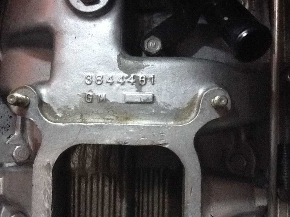

Someone modified the intake manifold on my 65 327 365hp. They cut open the entire carb opening. Does this have an effect on performance?

yes it does, if I remember correctly it decreases low end and increases extreme high end...
a better idea that wasn't a good idea to begin with...

Not the end of the world ! It takes some torque away from the bottom and puts some hp up top. Still driveable.

sad part is, unless the car is geared right, the 365 is a bit shy on low end to start with....
