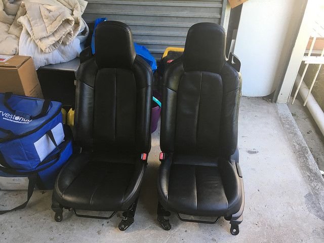

I am literally in the middle of the process of putting 3rd Gen Miata seats in my 64. I mounted the driver side and took my first drive yesterday. They are from an 06 or 07 Miata I believe, I got them from a wreck used as a race car and paid 2 crates of beer for them !
I will do a writeup in my build thread, but the install is relatively easy, the brackets can be removed by drilling a small spot weld and a rivet on each one. I made new feet to adapt and attached to rails, the width, height and slide function work great in the C2. The style is simple enough to pass, maybe not period correct, but I dont think they look terribly out of place.
I like them as they have an integrated guide for use with the seatbeltsolutions 3 point kit, seems it will all work out nice.
I am 5'10" and 200lbs and I dont think they would be great for a much larger driver than that, but they stick to me like glue, totally transforms they feeling behind the wheel !
