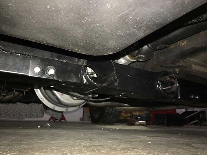

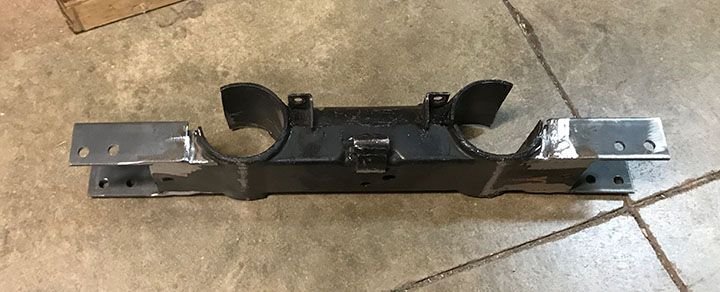

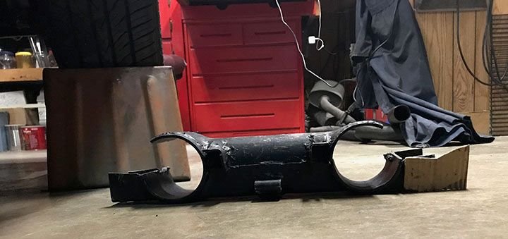

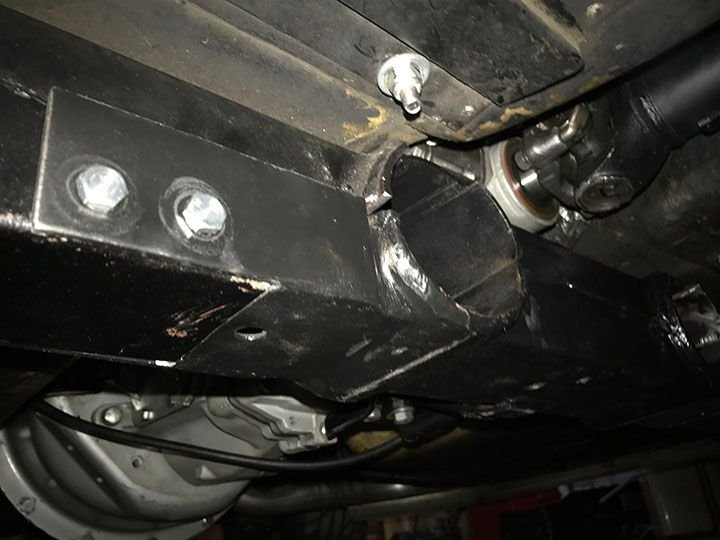

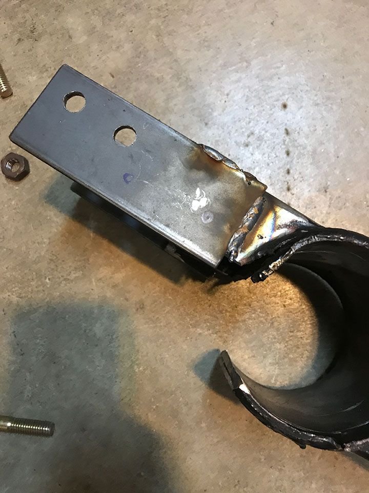

The end of this long story is that I know I want a Tremec 5 speed someday, so I wanted a removable crossmember. The floor of my ’63 was way too close to the crossmember to use the kit that they sell, and being so close I couldn’t cut it with the tools I had without a lot of trouble. So I cut it like shown in the pics and welded brackets on the center section and taped the crossmember for bolts. This allowed me to install the shifter back on the trans and put the whole thing back in all together. It went in sooo easy I had to smile.
