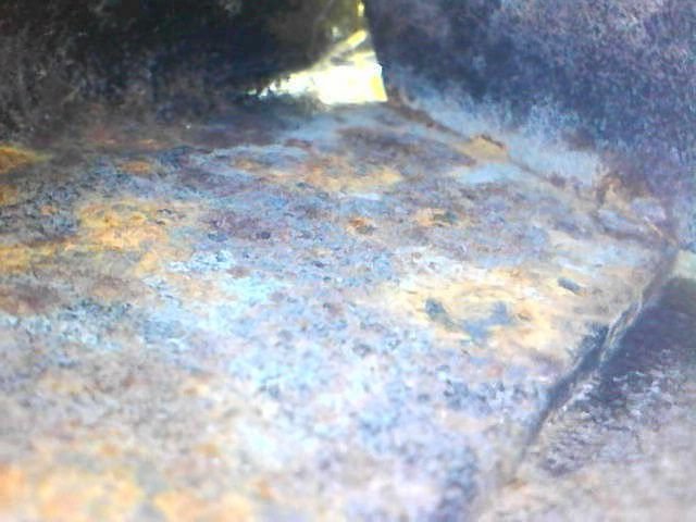

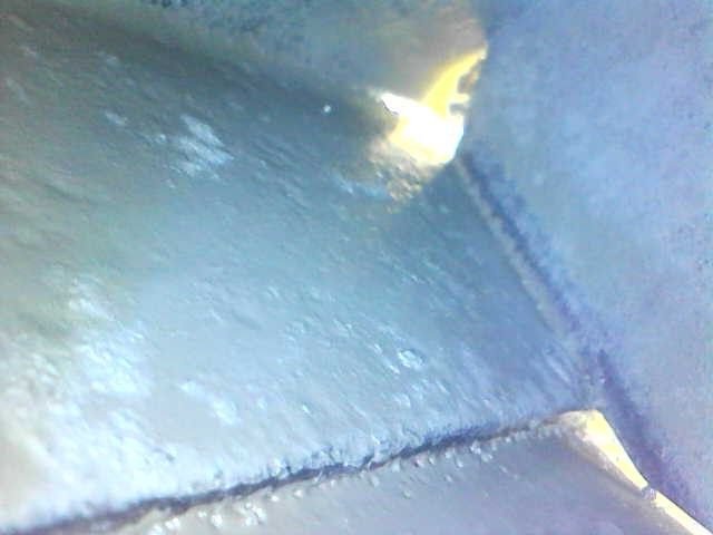

Some additional things to consider. Before and after you have the frame blasted use an inspection camera like the Aardvark for looking at the inside of frame. The Aardvark links to your smart phone or computer via wifi. Using the camera will take some practice to comprehend what you are seeing as there is no way to orient the image. You will want to remove all the rust scale and dirt/debris as you can. If you have rust scale you can use a needler or hit the frame repeatedly with a hammer to knock the scale loose. My project frame had been painted prior to me taking ownership and it took several hours using a hammer, water jet and air blasts to remove all the rust scale, small pebbles and sand that was in the rails and at the kickups.
Once you have the internals clean to your satisfaction, treat the inside of the frame cross members and frame rails with Eastwood's internal frame coating or something similar. I used the green as it is easier to see where it has been applied. I recommend you treat the internals before you paint the frame externally. You can do it after the frame has been painted but I can tell you it is a pain to tape off all the holes and seal all the seams with putty. Even then you will have some clean up with mineral spirits to do.
If you use the Eastwood product it will take at least 4 cans. I wound up using 6 cans. The product comes with a flexible plastic wand about 18 inches long. I recommend using the wand with a coat hanger wire taped to it for support. This will keep it from coiling backup and to better control where it is inside the frame. Application by the wand works better when the nozzle is not against one of the four sides of the frame rail.
If you really want to get carried away have the frame seams welded full length.
some before and after to give you an idea
tape off and permagum or dum dum putty applied to holes, seams and crevices
Before cleanup drivers side rear of frame at kickup
After cleanup, drivers side rear of frame at kickup
Eastwood frame coating applied drivers side rear of frame at kickup
