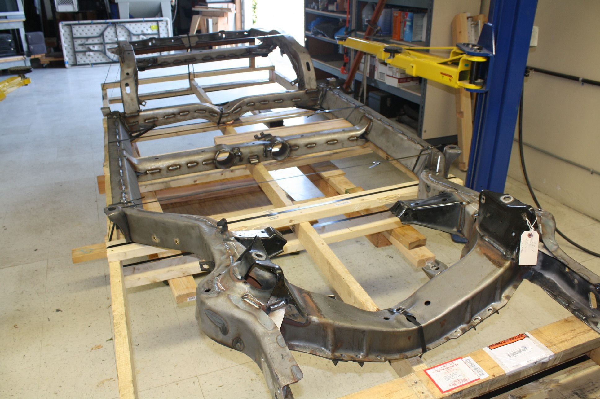

Just got off the phone with them Herm. Yep, no credit cards, send a check, get in line. They apparently have the original GM tooling and make to the drawings.
Going used, worrying what I have, AND going to inspect a used frame means my savings would be minimal. New only makes sense expect the car was planned to be in my son's wedding mid-Feb.... looks like that's dead now.
Good choice going new. Trying to save a few bucks on a 50+ year old frame is asking for trouble.

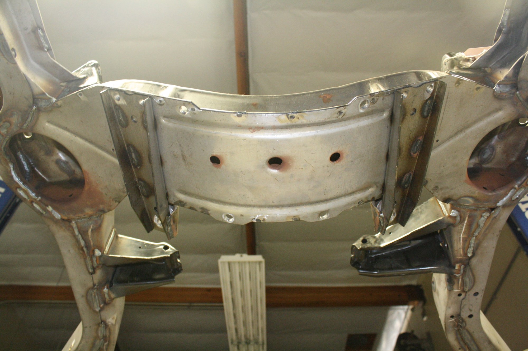

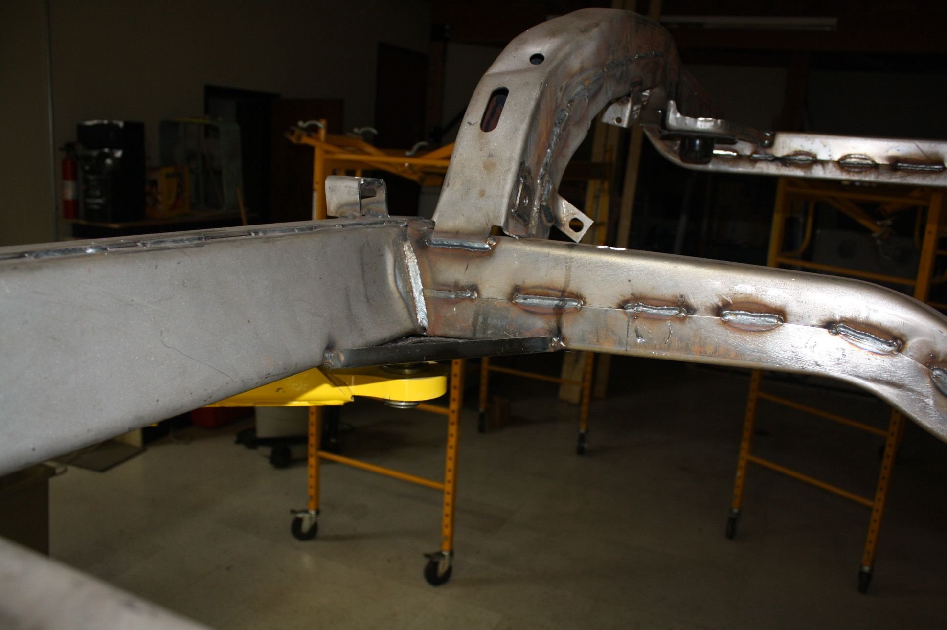

I've never seen a frame before bare and no paint. You can really see all the work, skill and metal that goes into one. I don't think 5600 is all that bad when you consider a paint job is 10K plus, rebuilt engine 6K, etc.

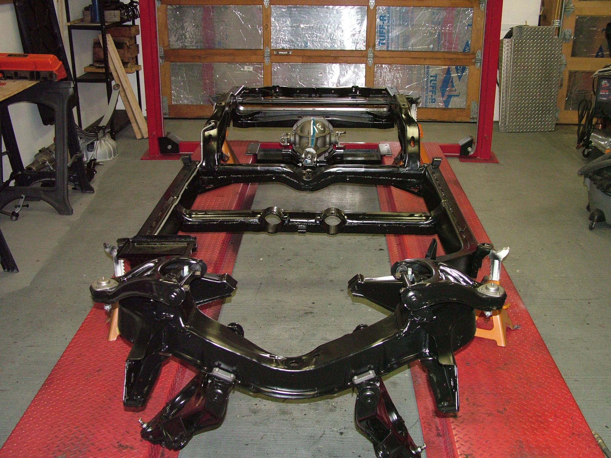

Just put a Vette Products frame on one of my 63s. Easy, everything fit. I'd recommend you have them put the removable trans crossmember on it. Much easier when you do it at that stage.
The new frame is well worth the extra money in peace of mind

Gotta admit - that is a good looking bit of fabrication....
If it were my car that's the route I would go...but I'd get paint or powder coat on it ASAP. Florida humidity is no friend to bare metal, Alabama prob isn't either

Yep, it'll be painted immediately. I've mentioned this here on the forum before. We design/manufacture military equipment that goes into very ugly environments and is not treated lovingly. We don't powder coat because it doesn't demonstrate the toughness of a properly prepped surface, epoxy primer, and decent paint, particularly after being chipped and used in the desert or ocean beaches. My experience is rust migrates under a powder coated finish much more aggressively than properly prepared epoxy primer. Don't know if the surface isn't prepared right, etc regarding the PC process. Being new to the hobby car community, powder coating something that will certainly see stone/road rash under a car like we see daily I don't understand. Maybe PC for show cars that rarely get used. Might just be our experience with improperly applied PC. Dunno.
Anyway Frankie, will be prepped, primed, painted immediately. Now need to decide about doing the inside with that POR stuff.
BTW, I spoke with Vette Products and what you're seeing is stamped frame parts made from the actual GM C2 tooling and original drawings. Pretty impressive fab job for about 5k.

Virtually nothing could convince me there is a better way than epoxy primer and paint for a Corvette frame. Mine was blasted and painted with DuPont epoxy products and it has proven bulletproof. I only wish the person that restored it had dipped it instead of sandblasting it, to address any internal rust that cannot be removed by blasting.
