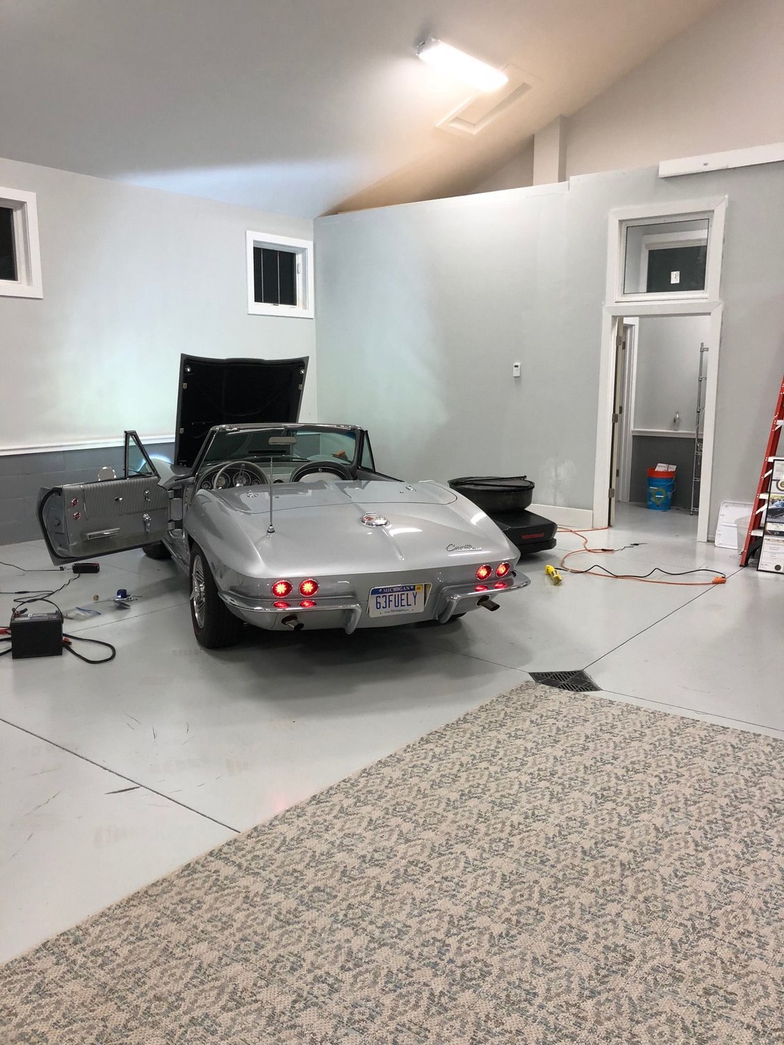

Well, I've finished converting my 63 to all LED exterior lighting. I love the result, the headlights are the "pony" lights discussed in an earlier thread. They are a vast improvement over both standard and halogen. The pic below shows the T3 lights in the blue car, compared to the LEDs in the silver car.
The next pics show the comparison to a normal bulb in appearance, the bright sockets have normal bulbs, the dims are LED
I've also installed LEDs in taillights and parking lights. The new LEDs are very much brighter. Note that installing both front and rear required a new flasher.
These changes make the car much more visible to other drivers when stopping and turning. The changes are very simple and I'd recommend them to everyone...
