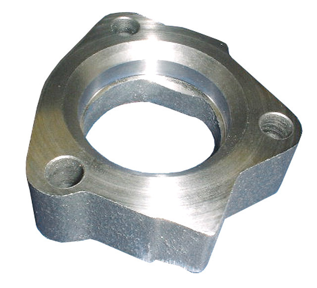

You can buy the heat riser spacers, available in 2" and 2.5" sizes.

I also used the 2.5 spacer and reamed it out to a full 2.5 round as it comes with flat spots on the inside or at least the one i purchased did. does it flow better maybe not but it made me feel good. LOL

the spacer is just the original casting that is not drilled for the shaft and flapper
FWIW, when I had new exhaust pipes fabricated I just eliminated the spacer altogether as my exhaust manifolds were already beveled for the packing biscuit. (I used the heavy duty truck cast iron metal biscuit rather than the soft one)
