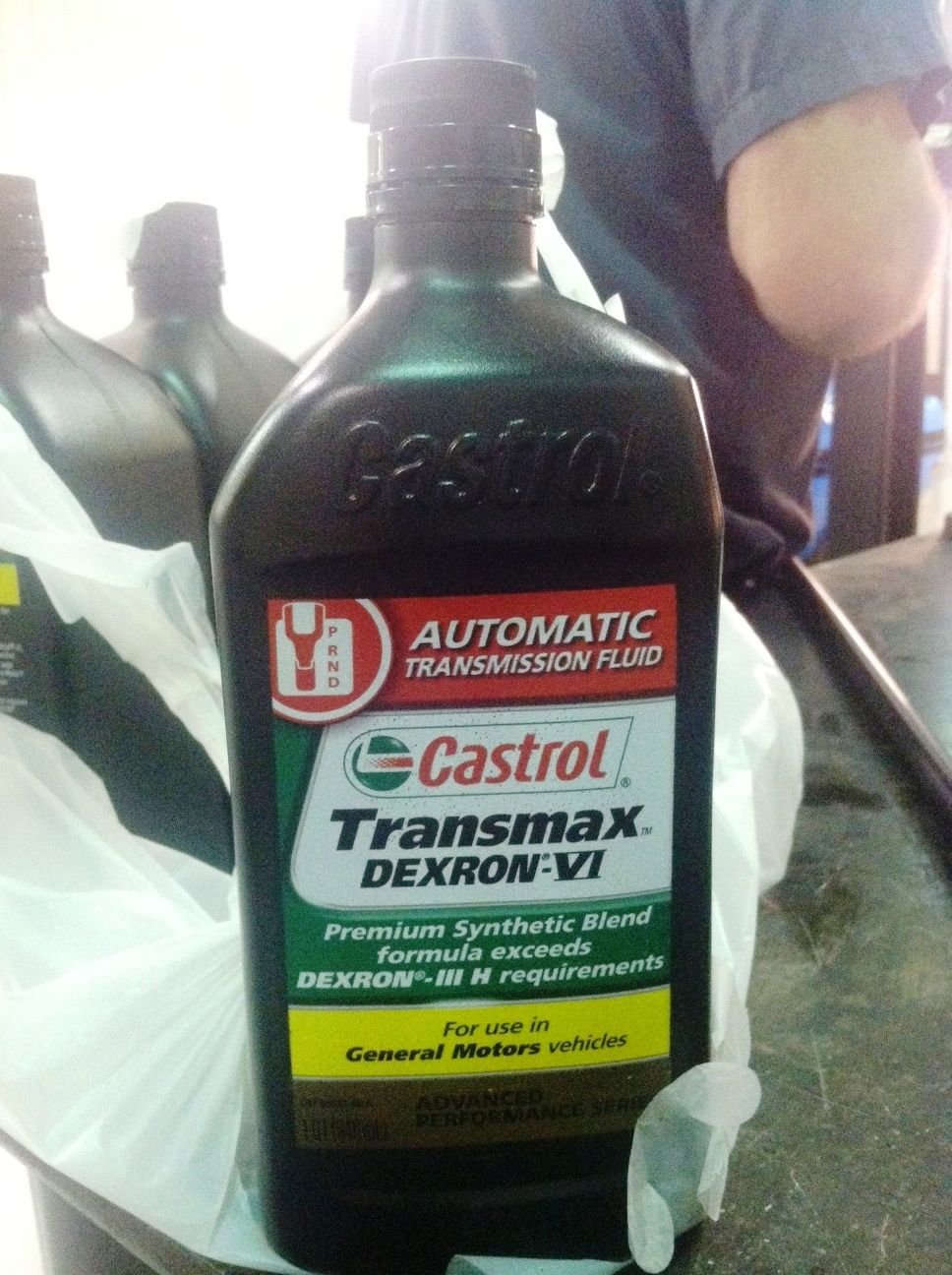

I STAND CORRECTED ON ALL OF WHAT I USED. (I HATE GETTING OLD!!). Disregard the pics of DEXTRON VI I posted here. Further examining my files on what I ended up using for my initial change at 1,000 miles AND what I used last summer IS MOBIL 1 ATF!
Here's a copy of correspondence I had with John Czahoroski, Tech Support at Keisler on April 26, 2013 (I returned/did not use all the DEXTRON VI I had purchased):
----- Original Message -----
From: John Czahoroski
To: 'Jim'
Sent: Friday, April 26, 2013 10:03 AM
Subject: RE: Your Speedo Gear Request
Hi Jim,
I talked to Dick McCord this morning, the engineer that designed the SS700, and he stated that the information that is in the instruction manual you received yesterday is correct. His official recommendation for a synthetic fluid is Mobil 1 Multi-Vehicle ATF. It is available at most auto parts stores like AutoZone, Advance, etc. I did make Shafi Keisler aware of the potential confusion with Mobil 1 and Dexron VI.
Regarding the Dexron VI, while Mr. McCord hasn't performed any tests to negate its use, he can only recommend what has been tested. In fact, since both fluids are premium synthetics, there are probably only insignificant differences in formulation or viscosity.
Hope this clears things up.
Thank you!
John Czahoroski
Customer Service / Tech Support / Sales
Keisler Engineering, Inc.
2250 Stock Creek Blvd.
Rockford, TN 37853
865-609-8187, ext 211
john.czahoroski@keislerauto.com
So, disregard all these pretty pics below of DEXTRON VI! I apologize for the initial misinformation!
THIS IS WHAT I'VE BEEN USING:
FORGET ABOUT DEXTRON VI!
I've had no issues with the DEXTRON VI ATF. So, last summer I just drained and replaced with DEXTRON VI.
My initial change @1,000 miles.
What I replaced after 13,000 miles last summer.
Jim
In God We Trust!
Last edited by 6T5RUSH; Feb 10, 2018 at 05:56 PM. Reason: CORRECTION...WRONG INFO!
