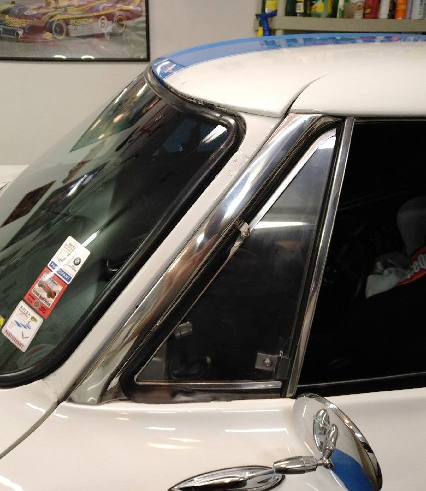

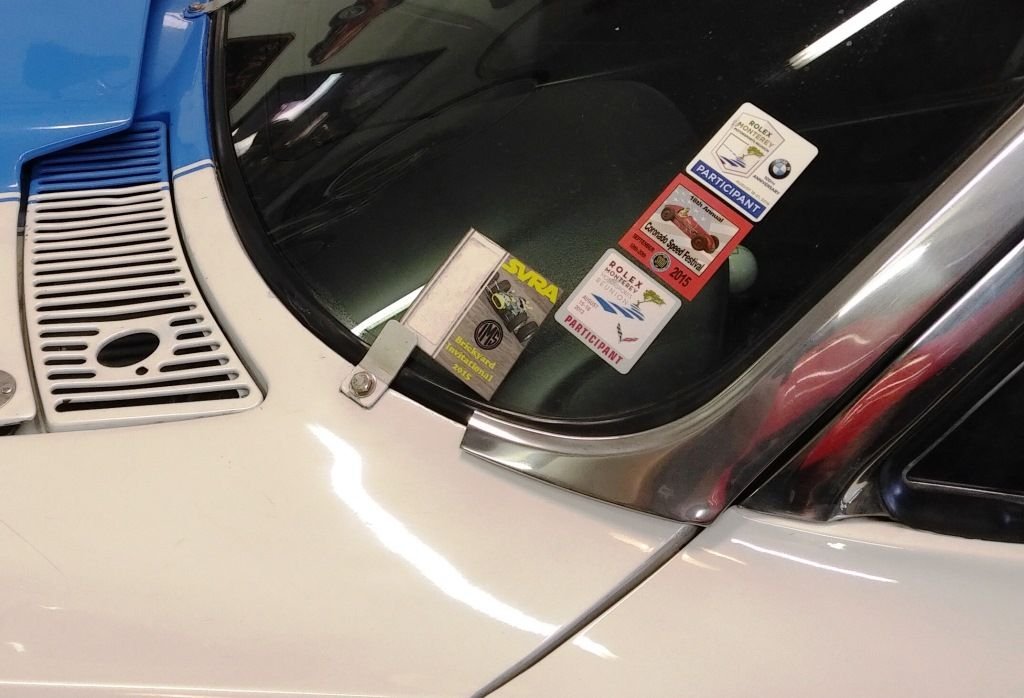

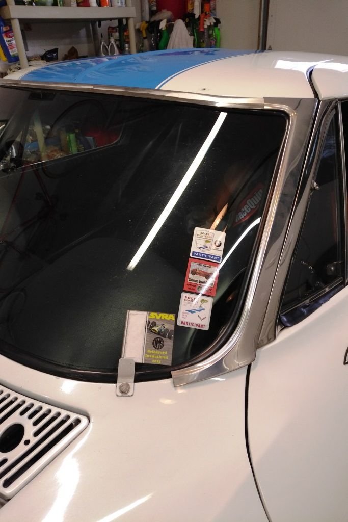

I got my car from storage today and first thing was to try the new upper trim piece. The top fit great but any thoughts on the bottom? The A pillar piece lines up perfectly with the original holes to mount it but I do not have a bottom piece of trim yet. Looks like the lower channel has been glassed to small for the lower trim to sit flush??
Thanks for any thoughts,
Steve

The lower portion of my side piece looks like it sits in the same place on the rubber as yours.

Interesting, thanks.

Can you post a picture of your driver side door trim at the top with the door completely shut. It appears as though your side trim is too low. The factory had that trim piece about a quarter of an inch higher at the top on the windshield side. Not matching the stainless on the door.

It is actually high but the door lines up pretty well to the top of the car...it's an old car is my take but could use some adjustment. Until I get the lower trim for the windshield I guess I will not know if the lower channel is wrong. On my list. Thanks!
Steve
