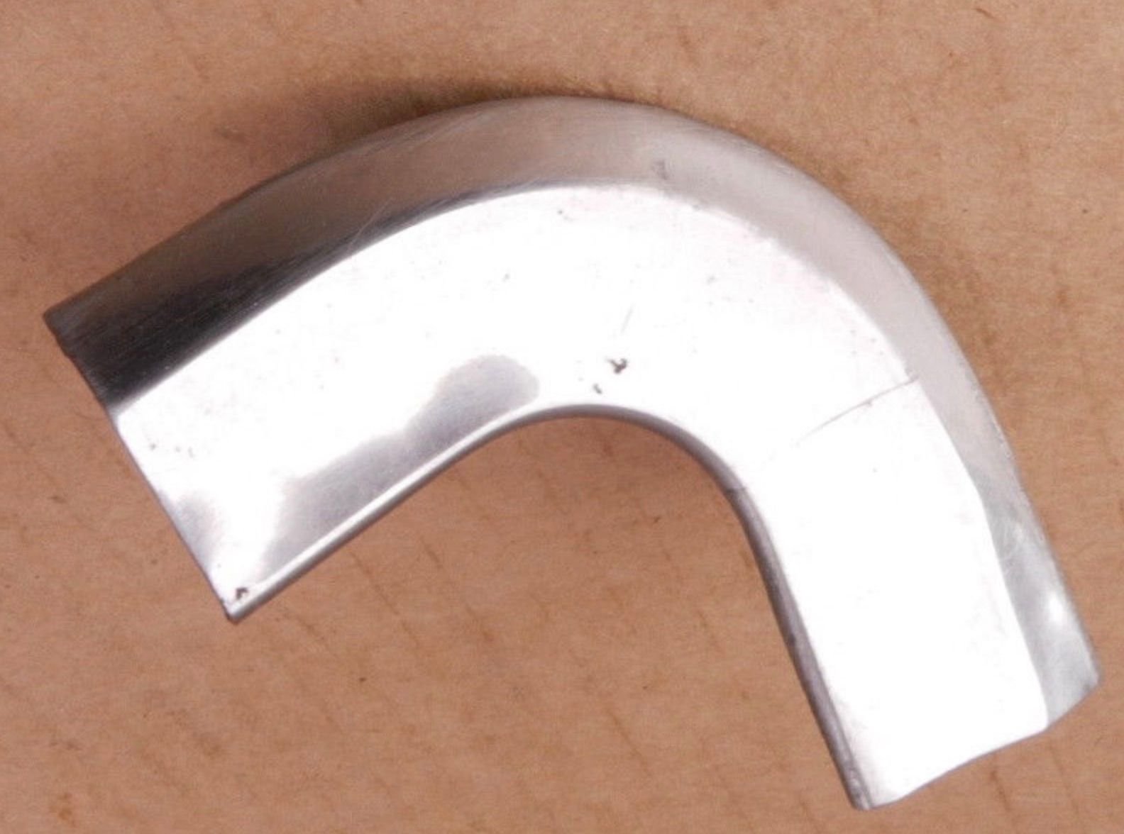

To ‘63 upper windshield molding?
Old Feb 2, 2019 | 11:26 AM
Ken Sungela's Avatar
Ken Sungela
Joined: Sep 2012
Posts: 2,407
Likes: 809
From: Justin, Tx
Here is an original 63 coupe side windshield molding with a 64-67 lower windshield reveal molding from CSofMDwest. They look to fit pretty well together. CSof MDwest said I just need to use the 64-67 clips on the lower molding. I have the clips and will be doing a test fit soon.
