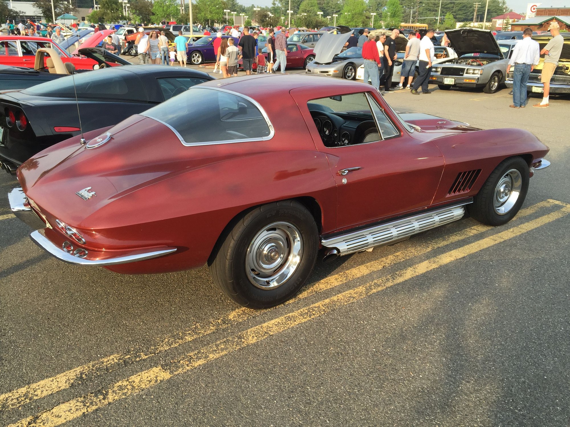

I'm running 255/60R15 drag radials on 7" Rally wheels in rear, and 2250/60R15 on 6" Rallys on the front. No flares. Its tight and I had to mildly trim the inside lip in the rear for clearance.
Like others have mentioned, I think your current wheel/tire combination looks great.
