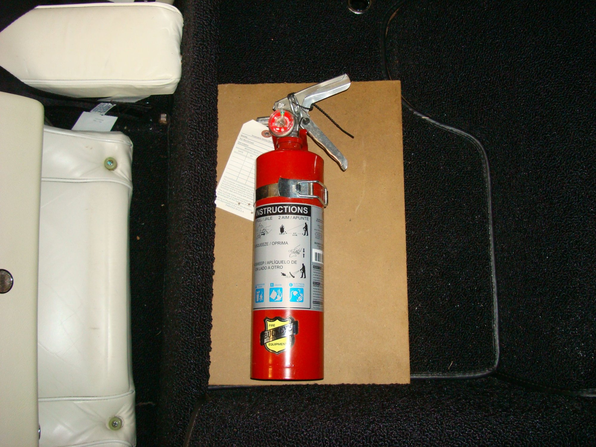

I cut a thin piece of fiberboard and mounted the extinguisher to it. It sets behind the drivers seat and doesn't move around.
